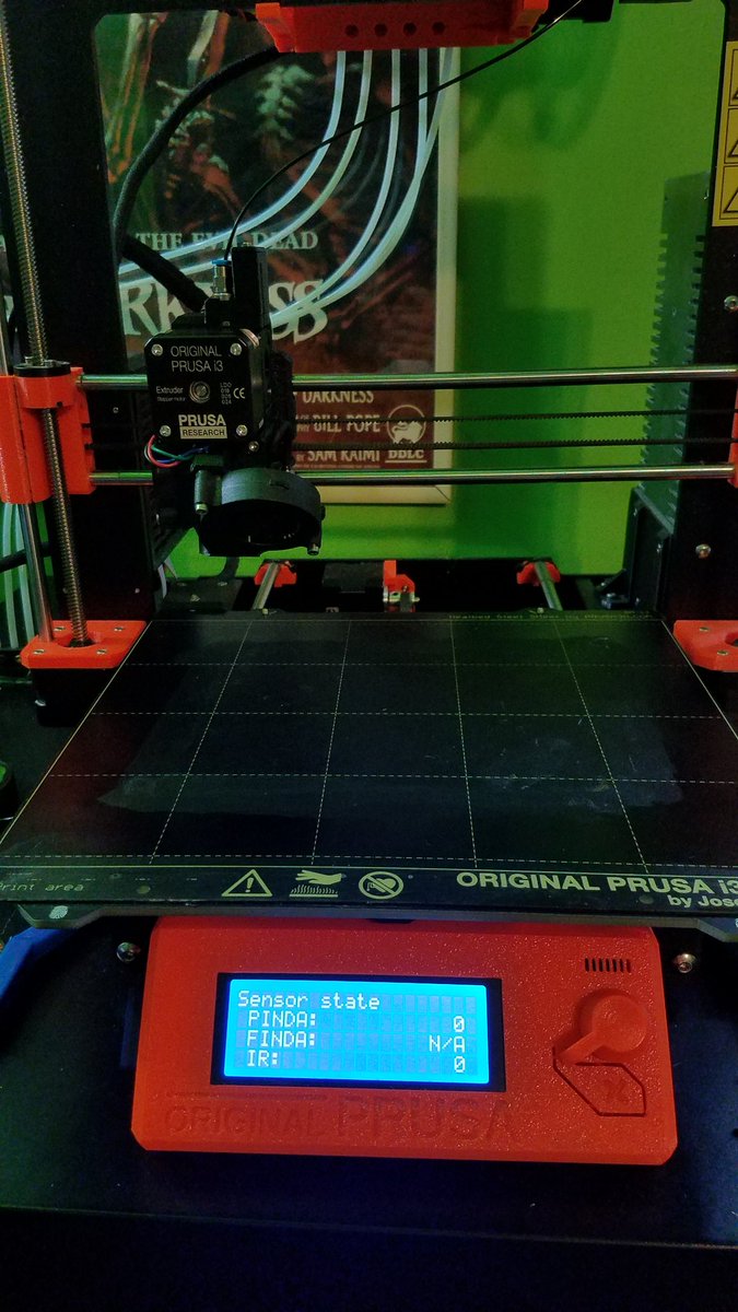

Ok, bypassed the mmu and I'm able to load/print TPU with the mk3s hardware.
Here's an image:
Loaded TPU
Notice that the filament is loaded. I could upload video of the printer printing as well, but note that the IR sensor is showing "0" which means it is not detecting the filament.
Here's a second image showing the hex key IR calibration:
IR sensor is working
Note that it is showing that something is present.
So this issue is with the "upgraded" (and I call it an upgrade in the most loose sense) IR sensor. I'll run the single print color using the mk3s hardware only so at least I can get my objects printed. I will contact Prusa to see if they have a solution for this issue.
Please, if anyone has figured out how to get TPU/soft FLEX to trigger the IR sensor on the mk3s, let me know. If anyone has had a successful TPU load and print using the mk3s/mmu2s combo, please let me know how. If I hear anything from Prusa on how to get this working, I'll post it here.

@john-h76 for your IR issues, 0 is what you want it to show when filament is present. It's backwards from what you would think given the purpose.
How big of a hex key did you use to calibrate? If it is not roughly the size of filament then it might not trip the sensor.
Since you hadn't been printing with the MK3S yet, I'd suggest falling back to just printing with PLA to start right now. Get it reliably printing with the IR sensor enabled, then try the TPU.
Take a look at my other posts (sorry, on my phone right now) for my comments about the idler door and IR sensor and see if any of that applies/helps.
MMU tips and troubleshooting
Posted : 29/05/2019 10:58 am
Roy
 Roy
(@roy)
RE: Can anyone get the mk3s/mmu2s combo to successfully load soft TPU?
Sorry, but this is not right.
The IR sensor value goes to 1 if it got triggered by filament sitting between the two bondtech gears.
You can even try to trigger it by the use of some PLA filament instead of the hex key.
I would guess, in this case the spring loaded screw for the bondtech gear is just too tight for TPU. Loosen it a bit as mentioned by toaf.
Trying without MMU could help at least to find the right adjustment for the screw.
Posted : 29/05/2019 12:37 pm

@kieran.s4 Well said. The IR sensor is the center of the problem with the MMU. It's inconsistent and nearly impossible to get a working calibration for multiple materials. Hell, I can get a proper TPU load about 50% of the times with the same filament. I highly doubt there's a huge inconsistency with the filament width, as I had been printing flawlessly with them using the mk3.
To add to the issue with using the idler to detect the filament, I ran into an issue with the IR sensor moving slightly because of the m2 screw on top of the IR chimney not being tightened enough. The wires would move slightly as the extruder head moved and when it came time to unload and then reload, the sensor was already out of calibration.
And for final clarity, the IR sensor shows 1 when filament is present and 0 when there is no filament. If you load filament to the mmu but the filament never makes it to the extruder and you get the "Is the filament the correct color" message on the led screen but there is no filament in the hotend, your IR sensor is likely showing a false positive (1) and you need it to read 0.
