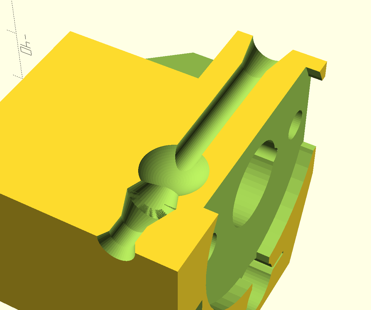

I made new parts (scad) to fit the knife - blade more precise and replaced that part. I used lockpicks to remove the nuts. Maybe that would work to remove the bearing?
(I will upload the patched blade holder later.)

there a few variations on thinigverse
this one is pretty neat using pegs
https://www.thingiverse.com/thing:3157550

Yep, that's pretty much what I did, although I cut them so they had more surface against the knife, and also added holes so you can peek in and confirm the position of the blade.
https://www.thingiverse.com/thing:3232000

I haven't had any issues with the filament path. I made it larger on the blade holder part so misalignment wouldn't be an issue.

Now I've had issues with the filament path, namely the PFTE transition at the filement sensor in the extruder part. But not in the MMU2...
yes that was the area i needed to reshape with the file. the resolution that the body was printed at(rough) makes steps in the taper going to the pulley. the tip of the filament hits it then it skips steps or it strips out on the upper pulley. in this situation the filament sensor would see filament but it would still never reach the nozzle.
this was the area i said to focus on and twist the filament around in different positions so that the curl of the filament would constantly change as you manually pushed on it so you could spot an area that need to be sanded down smooth.

if there was no filament sensor then the small PTFE tube could be extended right down to the entrance to the pulley and avoid the problem area.
Currently the filament sensor isn't used, I don't know if it's planned to be used. I might get a passthrough connector and remove the filament sensor.
I spotted an odd thing in the FINDA filament path of the MMU2:
That little extension after (!) the FINDA tube? That looks like it was supposed to be in the FINDA tube.

are you taking about the tube under where the ball sits? that acts as a drain if some junk gets in there, but usually it gets full of strings and clogs up.
they do plan to use the sensor in the future but again that sensor causes a lot of issues and they disabled it for now. there are firmware branches were it is enabled and i think on the last firmware 3.5.0 they did turn its function back on.

It's not much of a drain if it's a closed space... :p
