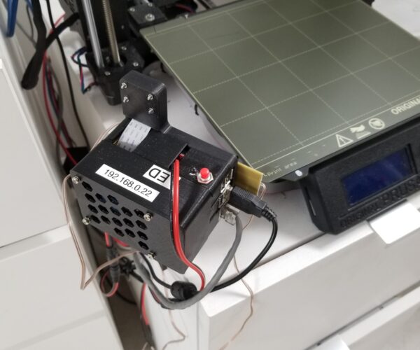

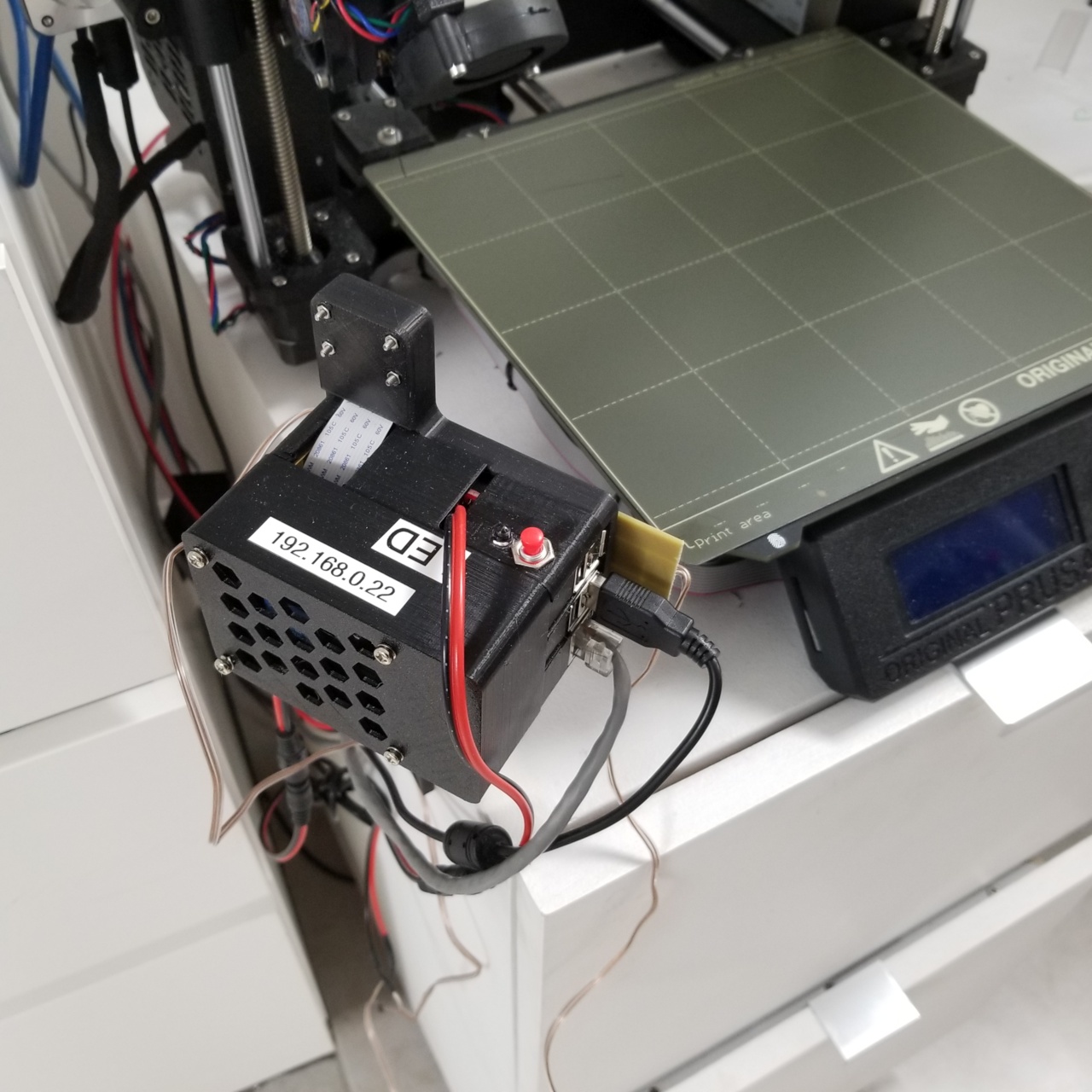

I used the Prusa /S power supply to run my Octoprint Pi, and since it is marginal for the printer, I was getting snapping noises from the original power supply.
So I purchased a Meanwell 600W power supply, replaced the internal fan (because the internal fan is really noisy), and mounted it on the printer.  Since the power supply does not have an internal switch, I printed a switch box with fuse to house a line-voltage switch to turn on and off the power supply.  I needed to make a mounting tray for the bottom of the power supply and a single 3mm screw to hold the power supply
to the frame.
Not being content, I wanted some way to shut down the printer when Octoprint shuts down, so I put a latching relay in the power supply switch box and build a hat for the Pi that contains 2 relays (one for lights, and one for the timer) and some electronics that will turn off the power supply 15 seconds after the Pi shuts down.  The project was fairly complex, but it works fine.  Besides the electronics, there are two LED panels on the front of the Pi box to light up (using the Enclosure plugin).  I added a push button and led to let me know when Octoprint is running and to manually shut it down (using the GPIO plugin), and a timer to shut down the power supply 15 seconds after Octoprint shuts down.  The Automatic Shutdown plugin lets me shut down the Pi after a print job is finished, which also shuts down the power supply.
Since the project was fairly complex, I don't want to post all of the details here.  If there is enough interest, I can post some of the details, but the construction of the Pi hat and associated electronics require electronics knowledge and soldering.  The switchbox on the power supply also required some wiring and soldering knowledge as well.  I used parts I had on hand as well as purchasing some.  I am an electrical engineer, so designing this stuff is straightforward for me.  I also had to modify the GPIO plugin to shut down the power supply properly.
I chose not to run the Pi off it's own power supply because I don't like to leave electronics running when not in use.
If people want more detail on what I did, please reply to this post.  I have no idea on this forum where to post this info.  Unless the builder is VERY familiar with 120V wiring, building the switchbox could be hazardous.  All the printed parts (including the Octoprint case) were made from PETG.
