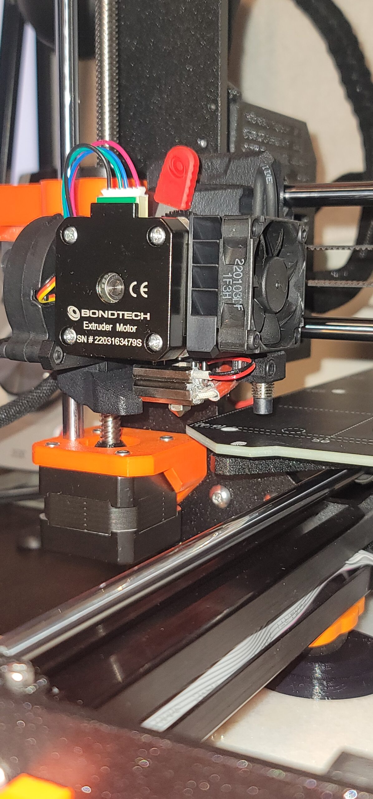

Hello,
I recenly upgraded to the LGX and installed the FW from here successfully:
(If you are using stock or Slice’s 300C thermistor and EINSy10A board)
https://www.bondtech.se/product/bondtech-lgx-shortcut-mosquito-for-prusa-mk3s/#tab-firmware
During the calibration wizard, i notice the nozzle is moving off the front left of the bed when doing the circles until it ultimately catches the paper and i have to power off. You can see the nozzle clearly off the bed in the pic. How can i correct this please?
I think i need to tweek the pinda probe a bit more. I measured 1.5mm from the bed while nozzle touching bed.

RE: MK3S LGX Shortcut Mosquito / XYZ cal moves nozzle off the bed
Something is off.  Mine does not do that.  Although mine is the Standard Bondtech with Mosquito.
I think that you mounted incorrectly the Mosquito.
See below Bondtech tutorial video on youtube. The wires of thermistor/heatblock must be paralel to the hotend fan and in your photo they're rotated 90º
So I noticed this in the video as well but the hotend adaptor that was given only goes on one way and I can't unscrew it to rotate it.

If you purchased the LGX directly from Bondtech,  perhaps you should contact them and explain the situation. Either they sent you a wrong hotend adaptor or possibly you're missing something.
I just emailed them about it 30 mins ago and will follow up once i get a reply.
Ok so this may be normal for the mosquitto version. See this note on the second video featuring the instructions for shortcut copperhead
"Video shows a LGX Shortcut Copperhead.When using the LGX Shortcut Mosquito, insert the heater and thermistor from the left hand side (while facing the LGX front)."
