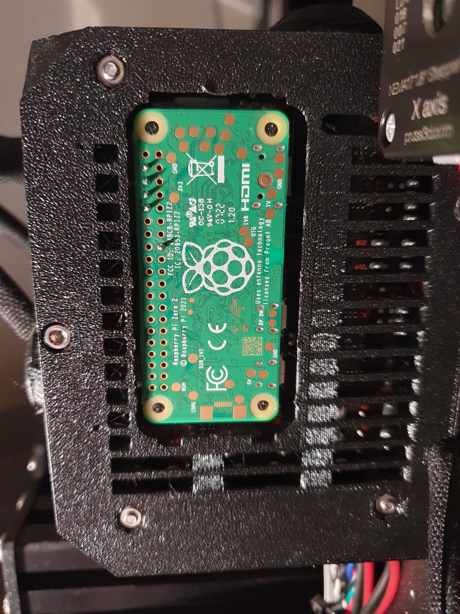

I'm trying to setup a Pi Zero 2w on my MK3 with no success.
When I plug the Pi Zero in, and turn on the printer, the menu freezes and the screen shows scrolling squares and it then shows a full screen of squares.
Does anyone know what's happening ?
The connections on the Pi look fine, and I can boot the Pi externally while connected to a screen.

MichaelK
(@michaelk)
RE: MK3 and Pi Zero2W
This is how the Pi Zero2W is attached.
It's the usual way.
Posted : 30/10/2023 2:23 am
Hello
(@hello)
Posted by: @michaelk
It's the usual way.
Thats connected fine I presume you have already reflashed sd card. Did you do it through the pi imager

MichaelK
(@michaelk)
I flashed the OctoPi image file using the pi imager.
I might try the old Prusa version and see what happens.
Posted : 30/10/2023 3:02 am

MichaelK
(@michaelk)
Flashed prusalink.
Plugged in the pi.
The printer didn't complain, and I can change settings.
So it looks like it was Octoprint.
I'll try re flashing a clean install and see how that goes.

MichaelK
(@michaelk)
Re flashed a new Octoprint image, and it's working now.
