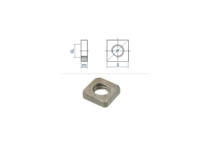

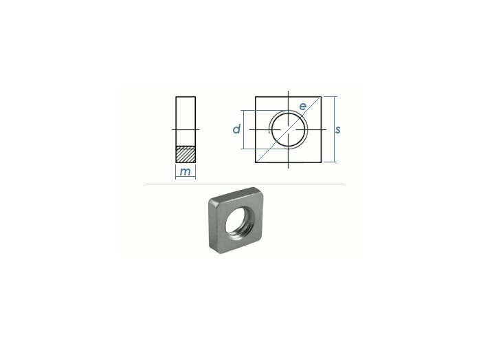

Search for "DIN 562 M3 A2". Another possibility is to use threadinserts like this one -> https://www.bondtech.se/en/product/thread-inserts/

DIN 563 M3 A2 stainless steel - €2.20 for 100 pieces
DIN 562 M3 FKL4 steel zinc plated - € 0.86 for 100 pieces
Of course you can also use galvanized or blank steel, everyone has to decide for himself.
Stainless steel is durable, corrosion resistant, temperature resistant, weldable, low maintenance, hygienic, etc.
As far as I know, Prusa only uses stainless steel fasteners and of course purchases the huge quantities at much lower prices.
