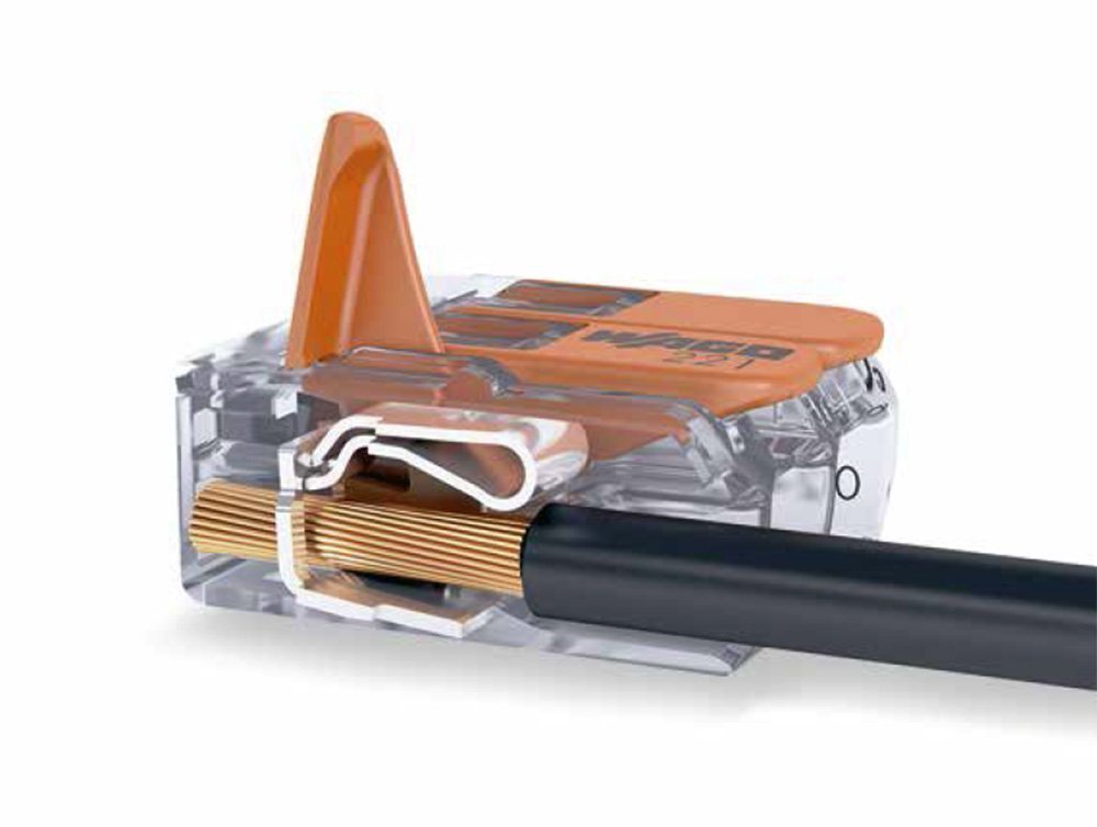

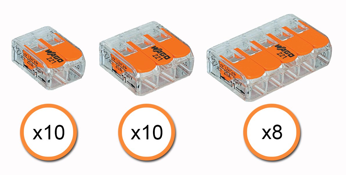

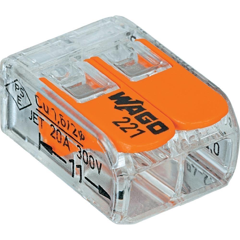

I found these quite useful when I was rewiring my Rostock Max delta printer but thet do use more space with both wires on the same size
https://smile.amazon.com/dp/B06XH6WW4D/ref=sspa_dk_detail_4?psc=1&pd_rd_i=B06XH6WW4D&pd_rd_w=boF3G&pf_rd_p=80559f3c-f83b-49c1-8a72-40f936e9df7a&pd_rd_wg=fjVSh&pf_rd_r=R9W0Y3BE06CDHK3188NM&pd_rd_r=506620e9-4f7c-11e9-b675-2fd27c5d8693
I actually used this assortment pack as I had some cases where 3 and 4 and 5 wires needed to me joined together, not just 2; the space on the bottom of the larger ones are very useful for labeling what is going on
