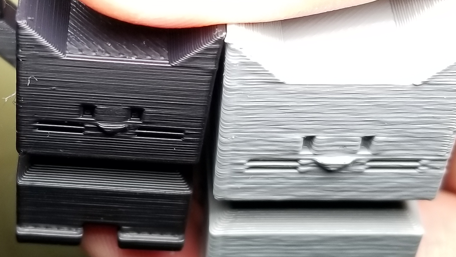

I'll come right out and post the results first: the classic 602 "basket weave" inconsistencies are gone (for me)
...I was staggered to see these results but this pic speaks for itself. (left is bondtech obviously, right is mostly stock) Now to be fair there are a lot of other things wrong with the older print, they're not the same brand of pla, and it was done without many of the other mods we've come up with since.

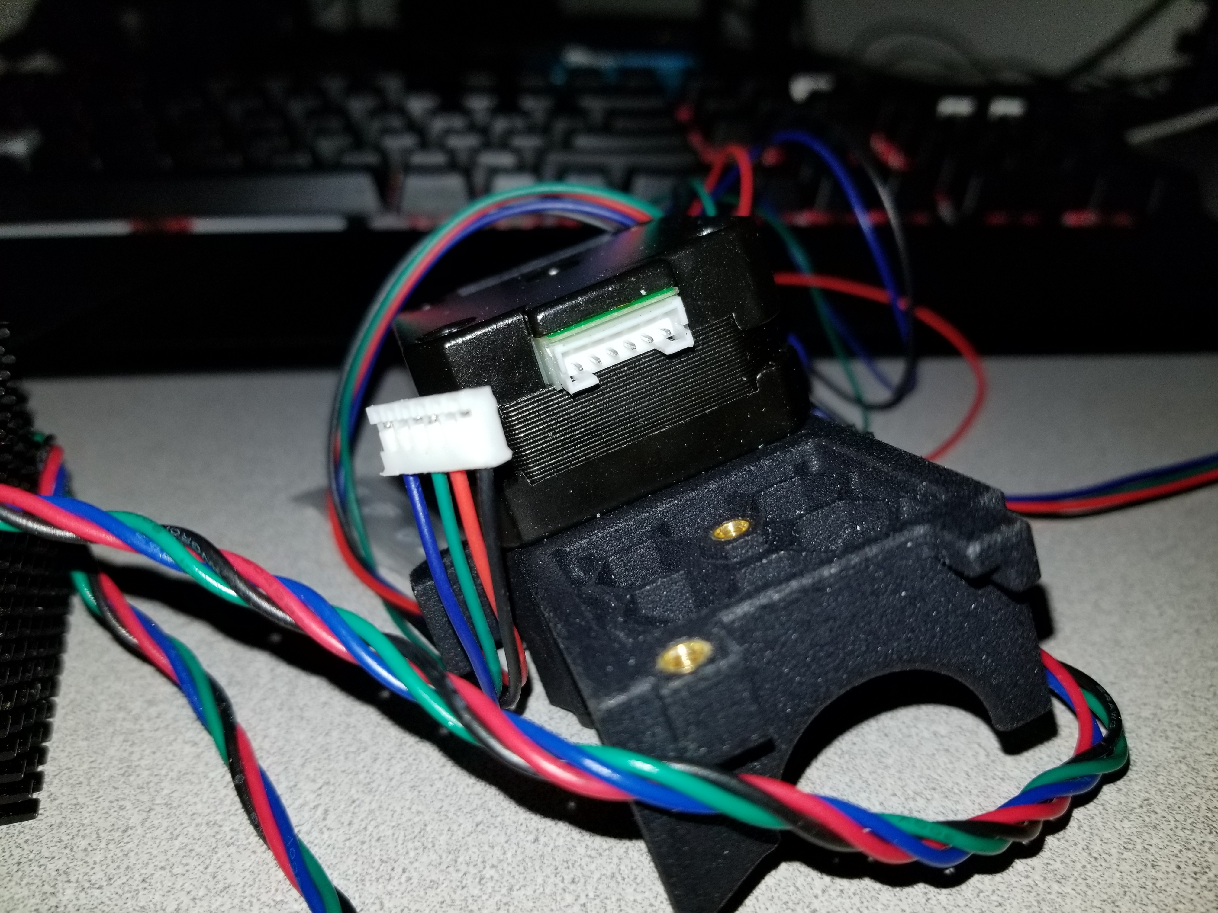

The extruder itself is gorgeous and the quality is essentially perfect (printed in SLS nylon)
I ordered the mk2/s version, which is actually the exact same parts plus a new set of gears for 10$ more. I printed the Bear carriage+backplates in 3dxtech glass-fiber filled petg.
All hardware and fasteners are included, no need to go digging square nuts out of your old extruder. Molex adapter for the motor and a new 45 degree fan shroud also included. Instructions are sufficient but if you've built the kit then you'll be fine.
Fun fact: the entire assembly weighs less than the stock motor alone

Thanks for sharing your experience. 25 mm/s max speed would be a no-go for me.
Your black cat looks over extruded. White cat was sliced differently (you can see it on the seam), is using different color/filament and most likely was printed with different speed settings. Comparing this prints is kind of not possible.
I'm glad you found the right settings and right upgrade for you. And I know there is another magic motor/extruder/printer part which solve "#602 issue TM". This is how third party manufacturer making money. 😉
that has nothing at all to do with 602. I'm not comparing anything else.
retracts, not max speed. i run them at 45 normally but haven't noticed any detrimental effect so far.
This is exactly my point. I miss a one to one comparison. Same gcode, same filament. Original extruder vs bondtech.
Sorry missed that. My default is 35 mm/s. Faster is usually better, with 25 you might get heat creep but bondtech has better cooling, so maybe it leverage itself.
Just in case someone gets an impression the white cat is the usual result you will get with the original extruder.
Here is my print from unmodified MK3:
If being 1 or 2% over-extruded and changing a seam position was all it took to either cause or completely eliminate 602 then we wouldn't be here now. CRTs video series is as scientific as you could reasonably get here and people still complained :/
These are my own results using imperfect models with many modifications and variables being introduced in the interim, all of which I acknowledge in the first post.
