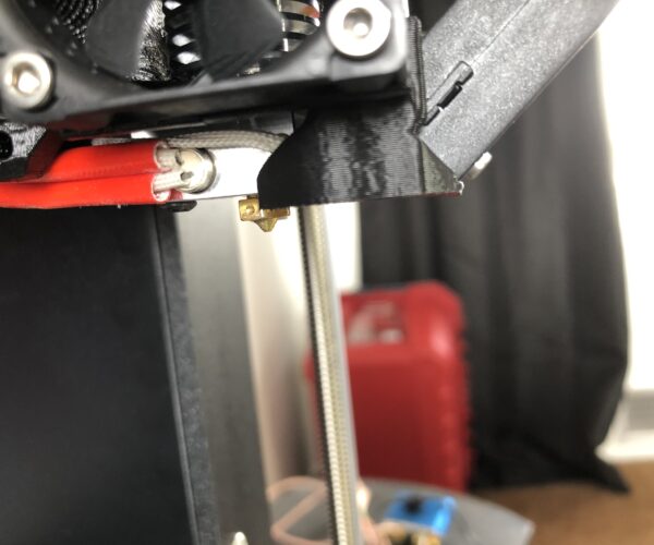

If the printer was assembled correctly then shouldn't the test prints coming from the SD card come out near perfect?  I have done 3 test prints after building my machine.  I am using the spool that came with the kit.  It was sealed in its package and has been opened for two days. It is not wet.
The Pursa logo came out fine.  The tree frog comes out stringy. I loosened the tension on the feed gear and got no results.  I did live chat and we double checked the nozzle, the gear alignment, and the fan.  I realize that I can go in and adjust the print temperature and retraction but I thought that the benchmarks were in place to be able to test the printer and see if things are working correctly.
Have I got unrealistic expectations about this?

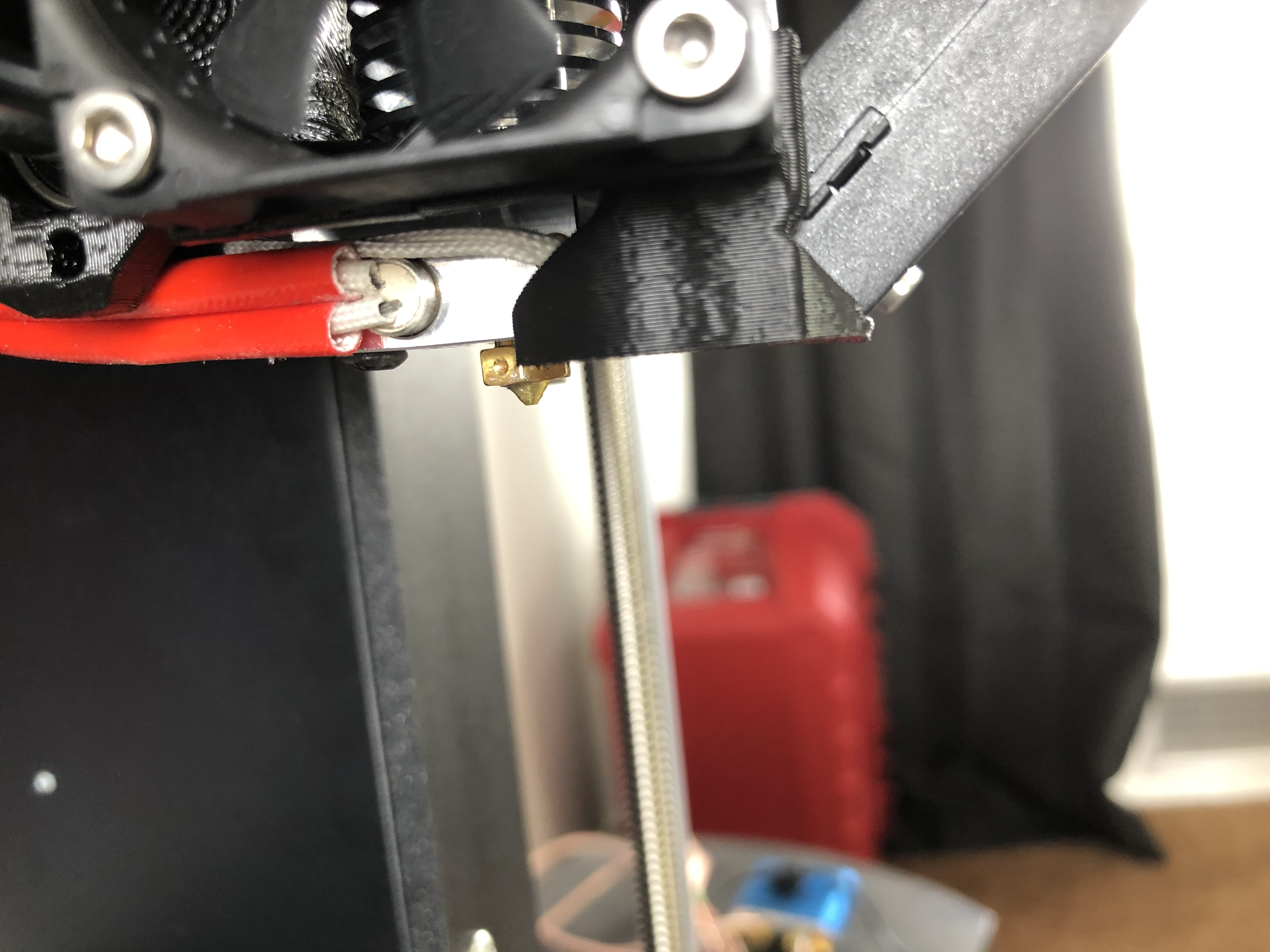

actually wondering if my fan shroud sits too high
With the fan there isn't a lot of room for adjustment or alignment.  I am actually wondering if my fan shroud sits too high.
I can get rid of the strings by turning down the default temp.  I am use to bunches of workarounds from owning a Maker Select v2.
Right now my Monoprice Maker Select is putting out way cleaner stuff but I had to do hours of mods and lay out lots of time and filament to figure out the best settings.  I just had hopes that I could print some good looking objects on this printer with their pre-sliced Gcode and that I would not have to tweak settings or mod parts.  If I built the kit correctly then shouldn't the printer be awesome right out of the box?

Until you've tried another spool of filament to eliminate the possibility of issues, I wouldn't be overly concerned. Yes, the default gcode samples with the sample spool should print very nicely. You can look around here and in other 3D printing forums to find hundreds of examples. Trust me, you aren't the first to discover some dark secret defect. If you're having issues on a kit build, you may have to spend a bit of time adjusting it but I think you'll find that once built & tuned correctly, very little ongoing tweaking is required.
The samples aren't exactly perfect themselves. Try slicing the same parts with your slicer settings and compare. You can expect to do a bit of tuning when you switch filament manufacturers and types due to physical variations, but that takes minutes.
As far as the shroud alignment, monitor the hotend temp when the print gets above layer 1 (fan 0) to higher layers and see if there's a significant temp swing. If so, check to make sure the shroud is pushed firmly up against the fan. A silicone sock can also help with temp regulation.

Certainly your shroud looked higher than what mine was.
