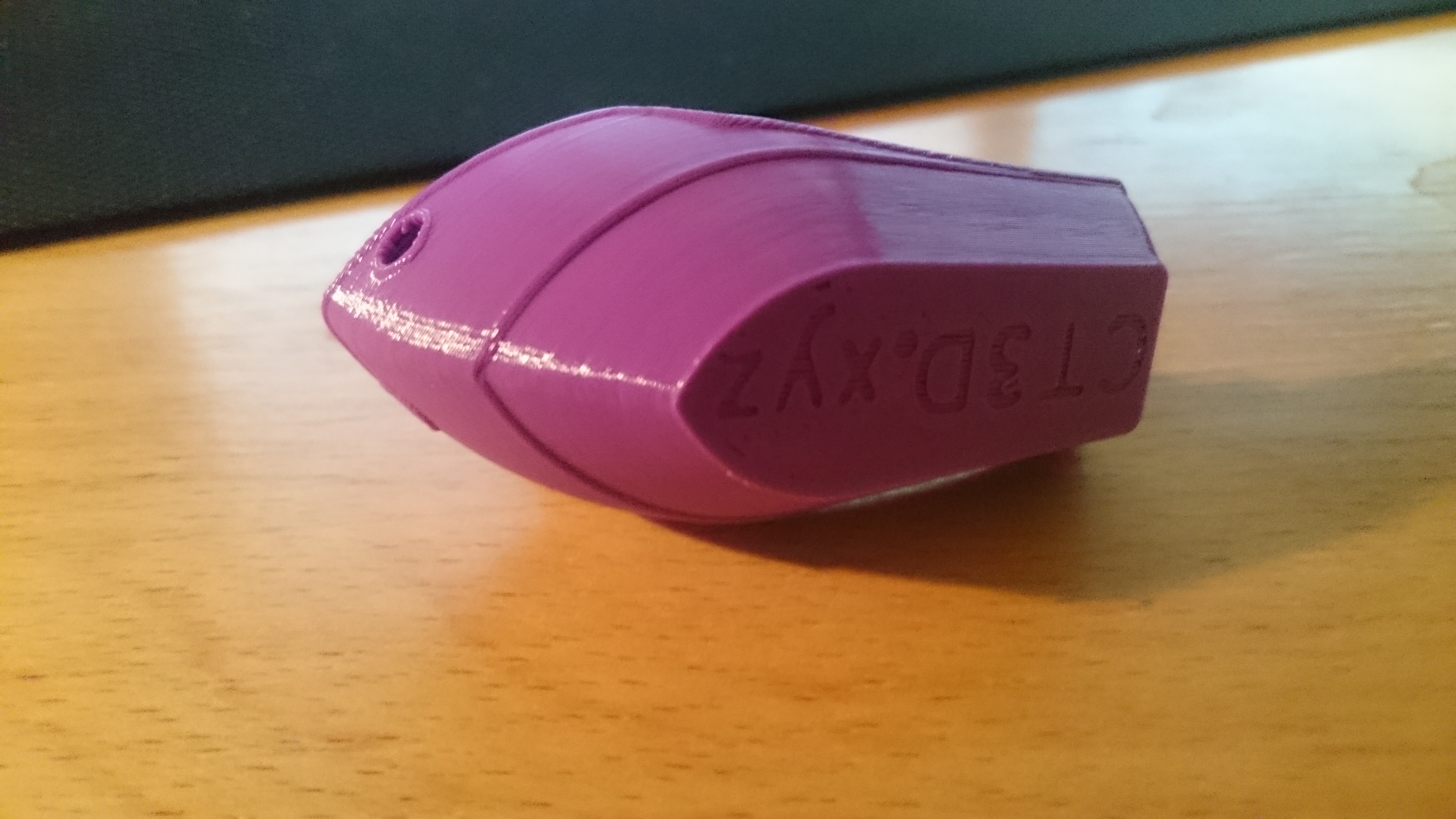

thanks for looking at this - maybe you´ve got an idea why my 3dbenchy´s have this strange error.

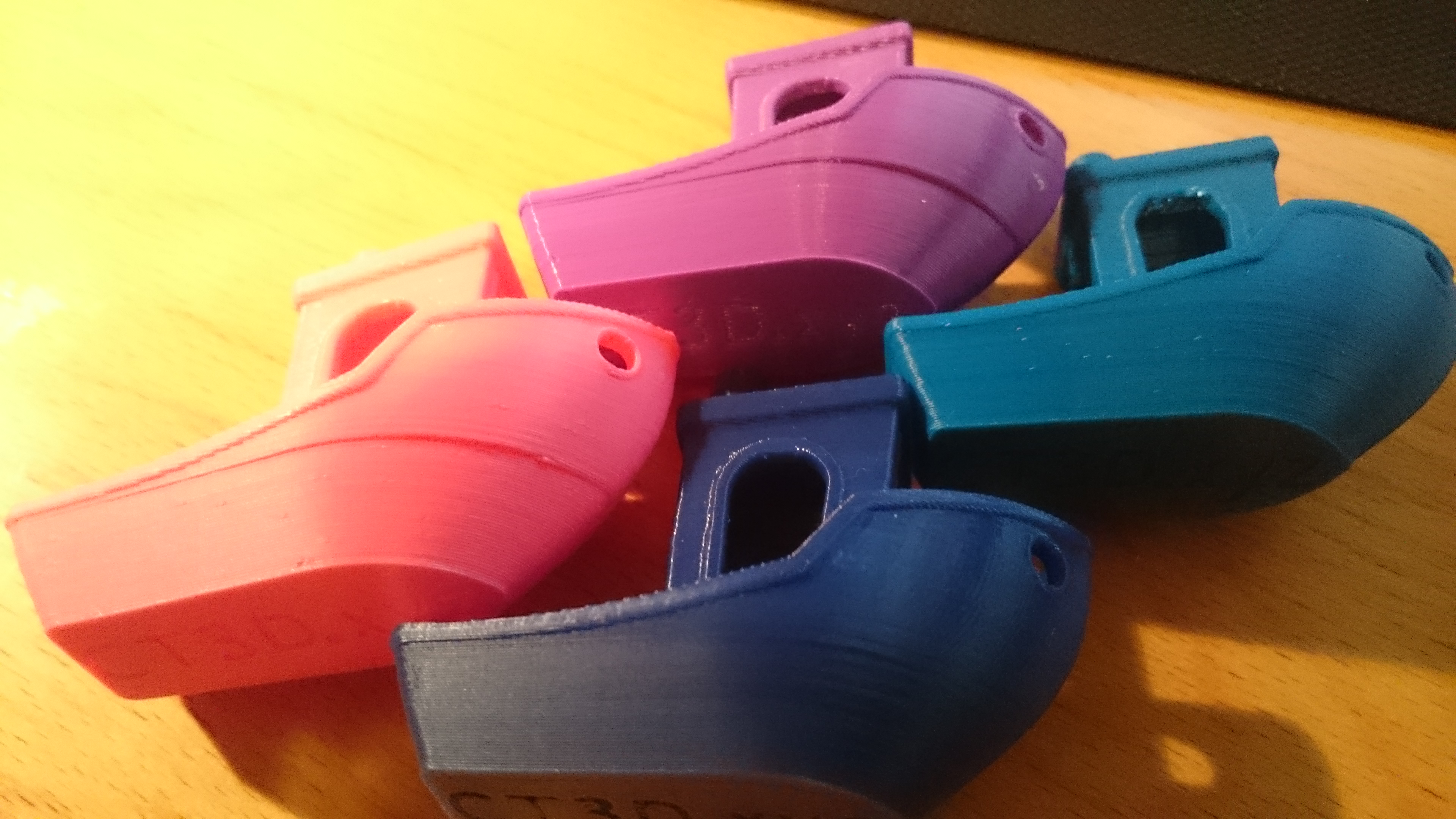

check out this picture:
The pink and the purple one have an error which looks like a skipped layer (but it isn´t - the height of all benchys is within 0,05mm).

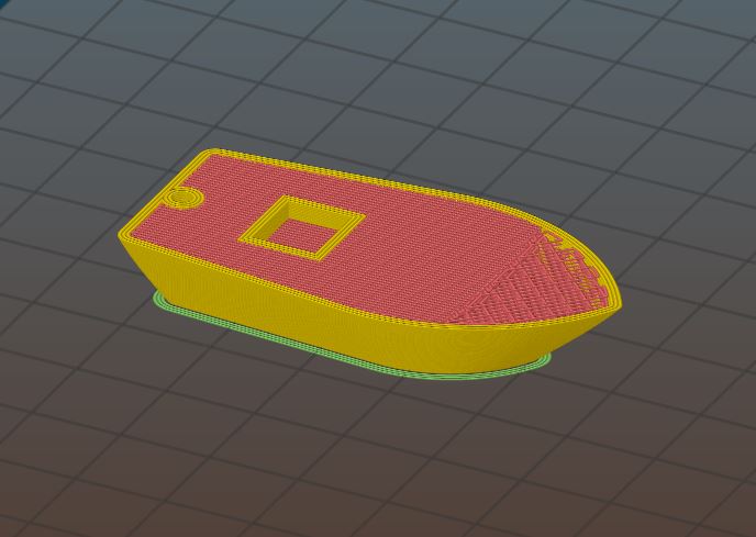

I´ve looked at the layers in slic3r - everything is perfect. I tried different angles on the printbed - no difference. The error occurs where the "deck" on the benchy is (same height). It seems like the shell is pushed out by the "full" infill.
this is the layer where it happens:

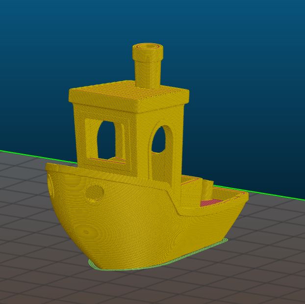

this is the fully model sliced - no visible errors:
pink and purple are the same PLA material printed at 200/65 - dark blue is a different brand PLA at 215/65 - the one to the right is ABS at 235/100.
all are sliced in 0,2mm with 3 shells 3 top and bottom layers (maybe 4 - but this shouldn´t make a difference).
I´ve uploaded the "faulty" gcode to gcode.ws and it looked as it should - no visible error.
