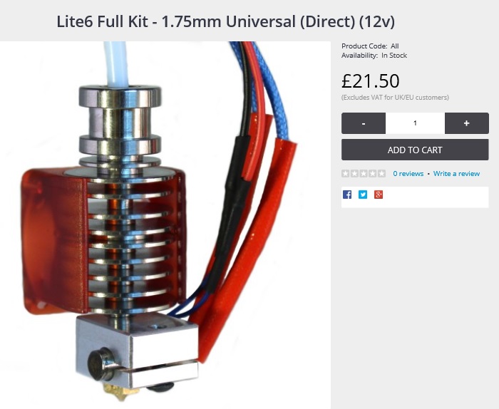

If I would buy as spare part from E3D-ONLINE, is it this one?
Thank you in advance for any support,
Ciao
Paolo

Paolo
Yes this one is the one that comes with your printer LiteV6
this is the termistor.
http://e3d-online.com/100k-Ohm-NTC-Thermistor-Semitec?search=%20&sort=pd.name&order=ASC&limit=100
Posted : 27/04/2016 7:48 pm

Many thanks for your confirmation Jozef
