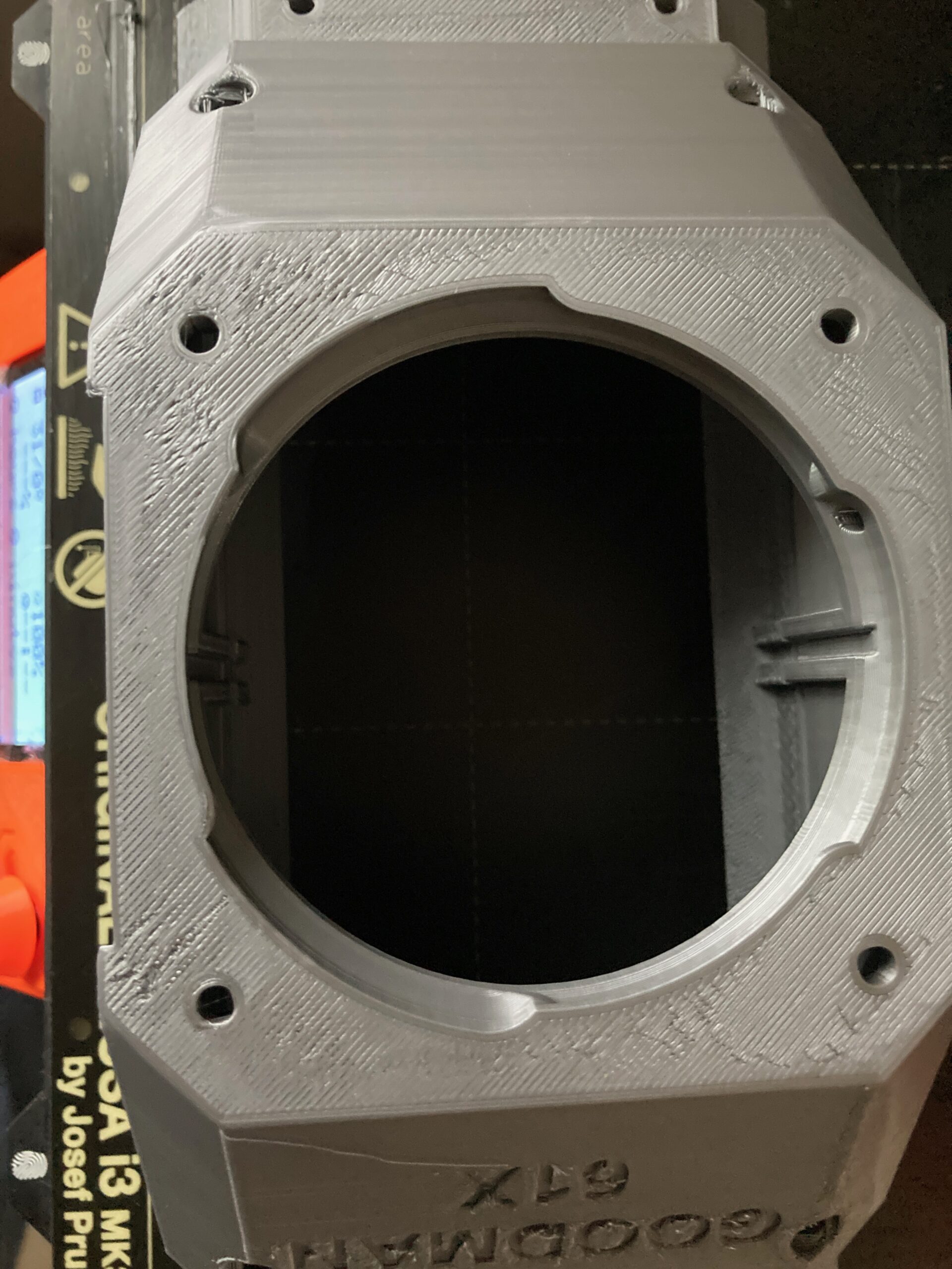

That's a different print you have saved your single layer square as a project.  It is failing because your print sheet has been ruined by someone using sandpaper instead of cleaning off their fingerprints and the first layer 'Z' calibration is too low.
You have other print sheets.  The underside of the first failed print you showed us would be of more interest and also project file for the print you showed us on 09/10.
Posted : 10/10/2023 7:56 am

attached: 9 hour print job from today and the STL it was made from.
Can you show the other side please and can you confirm which was on bed

The side you are looking was on the bed.
I have a new build plate arriving tomorrow (I hope) and that should help. This thread has been helpful at demystifying the first level/adhesion issues so many of use struggle with. I have never gotten a good first layer calibration, apparently, and I think I knew that but I didn't know what was wrong or how to fix it until now.

Ok yes your first layer is off if you need you can post photos of the first layer cal
Posted : 11/10/2023 5:12 am
It's a little hard to judge the first layer 'Z' calibration with such a scarred build sheet but I suspect you have it a little low.
The poor adhesion spots look like fingerprint patterns.  When your new sheet arrives institute a strict cleanliness policy.
The cleaning routine you mentioned above should have addressed this - are there any unusual contaminants in the printing environment?  We always assume greasy fingerprints or sometimes sugary ones where children are involved but if you are using aerosols in the same room, or spraying paint, laying fibreglass, arc welding ... anything that creates dust, smoke, spray... You get the idea. The bed needs to be clean.
Posted : 11/10/2023 6:51 am
