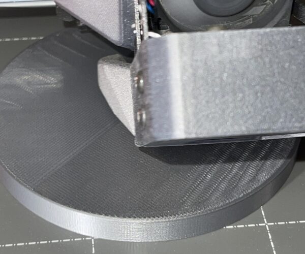

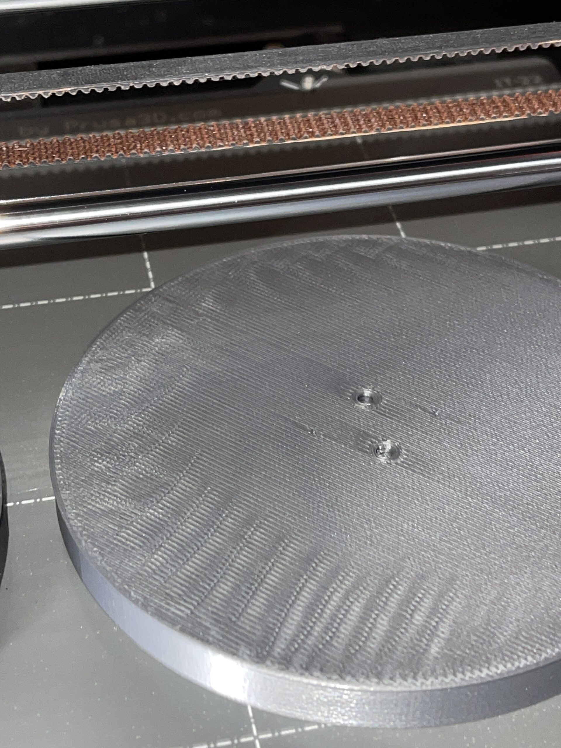

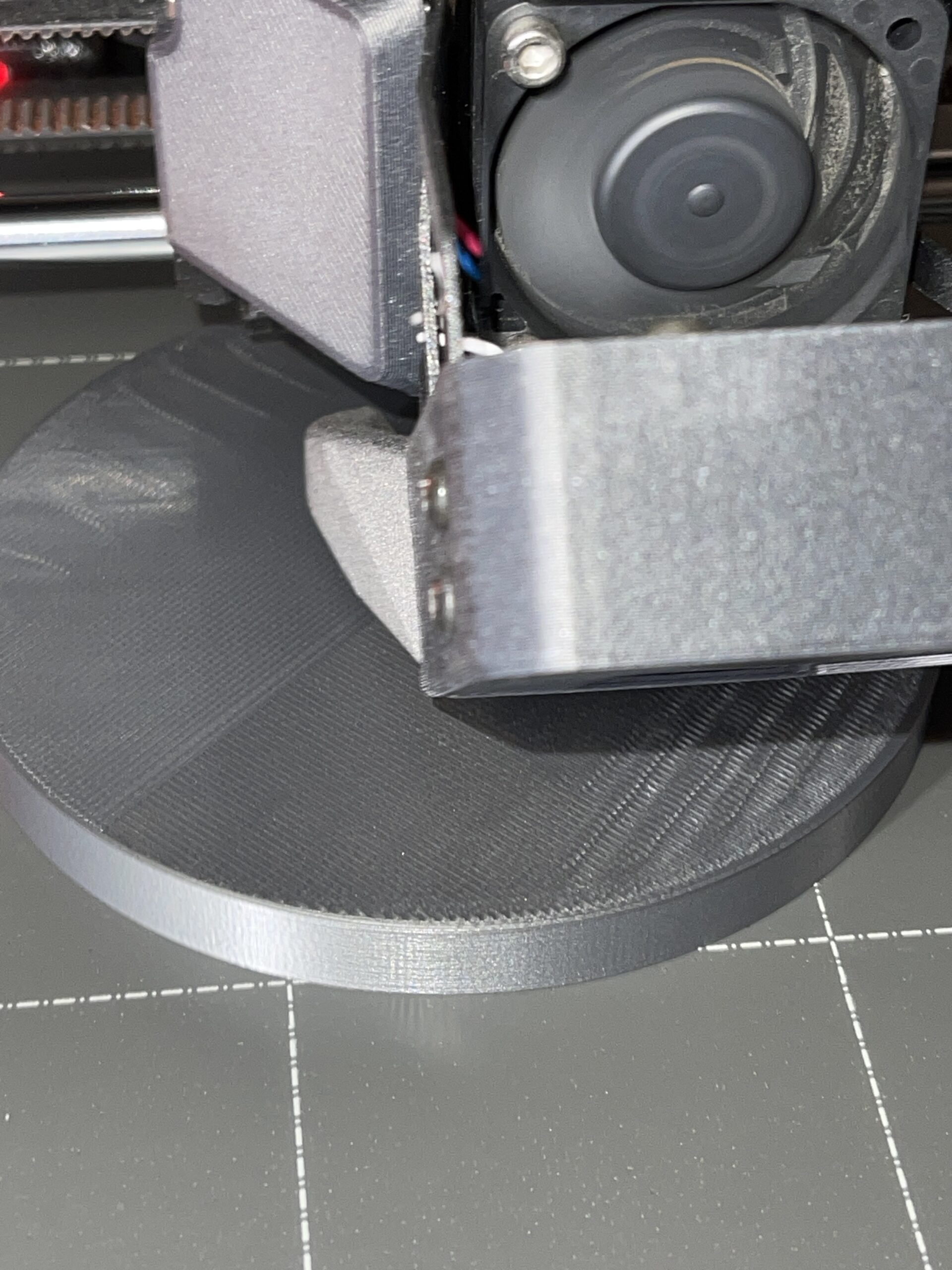

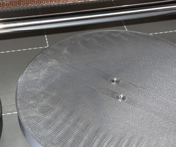

OK Its years after this post, and technology has moved on.   I'm using a MK4S with 0.4 CHT nozzle, and the material in use also happens to be PLA HS type.
But still I persistently get the wavy lines on the top and bottom surfaces of this particularly print which is a round flat cylinder.
The ripple effect looks for all the world like th wavy lines you get in sand on the beach near shallow areas.
If two objects of the same type are printed at the same time on the same bed, the pattern is produced on both, but its different.
I have tried numerous things to try to eliminate the issue, and this includes:
1. Increase in top solid ayers (currently 9)
2. Messed with Infill, currrently its 20% Rectilinear, but I've also tried Triangles.  I am using Archimedes Chords as Top and bottom Fill Pattern.   But the issue starts with solid infill well before its starts on that pattern, it begins at a lower level when its still doing recilinear.
3. Fill angle is 45 degrees.
4. Speed: Perimeters are set to 60 mm/s, infill 70 mm/s << So its been slowed right down from the normal speed for this printer. Yes the effect improved but not gone away.
5. Extrusion multiplier has been calibrated, and its set to 1.111 for this magterial.
6. MVS is set to 14 < again this has been reduced by 25% on the normal setting for this HS. material using CHT nozzle.
One the printer control panel, when I saw this happening, I tried reducing speed to 80%, and extrusion to 90% with little effect (I thyink the horse had bolted by that time.
My main problem is that I do not understand what is causing this to happen. Generally if I can understand the principle I can work out a solution, but this one has me beat.
Can anyone help ?
, it
Posted : 05/12/2024 11:20 am

Many thanks to those that responded.
Yes indeed there are many things that can happen to cause the symptoms described as the Topic heading.
As well as posting here I got desperate and reached out to Prusa Support overnight.  Whilst they did not give me the diagnosis, work they had me do to help the diagnosis ultimately led to a successful conclusion.
The telling test was to print the item on an alternative adjacent identical printer. The symptoms were invariant.  So the issue wasn’t with the printer itself.
Anyway the correct diagnosis was this is plain and simple over-extrusion, manifest throughout the print from first to last layer.
There were two root causes:
1. I had somehow messed up the maths in calculation of Extrusion Multiplier and got a way-wrong value of 1.11 when it should have been more like 1.06   Part of the “somehow”’was use of a CHT nozzle that was partly clogged - identified as an issue days after the calibration print was run.
2. even with that fix in place it still over extruded and I simply reduced the “flow rate” on printer control menu to 80%. The conclusion here is that (1) XM was still incorrect.
With those two changes, the item printed flawlessly.
The backdrop of all this is using an unfamiliar “High Speed” PLA   but poorly documented filament from irregular supplier on the mk4s printer with CHT nozzle.
The project I’m working on is near its conclusion now. I’m left with a ton of wasted material having used more than twice the predicted amount on failed prints and test prints, not just because of this particular issue but earlier issues as well. It all adds.
Thanks again.
Posted : 05/12/2024 9:24 pm
