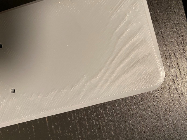

I have encountered the same problem, ripples in one or two corners of the top layer of my print. It is a square with rounded corners, just as some one earlier had problems with. Tried changing the filament but got the same result. All the layers look nice, but the last ones have the ripples in them.
Did anyone find a solution to this problem?

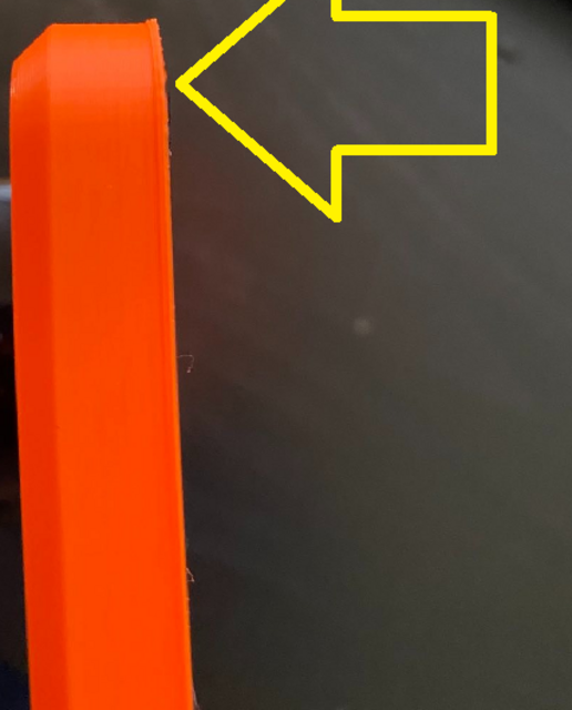

I printed out a new one and it looks like it is only the last layer that gets the rippels, the layer before it looked nice. I also noticed that i got a bit of "elephants foot" on the last layer, but only on the sides that have the rippels
I think this means that the last layer is pressed too hard into the printed part, a quick fix is to stop the print.
Is there any way to change the settings for the last layer, and reduce the pressure? The build plate is pretty new, 6 months, and hasnt been used that much, still looks nice. This is on a Prusa I3 MK3s.

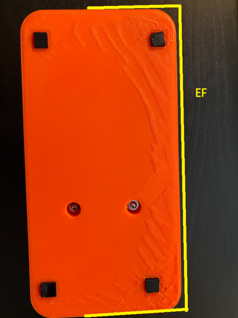

I get this when my print starts lifting from the bed while printing.

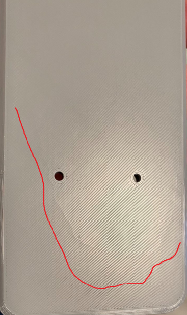

You are right Bob, i had a look at the underside of the print and found that there is a very slight pattern that corresponds to the waves on the top side. The pattern is probably from where the print doesnt stick to the plate, this also explains the elephants foot.

It looks just like mine, probably your print came loose from the bed in the sides like mine. I didnt feel it when i removed my print, it still snapped of nicely, but when i looked at the underside for a while i managed to see a slight difference in the bottom layer(se the picture in my last post).
If you look at your print, do you also have a slight "elephants feet" where the top layer is pressed so hard it squeezes out on the side?

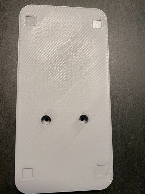

I did a new print after changing to Isopropyl alcohol from Windex, the print stuck better but i still got some sticking issues. Looking at the bottom of the print shows that i reduced the amount of area that didnt stick from about 30% to perhaps 10%.  The top layer looked much better also!

The sheet has been used for 7 months and 340hours of printing. I tried printing on the other side of it(for the first time), and it stuck better, the print looked really nice. I would say that there was only 5% of area that showed evidence of comming loose, compared to 10-15% on the side that had been used for 340 hours. There was also no waves or ripples on the top layer.

In my case it turned out to be due to the print not fully sticking to the bed.
My prints were stuck to the bed in the middle, but the sides came loose and warped slightly upwards resulting in the nozzle hitting the print and causing the waves on the last layers. If i hold up the print in the right light i can see what parts of the bottom that stuck to the bed, they are slightly shinier . I have this issue when printing big and thick prints, to reduce the problem i cleaned the bed with acetone(and later got a new plate).
