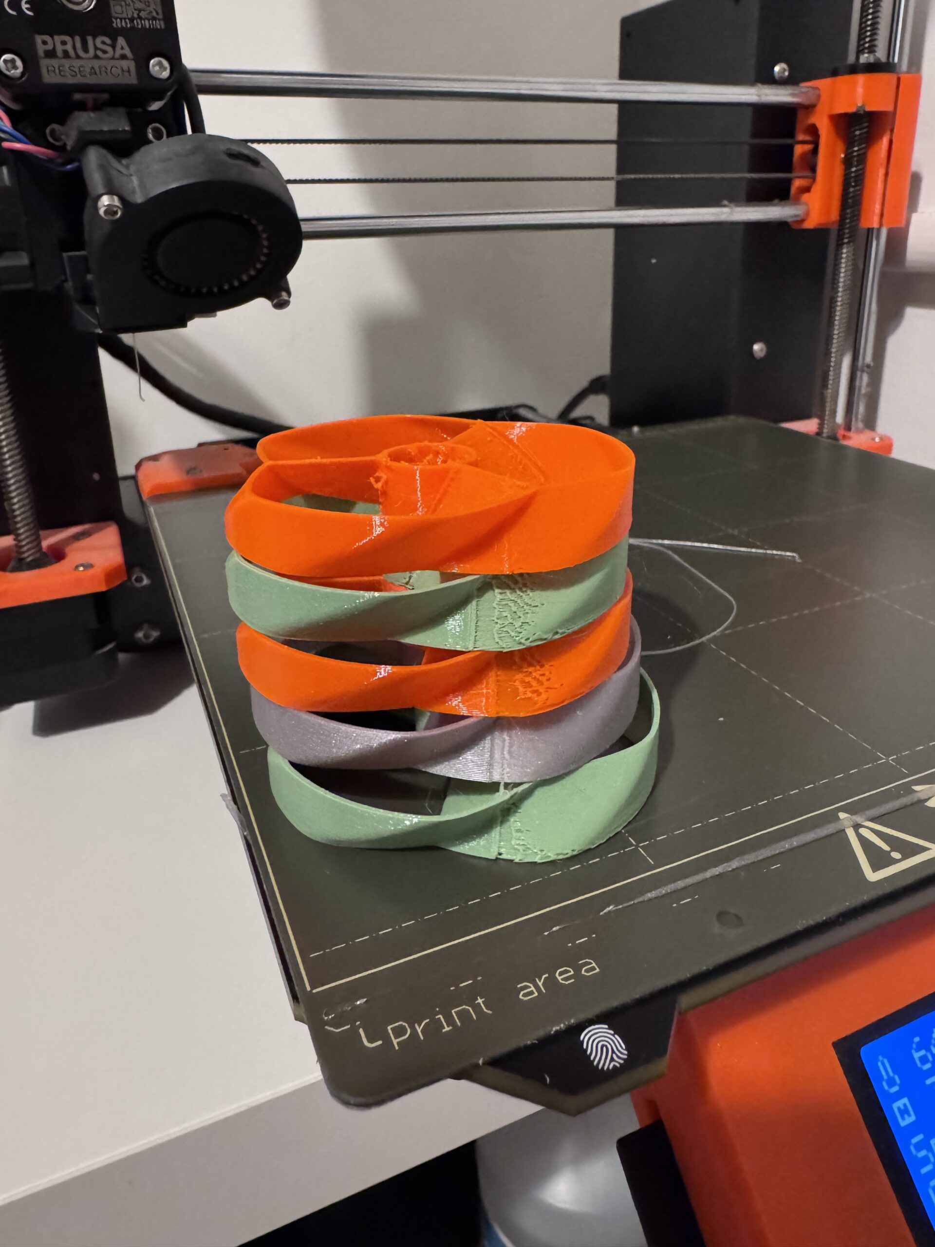

Hello, I’m having some issues with a print, it looks like the printer is under extruding after the seam, Ive tried printing with and without input shaping, reducing the retraction distance, printing with different materials.
Turning off retraction completely improves the under extrusion but I get poor print quality because of stringing. I also tried printing with my mk3s which had much better quality.
The below image shows my attempts with various settings, the top orange is with retraction off. The grey is with the mk3s.
