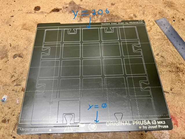

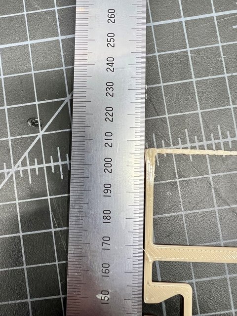

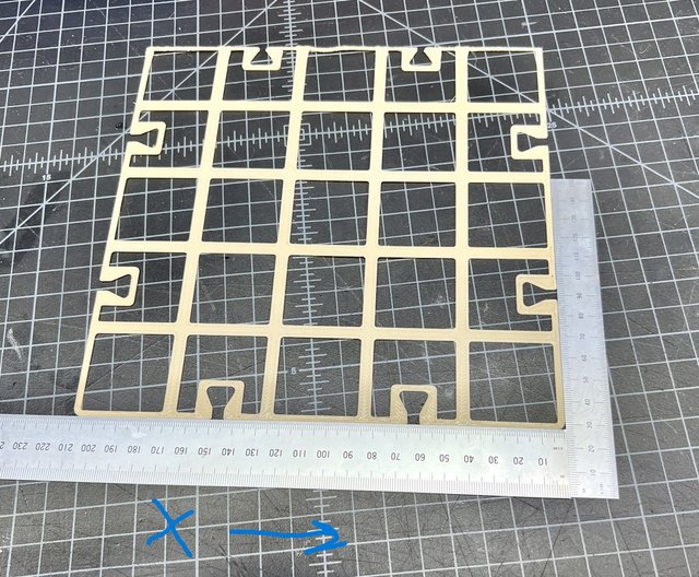

I've had these mk3s for a few years and have never tried or needed to print at the maximum dimensions until now.
In my case here, I am trying to print a 210x210 object.
- The printer appears to go no further than ~205-206mm on X-axis
Plate-Y
Plate-Y1
Plate X
Plate-Full
I have tried the following without any improvement:
- Set Skirt to =0
- Set Brim to none
- Even set 'First layer expansion' under Supports, even though I am not using supports, just in case.
Everything slices fine in Prusa Slicer, but it appears that the printer may be limiting the maximum dimension.

I made a typo. I'm currently having a problem with the Y-axis. Although, the X axis may have the same problem.

So it seems the bed cannot travel far enough to the front...
Check if the Y-belt is assembled according to
https://help.prusa3d.com/guide/2-y-axis-assembly_165795#166473
steps 15 (no gap between frame and y-idler) and  steps 34 to 37.
Make sure the two plastic parts attached to the belt ends are not altered in their position (but i am not sure if that would be possible at all)

I probably should have mentioned this.
I also checked to see is there was more travel for Y-axis beyond y=206 by moving the bed to max (206) then shuting off the printer and maually moving the bed forward.
The bed could be moved ~5mm beyond y=206
So, currently complete travel for the y-axis is:
Y=-4  to y=206
y=-4 being the defined outside of print area where thepurge line is done.
I was unable to even use the -y positions in PrusaSlicer. It just won't slice if object it <0
Posted : 27/02/2023 4:32 pm
