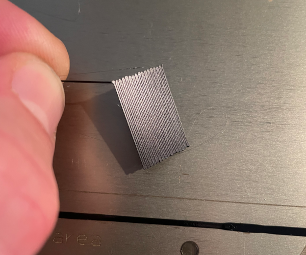

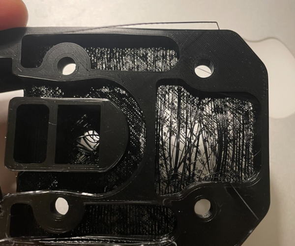

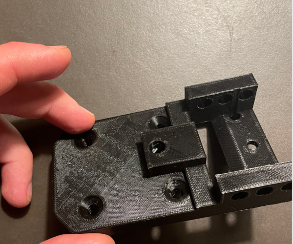

I recalibrated the printer (stupid mistake) and after that the print came out super fragile. Previous prints were sturdy…
I used "0.2 mm  speed" and only 5% infill. But it has worked good before.

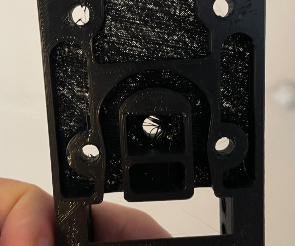

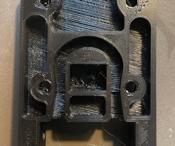

The top layer (see first image, top layer is facing down on the image and looks like a spider web) is 1-5mm thick in the design but transparent on the print. I know im printing that layer in the air, will use support .

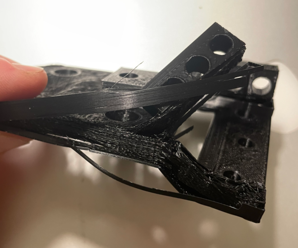

On the other image I squeezed the part with my hand, would not be able to do that with the previous  prints.
Please note that the first layer is the side facing up on the first image, and it looks pretty good?
Is the Z-axis wrong?

Rule number one in such case: use default settings in slicer and print again. Your first layer seems to be ok and has nothing to do with your trouble.
You might get better help if you provide 3mf file of your sliced object.

I agree posung a zip of the .3mf will be the way for people here to sort out your problem.
However, just looking at the print, after the first layer, you appear to have terrible interlayer cohesion and under extrusion, so things to look at are hot end temp and flow rates.
As people have pointed out, without the .3mf this IS NO MORE THAN A GUESS!

Your file with "0.15mm Speed, Prusament PLA, Original Prusa MK3S & MK3S+", all standard settings
Filament I use was Prusament PLA that has been out of bag for at least 1 month, probably closer to 2.
The hole in the middle is printed in mid air, obviously there is a problem with that 😏
Bridges could be improved with some support
Overall it looks descent on the (I assume) outside, and is sturdy
Filament on your pictures looks a little glossy, are you sure it is PLA? I've had wrong filament loaded, more then than once... 😔
Did you print a single wall test cube for flow rate test?

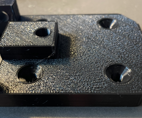

looks great. It looks the same as it did for me before i recalibrated. Im 100% sure im using PLA, and  it's the same PLA as i used the day before i recalibrated, see the image below.
I guess something is wrong in calibration then?

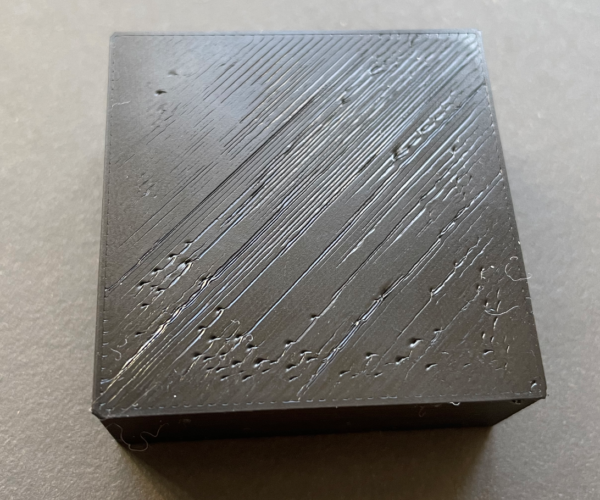

(@sylviatrilling)
Extrusion multiplier
You can print the cube and just take the average of your measurements. If your average is .45 or close to .45 then the default multiplier is good and we'll know the problem is elsewhere.

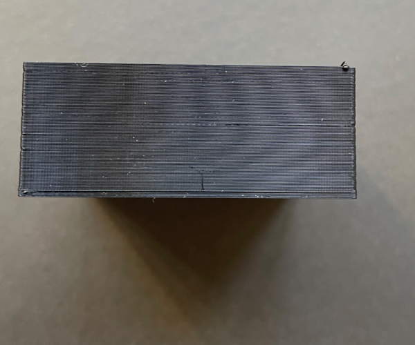

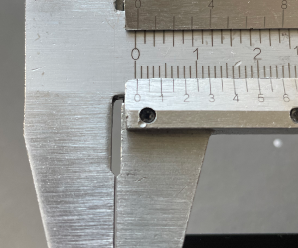

the cube
Hi, i printed the cube in 0.15
I think the backside of the base looks a bit off? Also the walls are slightly below 045?

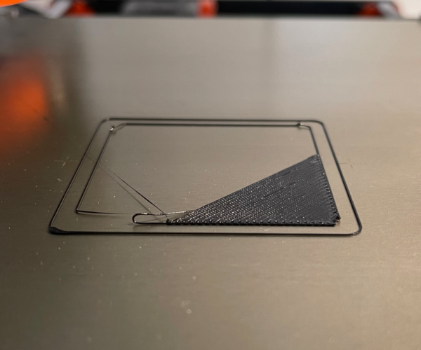

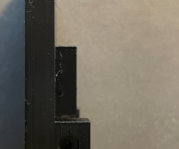

Re-did everything
Ive restarted it all,
1. updated Slicer
2. Updated firmeware
3. removed and cleaned nozzle
4. recalibrated (looks  good now, or is it too low?)
The new problem now is that fillament is sticking to the nozzle. tried to film while printing the cube…

Ringarn67
(@ringarn67)
@chisburg
Go lower 👍
