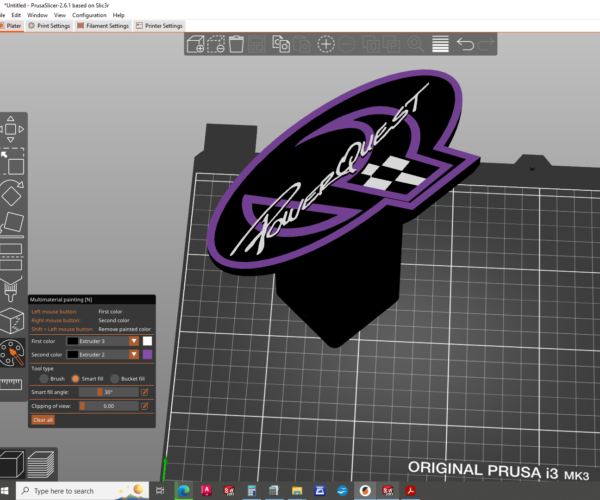

OK.... So I'm getting a better handle on my SolidWorks skills. I'm still a hack, but not so much of one. I've polished up my models, making them into one contiguous solid, instead of a stack of parts. I've also discovered the multiple extruders settings in PrusaSlicer, and have the model painted up how I'd like it to look:
My MMU3 is still apparently on the slow boat from Prague, but I'm getting anxious to give it a whirl. I have figured out how to cut my model down, so I don't have to waste a bunch of filament trying to prove out the multi-color thing, so I'm planning on just printing out the top half inch or so; just enough to include a base layer and where the color changes start. With the Slicer set to three extruders, I'd guess I need to uncheck the "multiplexing" box, so it will code in pauses and alerts to manually change the filament....? Am I on the right track?
