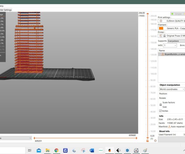

Slicing model shows empty layers
Sliced  model showing empty layers Model in PrusaSlicer
Does anyone know why PrusaSlicer would wipe out entire layers from a model when slicing?  I am trying to print a model of a building but entire layers are being deleted during the slicing process.

RE: Slicing model shows empty layers
The walls of the model are thinner than the printer can create so it won't try in those areas, try going into Print Settings -> Layers and Perimeters and enable Detect Thin Walls.  If that doesn't work scale the model up a little bit, it might thicken the walls enough to print them.
