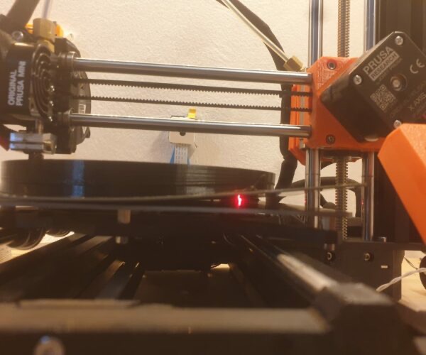

RE: Prusament PC Blend Carbon Fiber Black, pccf
Be careful.  The glue stick is both a sticking agent and a release agent.  Many a user has ruined a sheet not using the glue stick.

This is what can happen:
