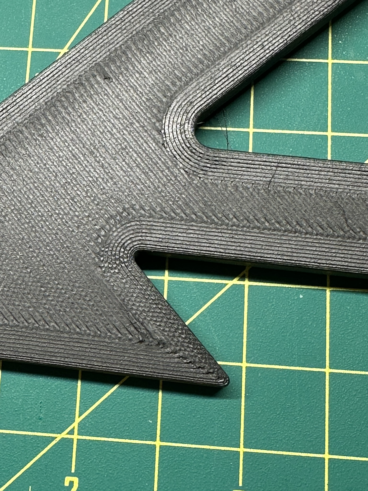

I am seeing some Layer lines on the Top and Bottom Layers. It's not an issue to see them but they don't appear to be connecting to the filament next to it. Is this normal to see this with .6 Nozzles? Edges look great. I increased extrusion width and that just made a mess.
I recalibrated first layer to add more squish and it did not change the bottom layer. Any suggestions on trouble shooting this?
Bottom Layer
Top Layer

Your first layer Z offset calibration is a fraction too high.
