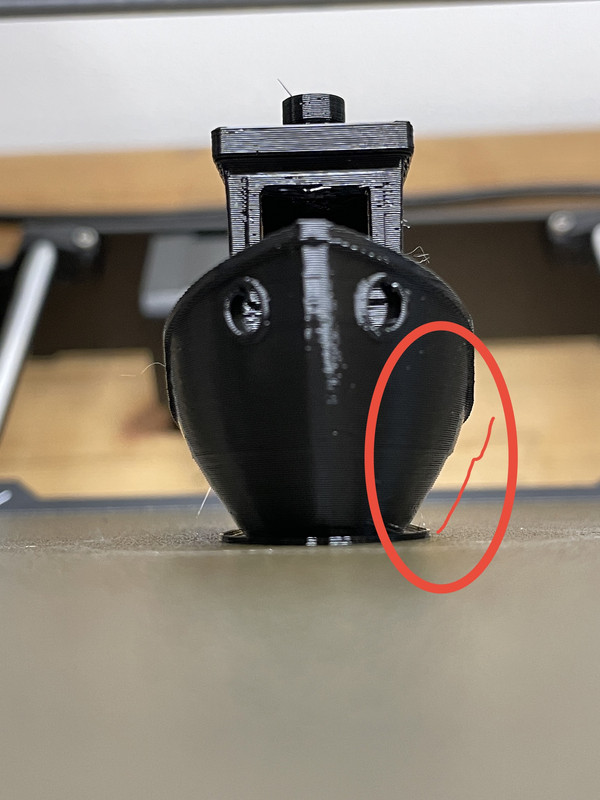

i think i’m having the same issue. But most off the time on one side of the print. With the 3d benchy on the y-axis but only on the backside of the print. And on a battery bracket from makita on the x-axis, only on the right side of the print.
Printed parts without problems since august, untill now.
printed the benchy with amazonbasics petg on a mk3s+
0.2mm layer on 0.4mm nozzle
temps 240/85 & 245/90
20% rectangular infill.
lift-z 0mm / retract 1,2mm

@oos134 that’s the benchy hull line on your picture. It‘s caused by the transition from infill to solid.
see: https://help.prusa3d.com/en/article/the-benchy-hull-line_124745

Thanks!
I think the problem is caused due some loose belts. I tried to adjust the belt tension value between 240-290 (270 as the sweetspot) and had to loosen the belts a lot. Maybe a little bit too much. Will re-tighten them, and have another go.

After checking the belt tension. I realized that I misread the thread. Will check my slicer settings.
