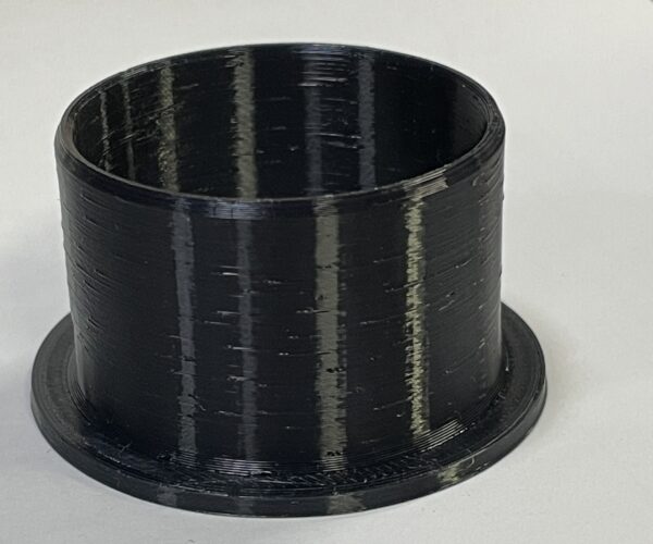

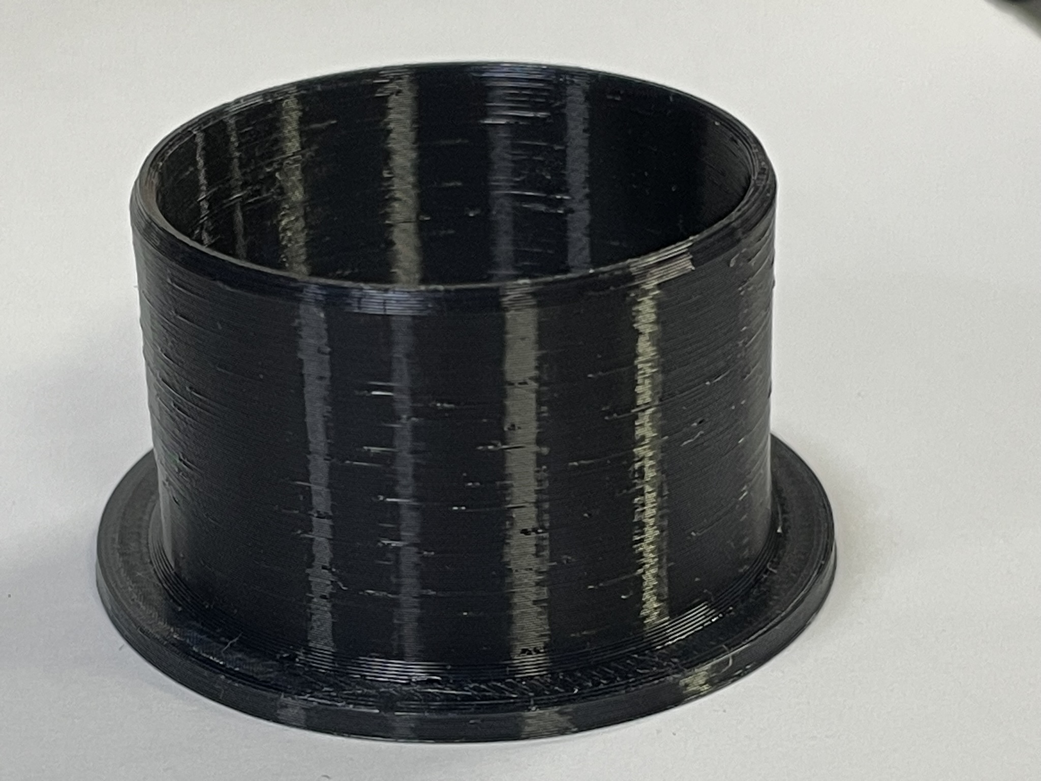

I have just printed PA6 Nylon for the first time, I used a plate of FR4 fiberglass Printed circuit board with the outer layer of Copper etched off, This has a matt finish and the PA6 stuck extremely well first print, Just FR4 NO GLUE.
Printed bed temp 100°C

First print with PA6
Ender 3 S1 Pro
