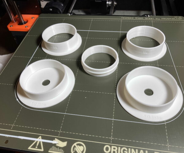

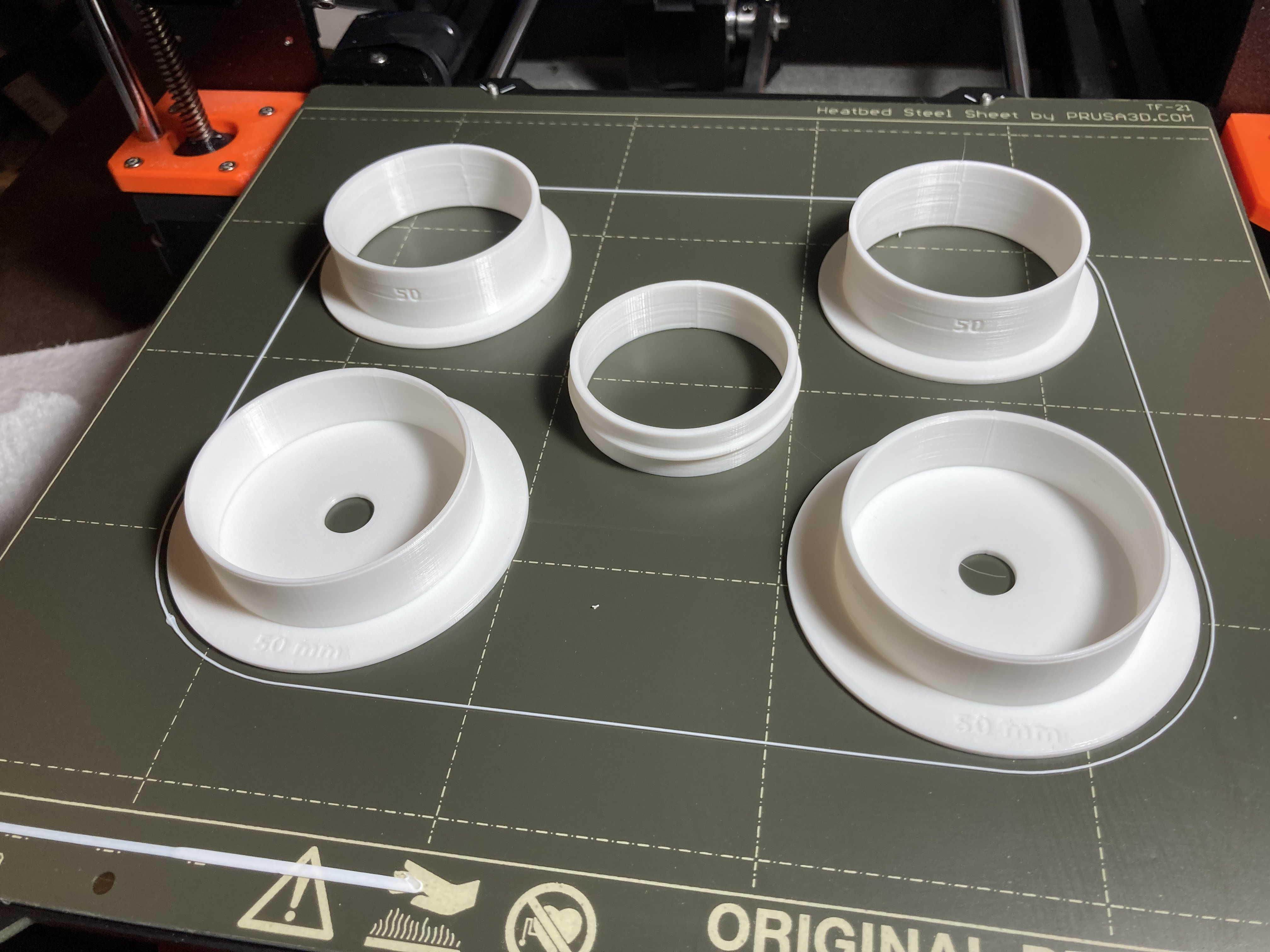

Just finished a print of the alignment tool parts
In the CAD model this part of the alignment tool has a 49.7 mm OD. I took five OD measurements at different rotational orientations around each of the two parts I just printed. When measuring I avoided the layer seam which is set to "back" in the gcode for these parts.
Part 1: 49.66, 49.65, 49,64, 49.62, 49.64
Part 2: 49.72, 49.64, 49.77, 49.69, 49.64
regular PLA parts for aligning other parts to be glued 50 mm Alignment tool parts
Going to try adding a short movie too:
Posted : 29/04/2021 11:44 pm
