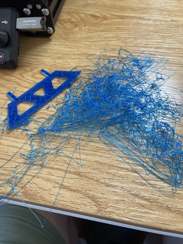

Today's experience with CPE.  I had previously printed a set of parts for MMU3 Buffer unit using CPE HG100 (because of y'know, looks!). and they all printed just fine on my MK3S+ inside Prusa Enclosure.  So today I wanted to print just one of them, because I needed another leg part. I resliced it for my MK4, which is not currently in an enclosure, and both times I tried (same roll of filament !), it warped, and the first one popped off the bed during print, and caused a birds nest.  I tried both Textured and Satin beds, both warped.  So, I'd say the difference is in having/not having the enclosure.  It stands to reason, but I guess I felt bullet proof, since the MK4 is just so great, I thought nothing could break it.

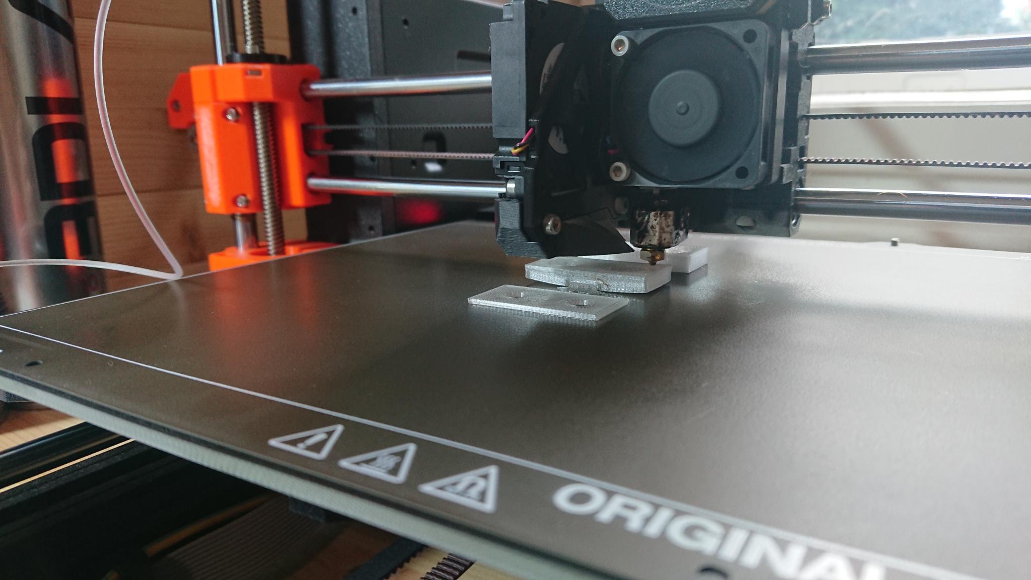

My filament is: Fiberlogy CPE HT
recommended settings:
- nozzle temp: 260°C- 280°C
- bed temp: 110°C-120°C
- fan: 0%-25%
I dried the filament just before printing.
My bed is the satin coated one with dblac (with all other methods even the first layer was not sticking)
The picture shows heavy warping:
- nozzle temp: 280°C
- bed temp: 115°C
- fan: 10%
My idea resp. reasoning about this:
Since only the piece in the middle shows this extreme warping and because the only remarkable difference in the printer assembly is the central heatbed mount (exactly beneath this piece), I think at such high temperatures the mount contributes to a uneven heat distribution in such a way, that I get this warping...
...so a thermal image would be great, to identify heat distribution of he bed and then one could place parts on different locations to confirm the theory...

Oliver B
(@oliver-b)
RE: CPE warping off the bed
41. Attaching the heatbed
Posted : 10/07/2024 6:55 pm
Hi Oliver,
If you think the spacer is the problem, why don't you move the models off the centre of the build plate in Slicer?
Posted : 11/07/2024 9:43 am
Oliver B
(@oliver-b)
Yeah... I did it in my last print and it was a success... also lowered bed temp to 100°C and nozzle to 270°C.
Was also researching for carbon fiber m3 screws without success and thinking of replacing the spacer with a piece of Pertinax
Posted : 11/07/2024 10:22 am
might be able to get Nylon Screws.
Posted : 11/07/2024 6:35 pm
Oliver B
(@oliver-b)
uhhh... now you brought some light... I found some PEEK screws which seem superior in terms of heat resistance and their thermal conductivity is also a little lower:
M3 Senkkopf PEEK
...will try it out ... thanks for your assistance 🙂
Posted : 11/07/2024 10:03 pm
I sparked your thoughts, and you found another option to address the situation.
I Would never have thought of PEEK...
I was thinking towards the revised bed mountings as used on  Mk3.5, mk3.9 and mk4, where plastic flex spacers are used allow thermal expansion. but  I believe  they still use a single rigid mounting in the centre of the bed
https://help.prusa3d.com/guide/7-y-carriage-heatbed-assembly_438310
Step 37 onwards
Posted : 11/07/2024 10:41 pm
