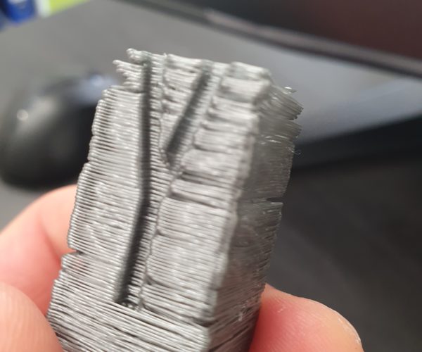

Dear forum members, you are awesome and I think I need help.
Can anyone tell me what the error of the following 2x2x2cm cube is called (as seen, it didn't finish, but more importantly, the Z-axis of the object seems like it is 200-250% its original size!!!):
Link Removed for site security reasons    Please embed the images directly in the page
and select Link to: Media File
second Link Removed for site security reasons
I have no clue what it is called, so I can google it and fix it.
Thank you so much for your time!

RE: Can anyone tell me what this issue is called? Print objects Z more then double size!
Hi, thank you for taking your time for responding : )!
I hope it worked now with drag & drop :
I printed the object flawlessly on another printer, it seems that something is strange with the Z-Axis, never seen it expanding O.O
(Just to be sure: Same gcode different maschine = perfect 2x2x2cm cube)
What printer is this from, and how did you slice the gcode for the print?
Is is as simple as you are using gcode for the other printer?
Zip then post the stl and gcode, too. That will allow folks to try recreating the problem.

Hi Michael,
Thats a really odd result,
It looks as if the Z axis is twice as tall as it should be...
and the layers seeem to not be bonding together very well...
I have never seen this before...       but, Guessing...    it could be a problem  with the Stepper Motor Programming.
Stepper motors normally use 'Micro Stepping' to improve the quality of prints.     On a RAMPS board there are header pins and jumper links to set the micro stepping....     to be totally honest I don't know how Prusa sets their Einsy controllers up...
But....
If the micro stepping is set up by the programming, like I know the Motor current is, you could have a situation where the Z motor stepper controller is corrupt and instead of doing say 1/16th mictostepping, it was doing 1/8th microstepping... you would get exactly this sort of problem,
So...
I suggest you re program the Einsy controller with the latest Firmware. and try the test print again.
https://www.prusa3d.com/drivers/    ; link for the latest drivers
https://help.prusa3d.com/article/r5ByKgVm69-firmware-upgrade-and-flashing   ;Link - How to  flash the firmware
Regards Joan
