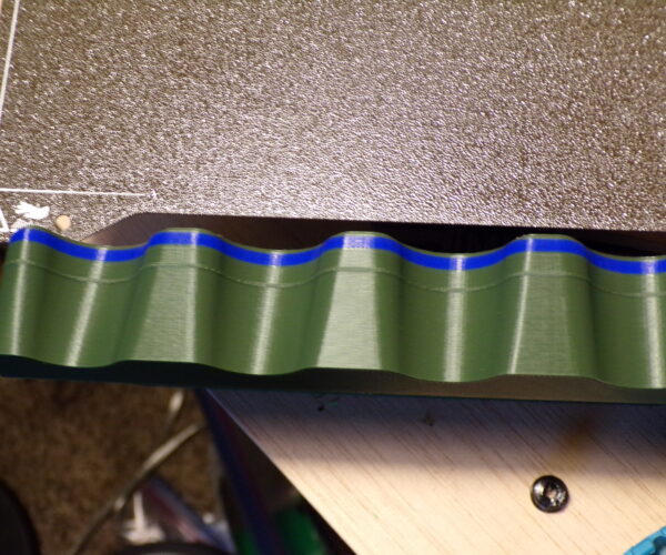

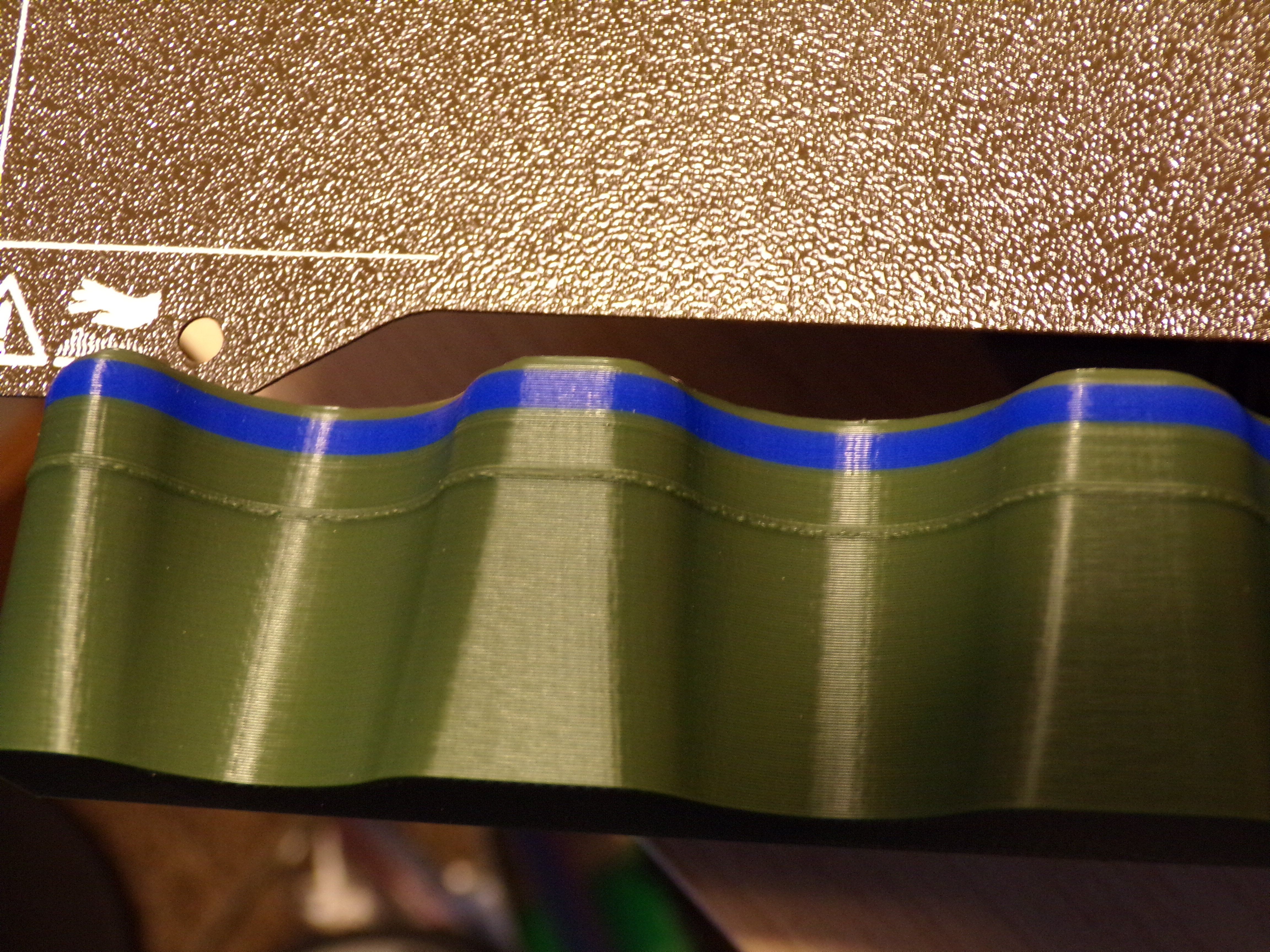

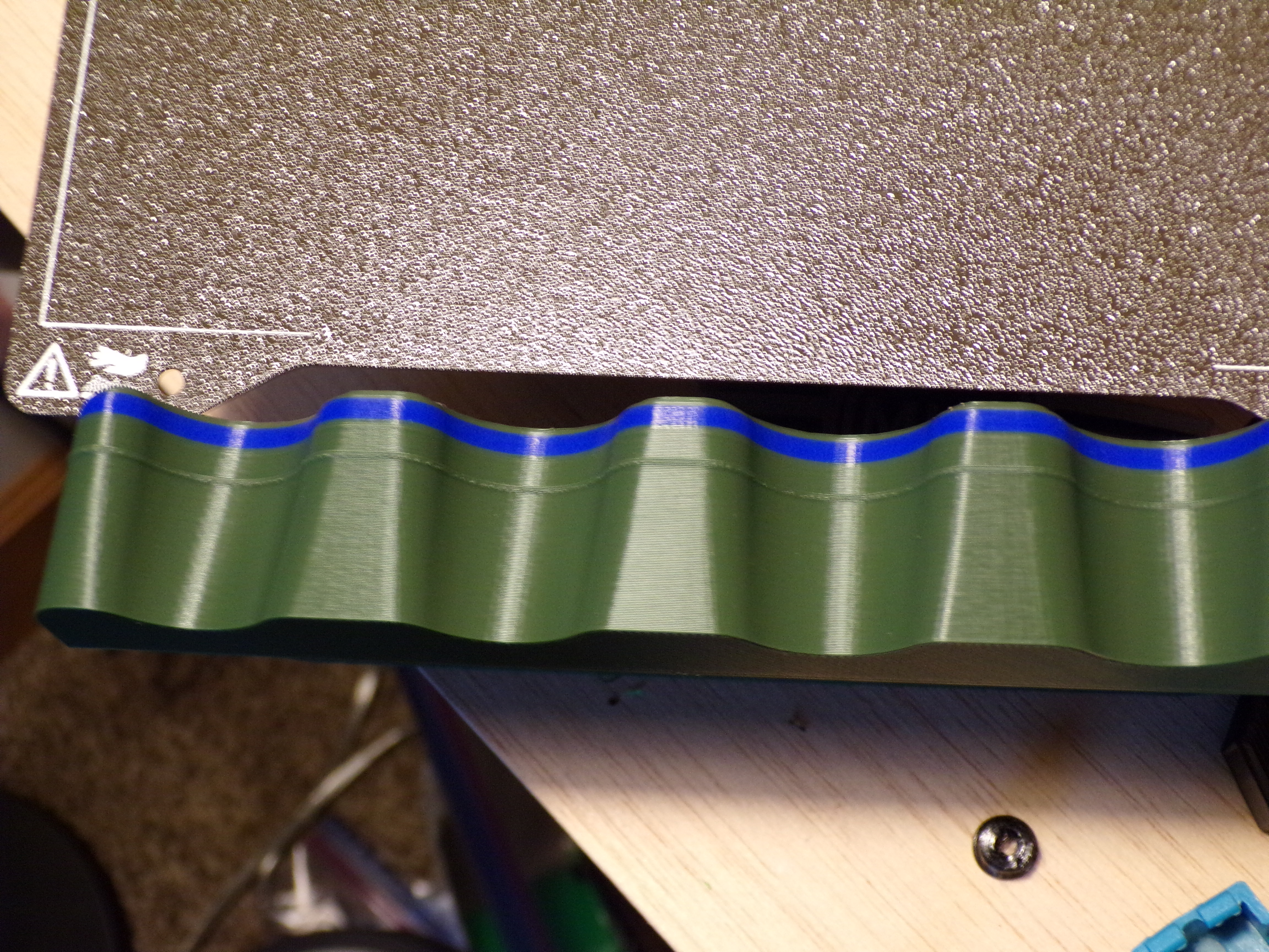

Hey guys,
Just a quick note in case someone runs into this:  I have posted a lot on the buldge issue in this thread but just lately I have had a number of prints that were considerably worse.
Not sure it this is related to the latest PrusaSlicer update (2.3.0 - love the monotonic infill btw).  I make a number of custom parts for people that are similar in design but not identical.  I use very similar methodologies with each part to try and minimize the bulge problem.  Several lately have had much worse bulges with it being so bad that there are continuous "blobs" along the bulge line.
I just happened to notice that on the top ledge levels the print was doubling up on some perimeters.  I've attached a PNG with the sliced version.  Looks like 2 perimeters on the front curved section with the lesser infill, but it is actually going over those perimeters twice.  What is also interesting is that when I checked the g-code and confirmed it was going over those perimeters twice the x and y movements were not quite identical.
The method I am using here is to apply modifier mesh to the section with the 80% triangle infill, thereby getting rid of solid top layers which has helped in the past.  Note that it is not doing this on every part.  Some double up some don't and I have not sussed exactly why at this point.
Just posting this to help anyone analyze the issue if it shows up for you.

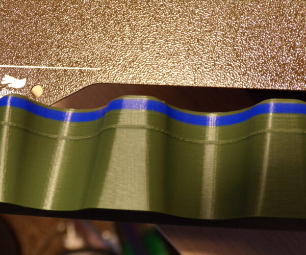

RickM
(@rickm-3)
RE: Buldge when print reaches "solid" layers
Example of aforementioned ultra bulge
