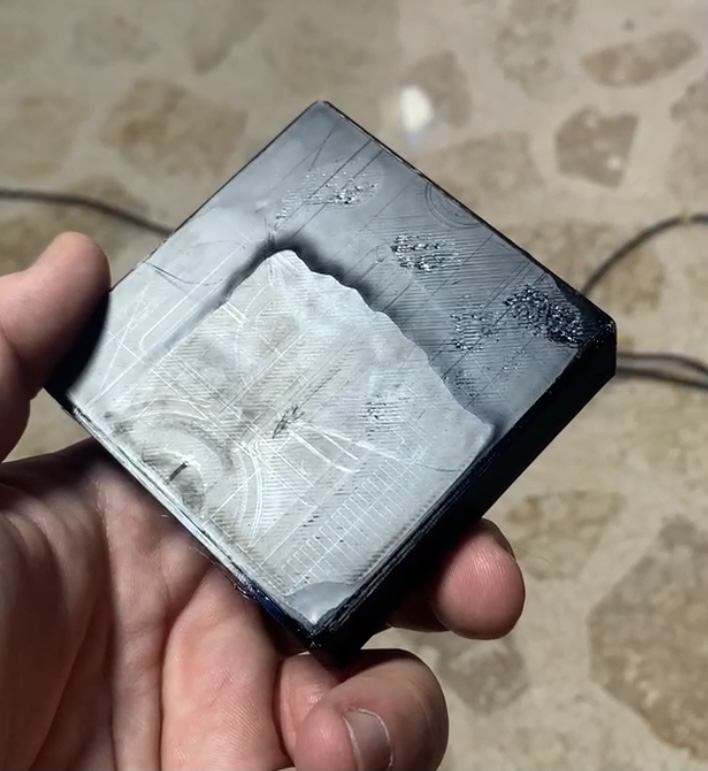

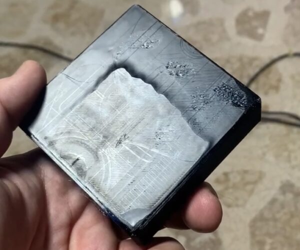

Printing Problems What causes this
Printer has been sitting for 2 months. It was working great before. I have tried printing this block using many different filaments with same results. I have aligned everything even went to the Wizard and ran that. This is printed with a  new roll of E-Sun PETG Filament. I am stumped. Any thoughts on what could be causing this?

Have you printed this object before?
Please export your project as a .3mf, zip it, and post it here so we can diagnose your settings.

No I haven't printed this before. The STL file was downloaded from Thingiverse. I have tried printing it at least 10 times after making adjustments to printer with similar results. I will get the .3mf Zip file loaded soon.

It's definitely printable.  I would use adaptive cubic infill and at least six horizontal layers on the top surface; this assumes you rotate the sliding faces upwards.
Your fllament is picking up where the diagonal limit fails to meet the curving gyroid infil...
Try these changes and if there are still issues post the .3mf.

I just went to my sons house and used his printer (same as mine just older) and the print went perfect. I am starting from scratch adjusting my printer just like after I built it. We will see what happens.

I have found the problem-for sure this time.
Thanks for the help on this.. I was watching it print and realized that there was filament coming down the sides of the Hotend heat block. So I take osme parts off tho see that the top of the block has filament on top and realized the problem. 1 month before letting it set up a stint on a PLA project bet had put my PETG filament on by mistake and walked away from the print for 30 min or so. When I went back to the printer there was filament all over the place. I cleaned it all up and did a couple of small prints (using the correct everything) without any problems. Then after 3 or so months I tried a larger print and ran into the problem. I haven't disassembled the heat unit yet but from what I can tell I must have cracked the Hotend Heatbreak.  So I am going to replace the  assembled hotted.
