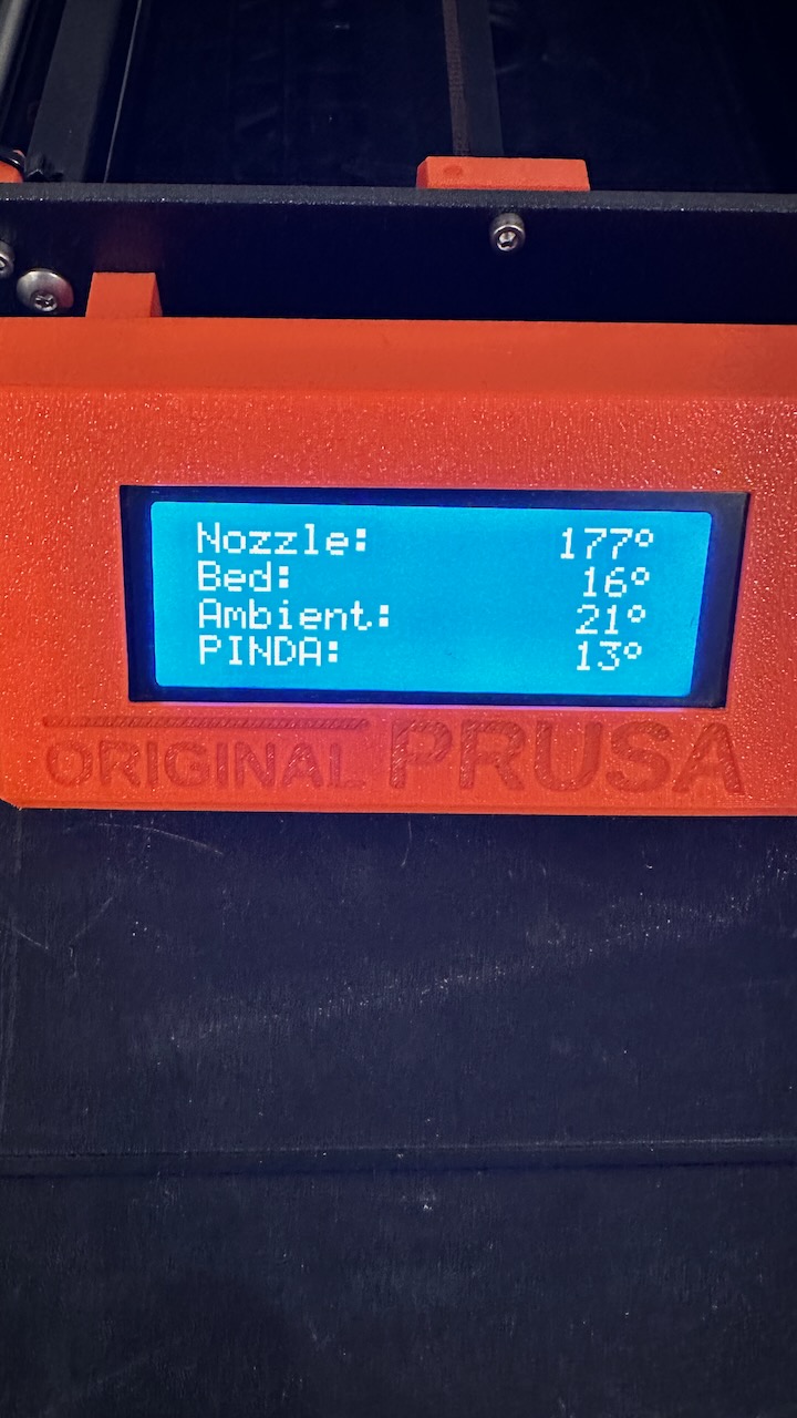

I've been printed happily with my MK3 and then MK3S for five years now. Few weeks ago I started having some print failures due to nozzle temperatures dropping below the expected temperatures. I tweaked some settings and I could print with more successes but still I experienced rare failures.

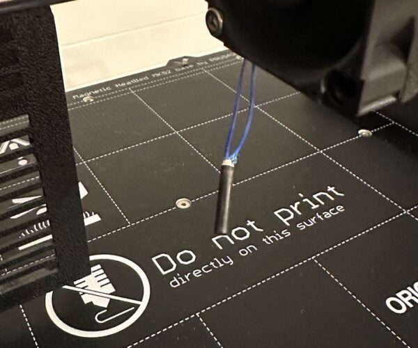

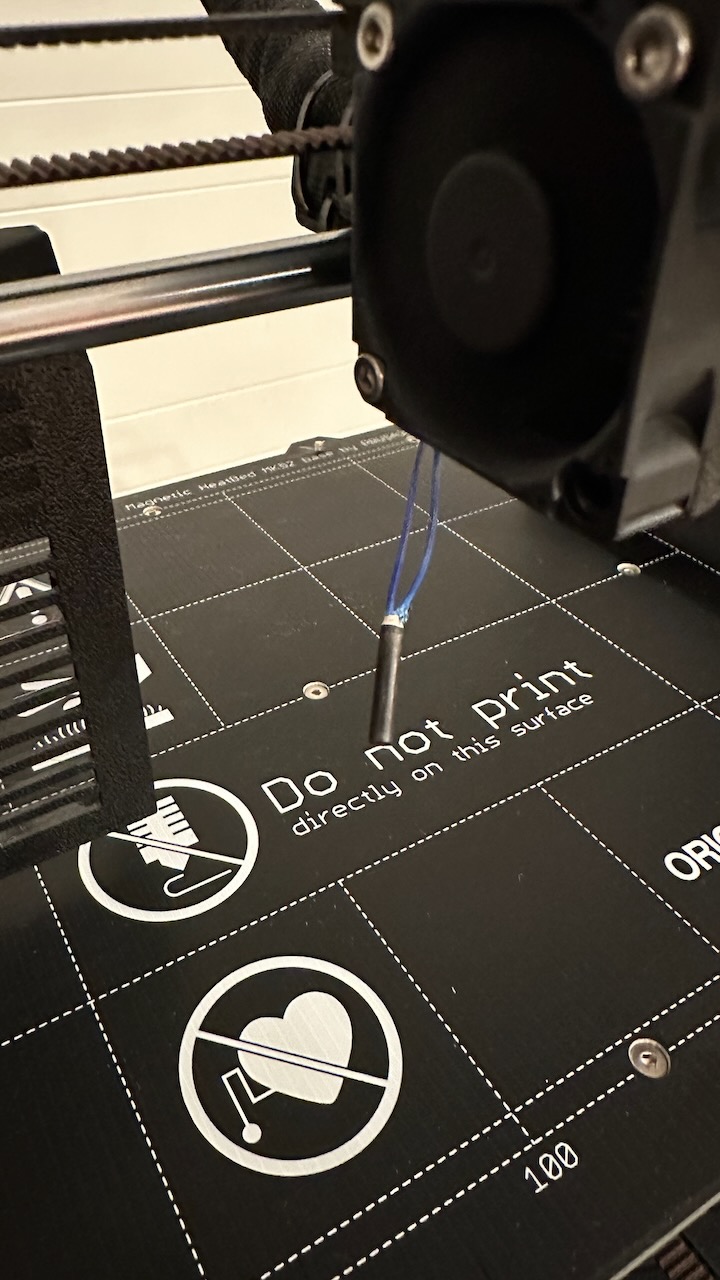

Moving to the main issue, the printer is now putting itself in "Thermal anomaly" few seconds after boot time as it sees a nozzle temperature ~185°C (readings are not stable). The nozzle is cold as it had no time to heat anyway (and no command was sent to do so). Obviously I cannot launch any prints, the printer is beeping very aggressively non-stop (along with the error message on the LCD screen). I've checked the hotend thermistor with a multimeter, by removing its connector from the board, measurements seems fine:
  • in very cold water readings are above 200kΩ (ice cubes added to the water)
  • around 125kΩ in ambient air (~21°C in the room)
  • below 80kΩ if I press it between my fingers
While taking the measurements I've moved its cable just in case there was some shorts, nothing. I've also upgraded the firmware to its latest version (v3.14.1), no difference.
When it gets interesting is starting the printer without the thermistor connected to the board does not change anything! Readings are still high and the same error / bips happen.
My conclusion is that was the board is somehow "damaged" and should be replaced but I could be missing something. Is there anything else I should check?
Thanks a lot for your help!
Photos of the readings (taken in the garage, ambiant temperature ~12°C)
Posted : 16/01/2025 9:14 pm
