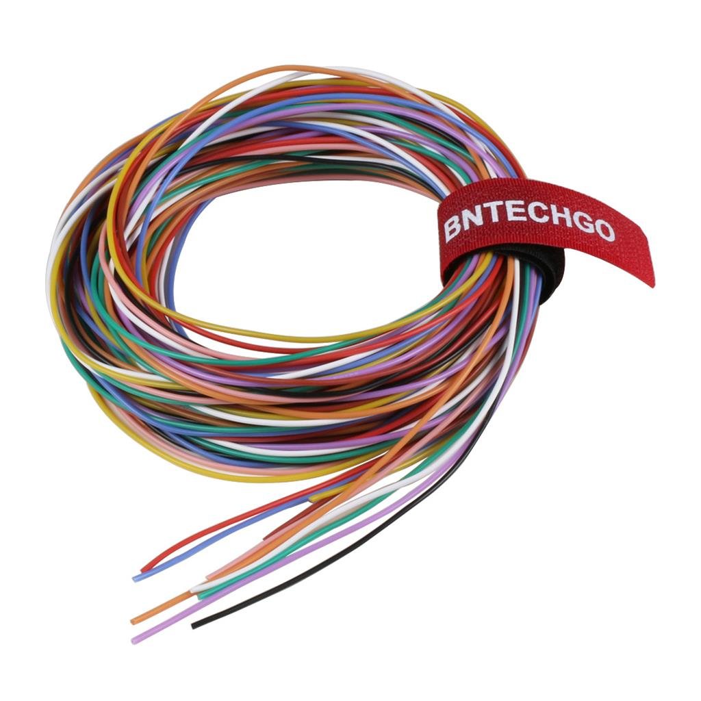

you may have an intermittent flex fault in the fan wire cable. at one year old I would consider that to be normal wear and replace it but You can try the chat support to see if they will send a replacement... or you can do what some of us doo and replace the wiring with high flex silicone insulated wire this is the size i used for the fan cables the offer it from 10gauge to 28 gauge I used 14 gauge for the heater wiring for example
https://smile.amazon.com/BNTECHGO-Silicone-Flexible-Resistant-Insulation/dp/B01M5EY57C/ref=sr_1_9?crid=2C20GKFJ1IB7U&keywords=high+flex+silicone+wire&qid=1554827541&s=gateway&sprefix=silicone+high+fl%2Caps%2C187&sr=8-9
