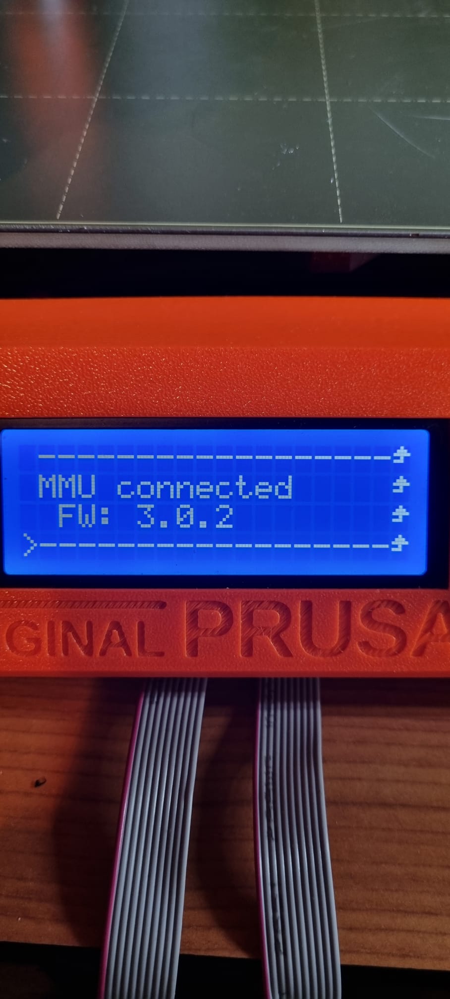

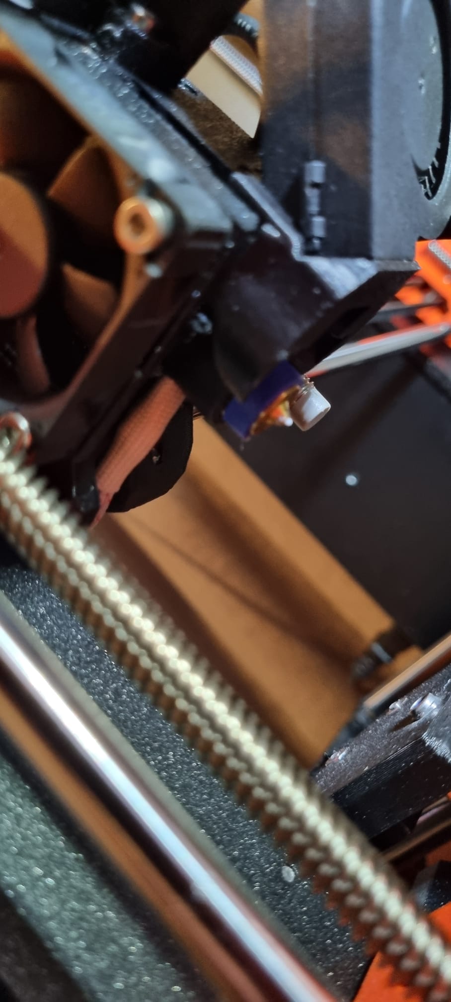

I bought a second hand MK3S+ with a MMU2S and added the e3D Revo.
I updated the firmware on the MK3S+ and the MMU2S.

Tried some thing to make it work.
But every time I try to start to make a print the printer saids "G-code sliced for a different printer type, continue?"
I have tried to: switch MMU on and off inside the printer settings.
Tried the slicers seen in the following screenshot.
But still with no succes.
Does someone know what i should try next?
Thank you in advance.

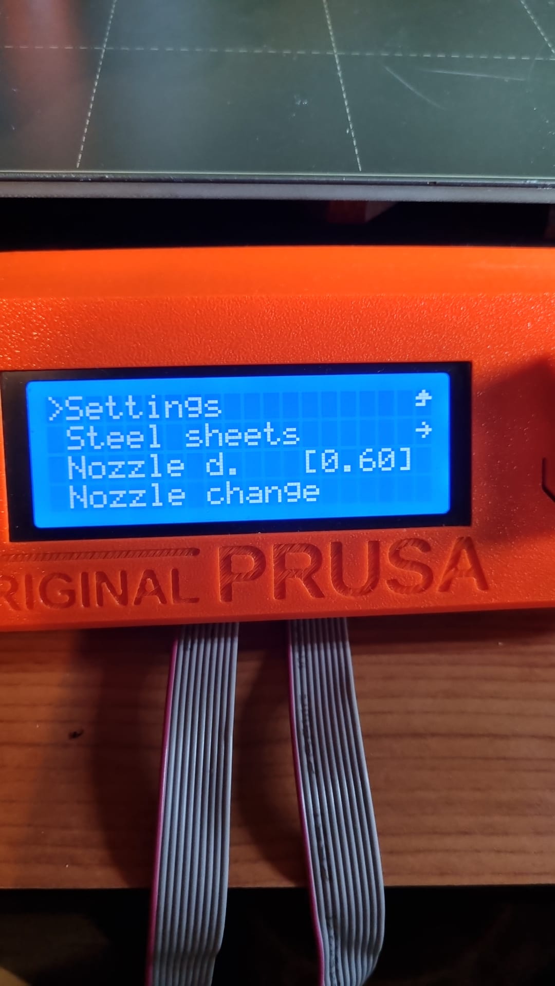

do you have a 0.6mm nozzle in the printer?
Nozzles should be colour coded

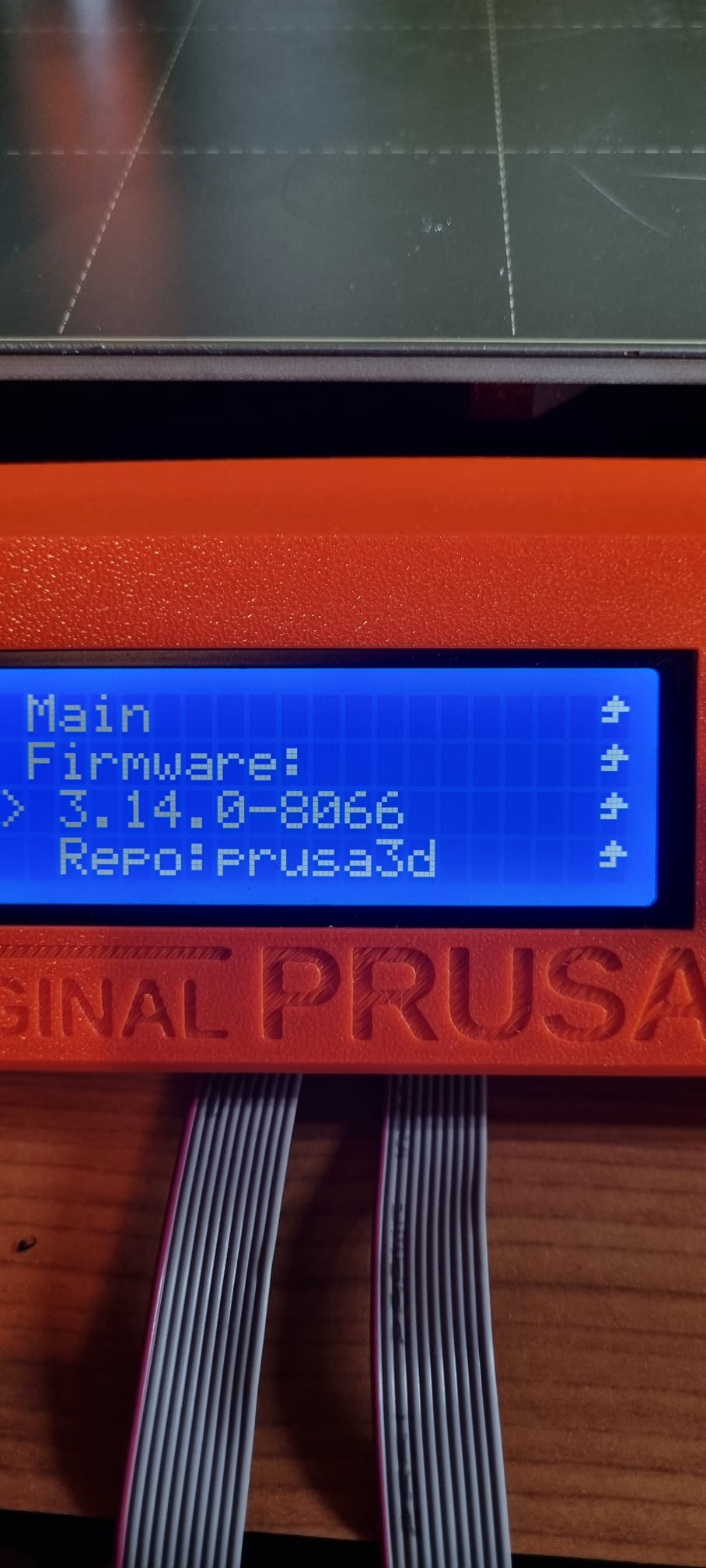

is the printer firmware set to 0.6mm nozzle?  LCD Menu
what firmware does the printer say is installed? Lcd Menu

Hi Joan,
Thank you for your reaction.
I have the following settings and nozzle installed.
Posted : 26/08/2024 7:00 pm
