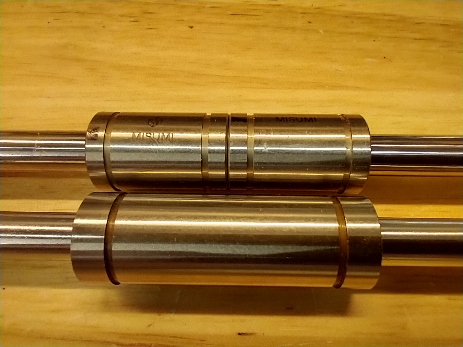

X Rail Update!
Found this longer bearing that I've used to replace the 2 separate bearings. The replacement has 2 bearing races in the single housing. It has a slightly shorter overall length but still zip ties in place with zero modification. I believe the original gouging issue originates from the two original bearings being so close together, secured by zip ties at one end of each bearing and the cap. These factors make it very difficult to insure perfect alignment between bearings which would lead to binding and then gouging.
Found these on Ali-Express and the 2 bearings and 2 rods (giving me spare set) were Half  the price of the import charges that the DHL  tried to charge me for my prepaid, free warranty replacements! Jeeze!
My printer has been working accurately without any signs of rod gouging for 60 plus hours, I'm very happy with the printer now. I hope this economical fix helps others suffering from the Z guide gouging issues.
https://www.aliexpress.com/item/32261955374.html?spm=a2g0s.9042311.0.0.5b264c4dVaNb3s
https://www.aliexpress.com/item/32852974119.html?spm=a2g0s.9042311.0.0.5b264c4dVaNb3s
New upper X bearing
Posted : 17/11/2021 11:07 pm

X guide rail update
Since I have still seen people are experiencing upper "X" rod gouging I thought I should give an update.
I have had zero issues since applying the fix in my previous post.  I have racked up at least 200 more hours since the last post and my prints (and the replaced rod) are still flawless.
I recommend this fix to all who experience the "X" rod grooving issue!
