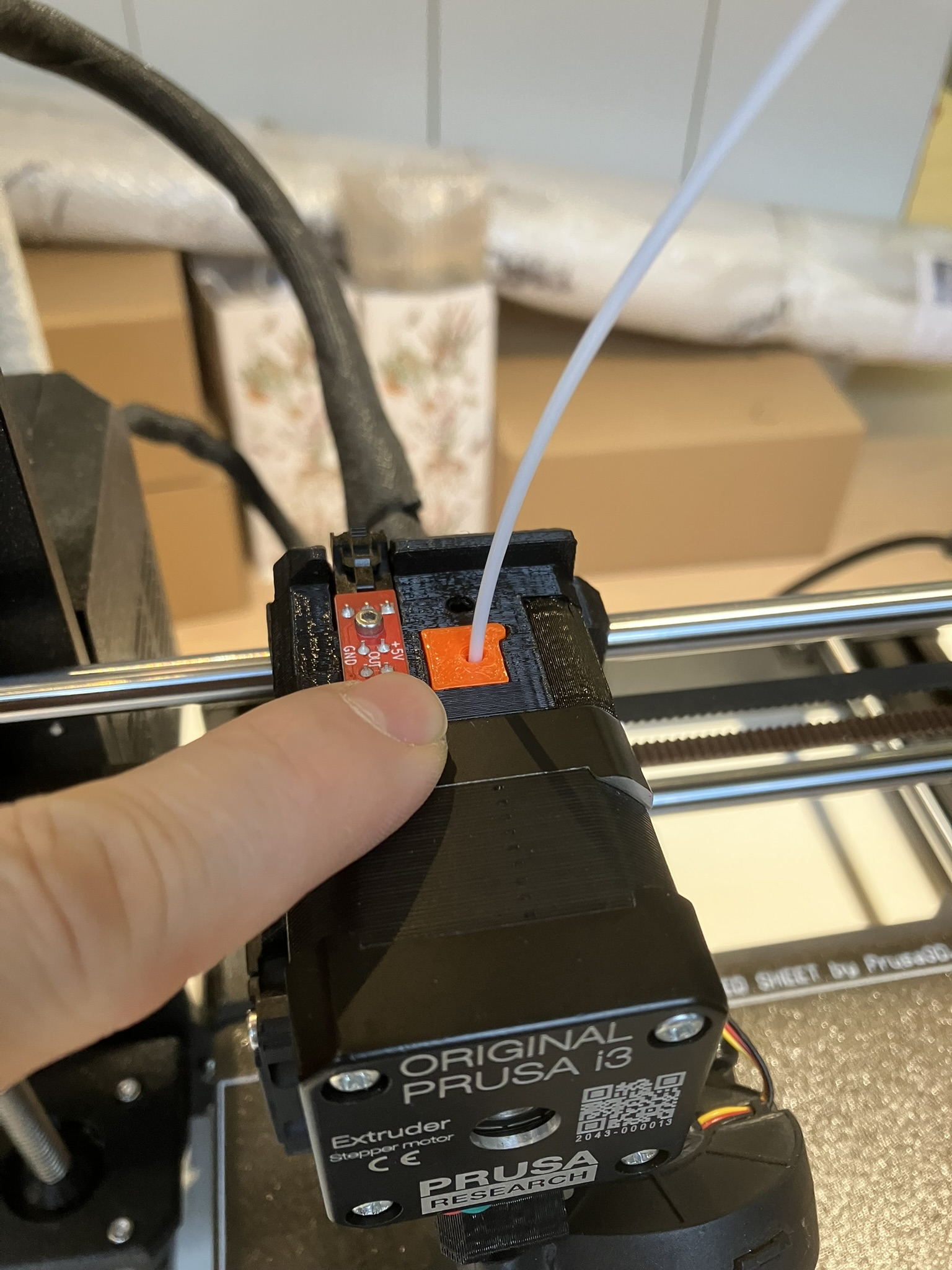

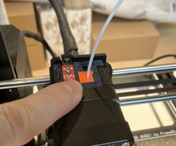

Aleks
(@aleks)
RE: missing unload filament prompt
To me Unload fillement dissapeared when I replace the old piece (black with metal ball) with the orange new one recomended by Prusa
With FW 3.14.0 and newer the Load - and Unload filament menu are shown depending on the state of the filament sensor.
When the Filament sensor detects filament, the Unload filament menu is shown.
When NO filament is detected, the Load filament menu is shown.
This was implemented as some users reported false actions, probably slight turn of the knob during pressing it, and the filament has been unloaded instead of being loaded or the other way around.
At this moment you can get both menus shown when you disable the filament sensor.

Bedankt 3d-gussner, ik had ook het probleem met het menu Unload filament. Met het disable filament sensor zijn beide unload- en load filament  weer aanwezig.
Thanks 3d-gussner, I also had the problem with the Unload filament menu. With the disable filament sensor both unload- and load filament are present again.
