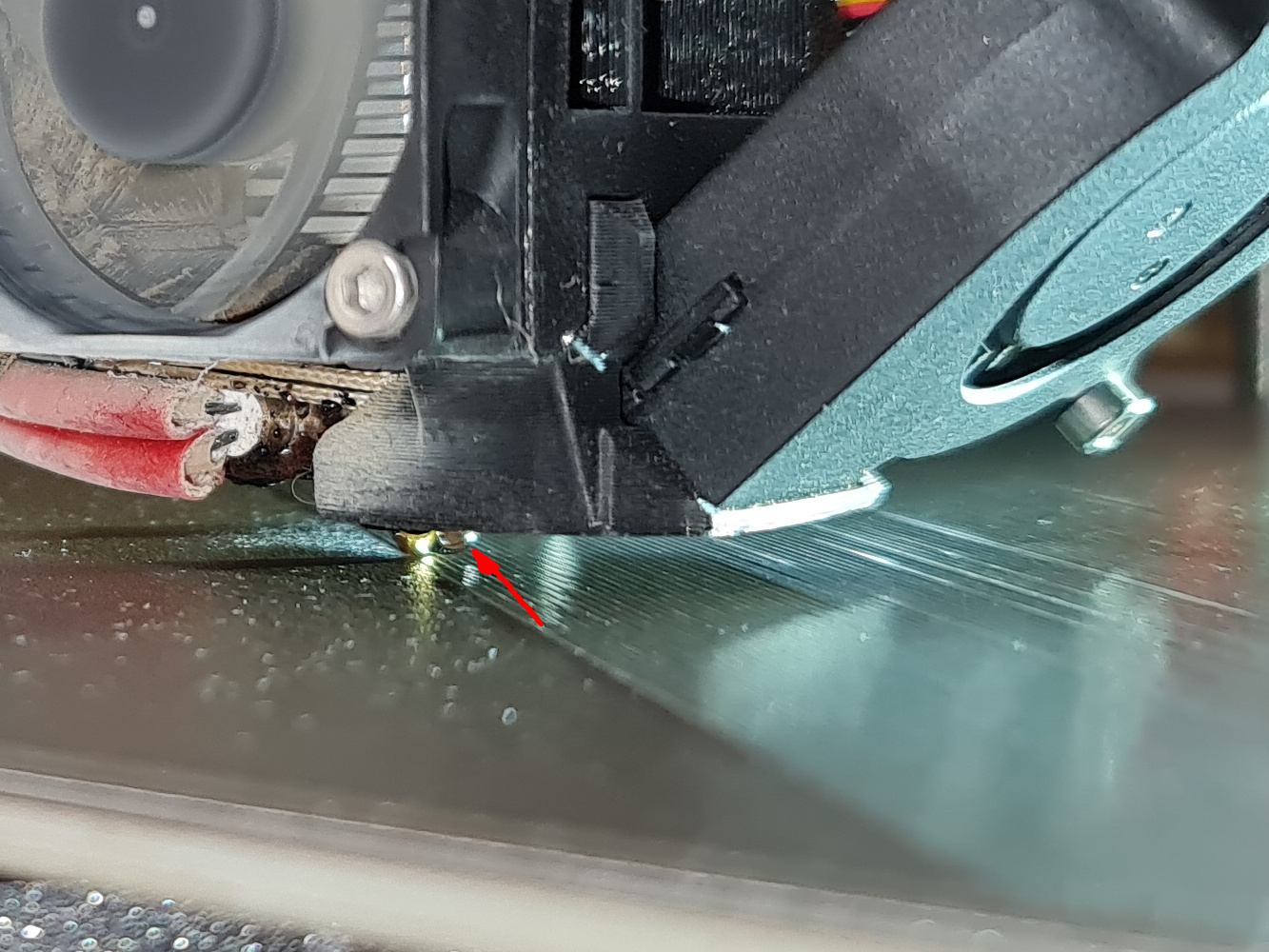

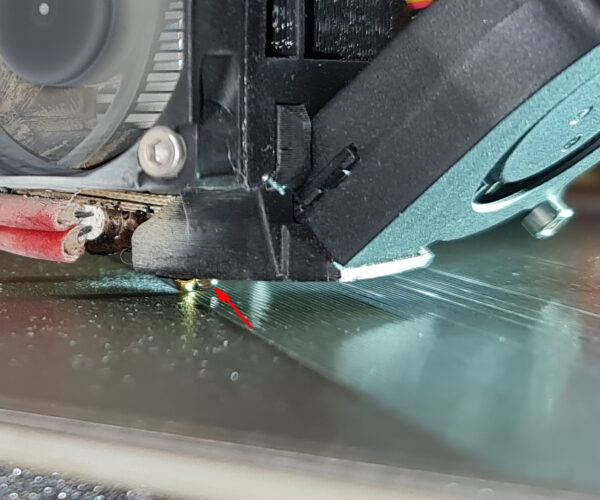

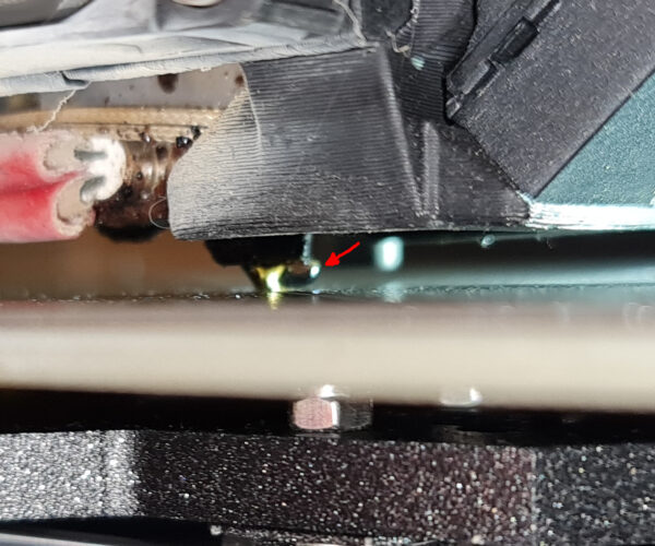

Hi All.
I'm printing with an i3 MK3S which I purchased last December. It was performing flawlessly up until about a month ago when I gave it a servicing (lubed all smooth rods, bearings etc, checked all nuts and bolts for tightness, and ran the calibration wizard again). After that I started having major problems with large globs of material being deposited on the print at random intervals. Of course the next time the nozzle comes around and hits a solid glob of material things go bad very quickly.
I've done numerous cold pulls, cleaned the outside of the nozzle very carefully, and used the aqua puncture needle to try and clear any blockages that might be in the bore of the nozzle, but the globs still get created.
What appears to be happening is that melted filament is building up on the outside of the nozzle. It slowly builds in size until it gets so big it catches on the print and falls off onto the print surface. I have no idea why this is happening and would be grateful for any advice on how to fix the problem. I've attached a couple of pictures showing the glob forming on the nozzle. Apologies for the quality but it is quite difficult to get a good picture.
Finally, please note I'm printing in tranparent Prusament PETG, using default Prusa Slicer settings. Any help or advice would be greatly appreciated.

From what I was able to observe the globs were forming by excess plastic being brushed up onto the side of the nozzle where it slowly accumulated to form a glob of melted material. Also the side of the nozzle on which the globs formed changed to the opposite side each time the print direction changed. I didn't see any plastic dripping down from where the nozzle attaches to the hotend or heatbreak. So my current theory is that I have the first layer Z calibration set too low and the nozzle is effectively scraping material off the print onto the side of the nozzle - a bit like a snow plow. (Though I'm not sure why globs would continue to form to a lesser extent on layers 2, 3 and 4).
I will be recalibrating first layer and running an extensive test to see if my theroy is correct, but it will be a few days before I can get around to that due to other commitments. In the meantime I'd be interested to hear what you think about my theory.
