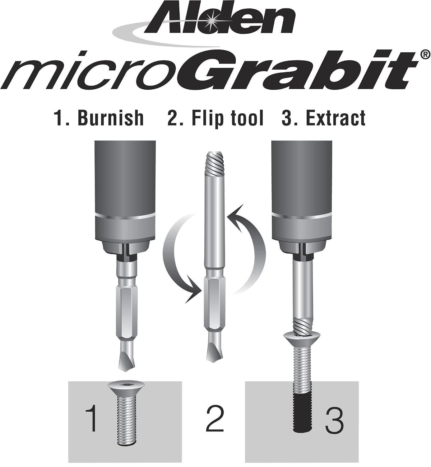

If you have a standard Grabit set that is what happens... you can't use the smallest #1 of the standard set even though it looks like it should work; you need this micro set for something as small as a 3mm hexhead countersunk screw as used on the heat bed

you are very close to properly drilling out that broken screw.... if you decided to get a Micro GrabIt set then use it with the smallest or next smallest size and it should come right out
if you just want to get it out with out getting that set then keep going with a 2.5 mm drill or a number 40 drill and with a dental pick get any remaining threads in the hole out. then take a 3mm x .5 tap and clean up the threads if you have to go up a size let us know what size drill you had to use to clean out the hole and we can advise. but this way you will need those sizes of drills and then the 3mm tap as well which will cost as much as the Micro GrabIt and these gadgets are some thing that get used with all the modern gadgets that use the tiny fasteners.

Nope - that's the one I used. Well, I tried others too, but I've tried the smallest and the one above it (M2 and M3) of that set, and it never gets traction or the screw is set too hard for the little traction it gets for it to work.
