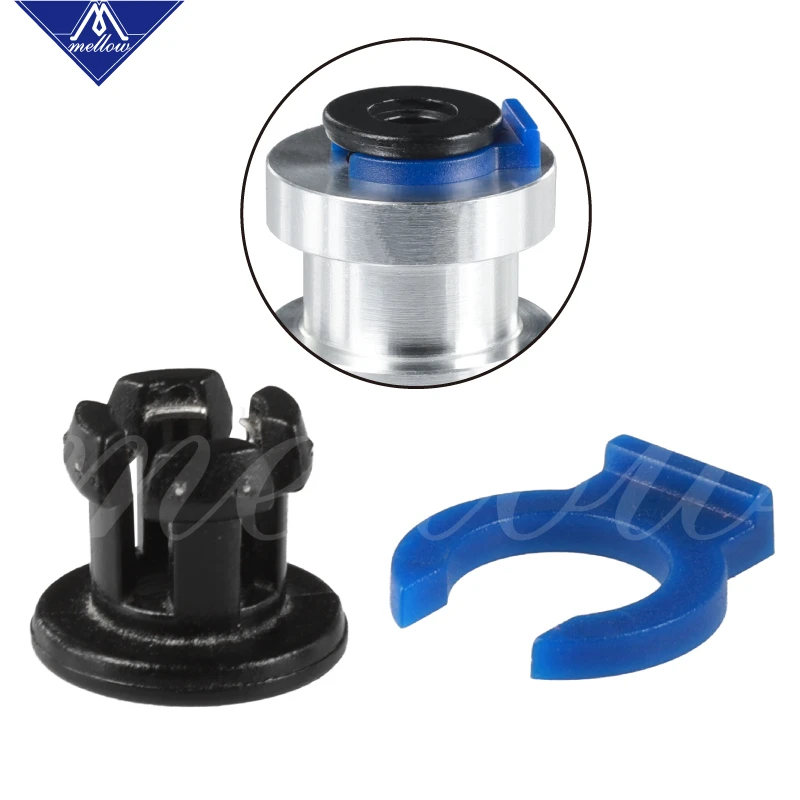

Lichtjaeger
(@lichtjaeger)
RE: Heatsink&Nozzle Leakage
Are you talking about that thing?
Posted : 23/11/2021 10:26 am

BogdanH
(@bogdanh)
I'm glad you managed to get printer working without collet -even I see that as temporary solution. Some explanation:
Collet isn't just something that closes the gap between PTFE tube and heatsink. It's main purpose is, to prevent PTFE tube move (vertically) out of heatsink. It is very important, that there's NO gap at the bottom of PTFE tube. That's also the reason why PTFE tube has chamfer at the bottom.
If you take closer look at collet, you can see that it has four metal blades inside:
When collet is inserted into heatsink, you can move PTFE tube up and down. But when you pull out the collet and fix it with clip, then blades prevent PTFE movement.
In short: you can print a collet imitation, but it's useless.
[Mini+] [MK3S+BEAR]
