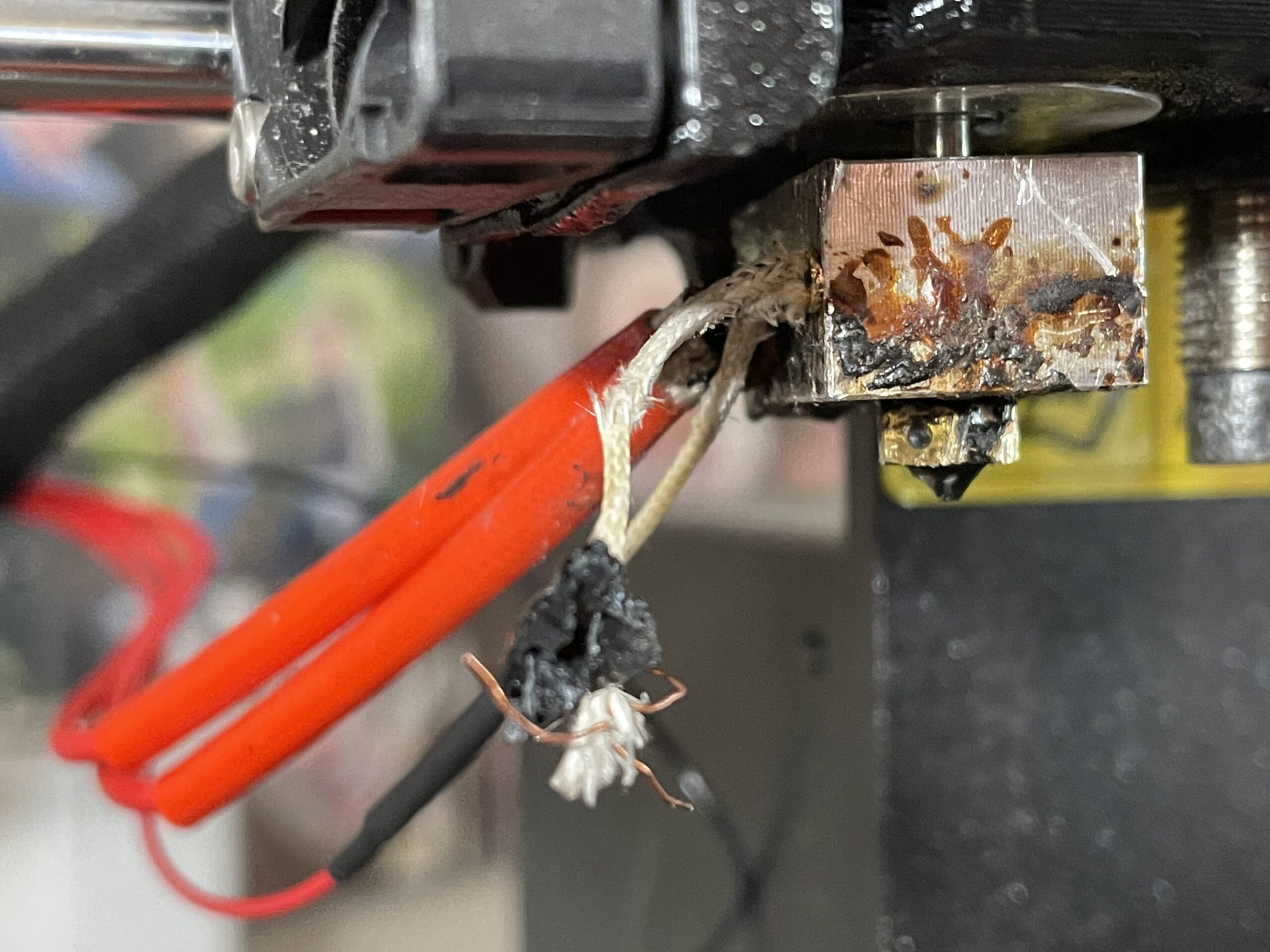

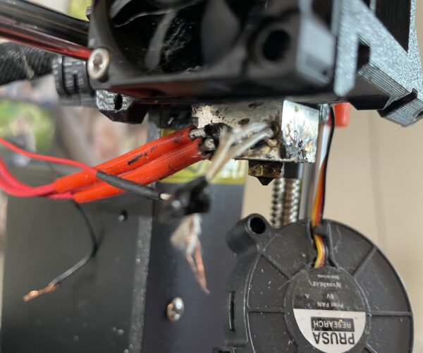

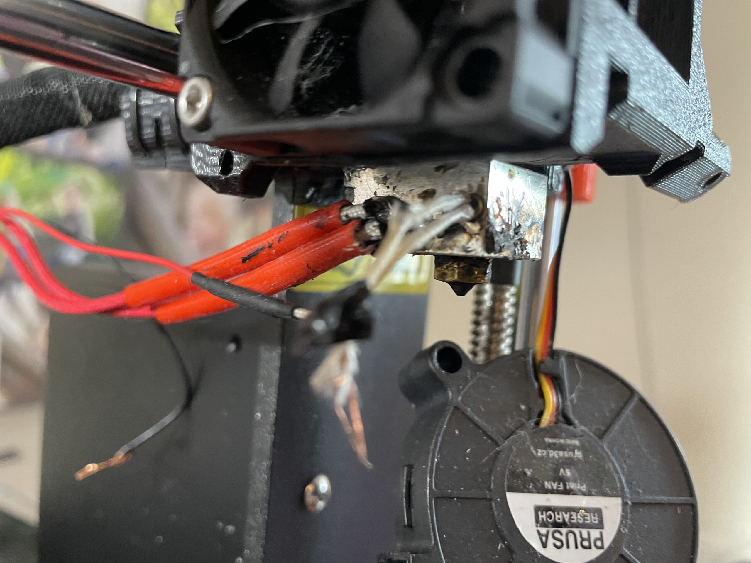

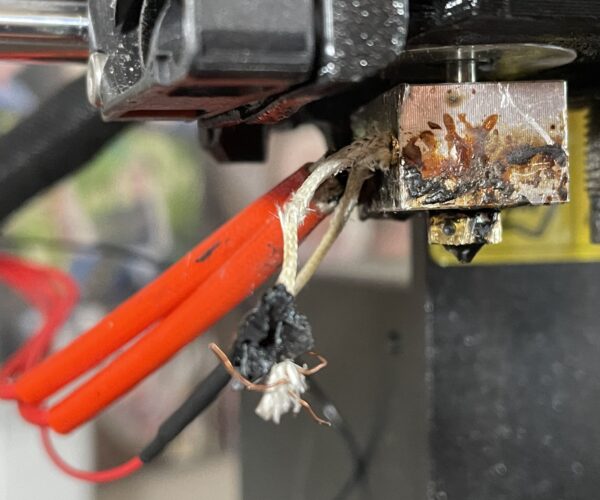

Update… Do I need to replace the whole hotend?
Cleared away all the plastic “slag”.  Now the head of the hot end rotates freely (don’t think it’s supposed to do that.  Also, I can really figure out a way to get the old hot end thermistor out of the housing.
Harumph!  I think I might have to replace the hot end entirely.  Pics attached.  Let me know what you think.
Not sure where to go from here.

Possibly, best be prepared to do so
You'll have to tear it down far enough to remove the hotend assembly and inspect it. There are grub screws for the heater cartridge that need to be cleared. It's common for grub screws to be caramelized in, thin wires to break, and threads to be stuck on delicate parts. In short, be prepared to replace everything BUT the heatsink and PTFE tubing. I'd keep spares on hand for:
  • Thermistor (Get Prusa version with long leads)
  • Heater cartridge (Get Prusa version with long leads)
  • Heater block (possible upgrade to E3D nickel-plated copper)
  • Heatbreak (possible upgrade to smooth E3D titanium)
  • Thermal paste (ONLY for top of heatbreak interface to heat sink)
  • Silicon sock (non-Pro, big nozzle hole version)
I think that's everything. I was out about $80 as I recall.

Tre front done fell off.
Thanks again for the good info.
I got the assembly broken down.  Unfortunately, in the process of removing the leads for the wires (which were “caramelized”) I destroyed the heat sink.  So after considering options and budget, I ordered an complete hot end assembly, plus an idler spring (which was abducted by aliens sometime between disassembling the housing and bagging everything up for safe-keeping).
I’m very glad that I purchased the kit vice an assembled model, else I would have been much more intimidated in undertaking this repair.
