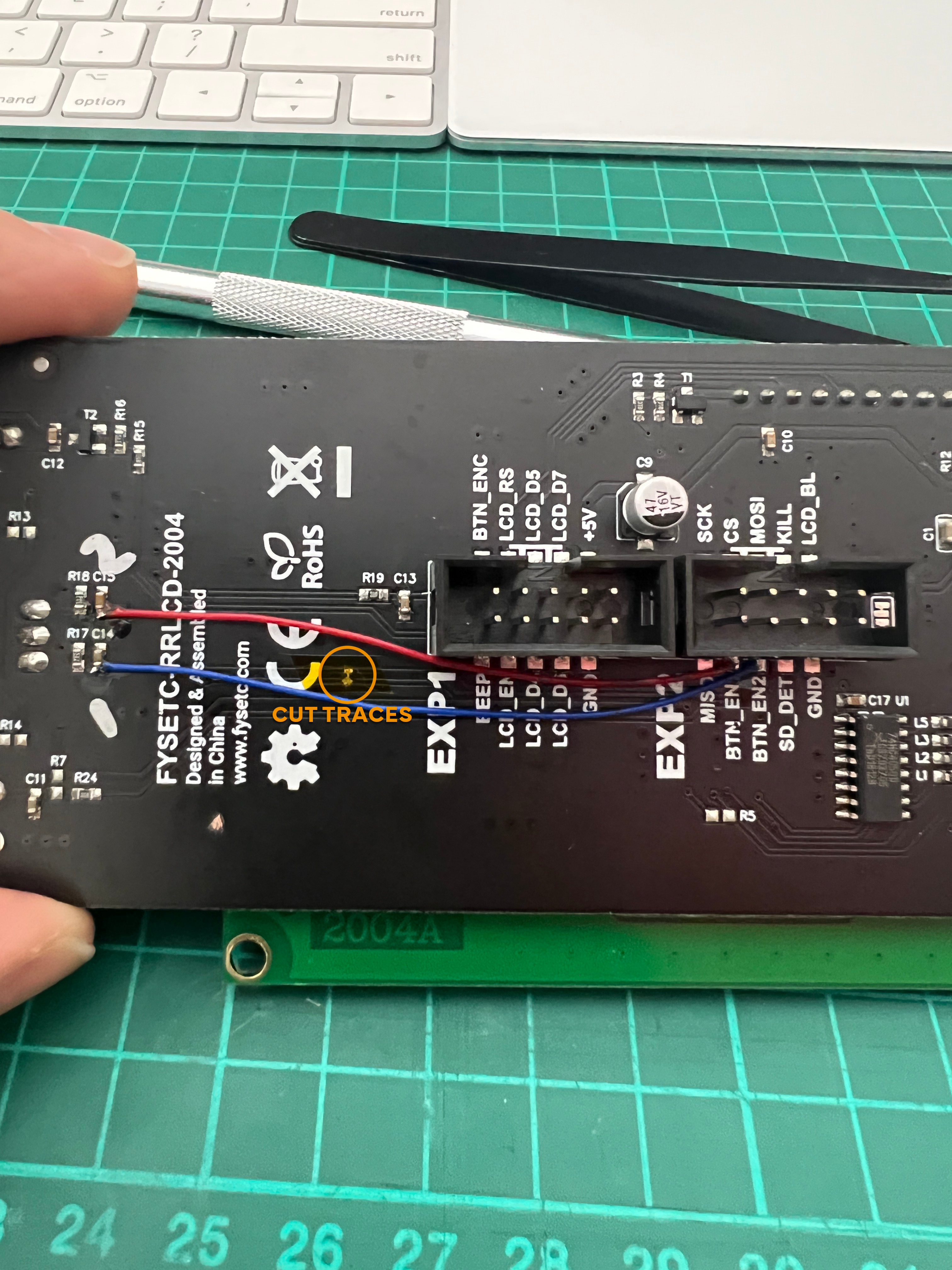

I couldn't figure out how to change the pins in the wires (lol) so I just modified the PCB! I figured out that the pins that need to be swapped are P2-6 and P2-8 on the board side (BTN_EN1 and BTN_EN2 on the LCD side). I just cut the traces on the board and added a jumper wire from the pins the resister.
Here is a link to where I found the button pins: https://forum.repetier.com/discussion/5630/einsy-rambo
I honestly think this is a better solution than messing with the wires or firmware. Now all my clones match my original Prusa machines!! Yay
