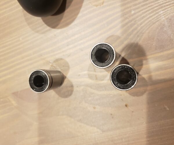

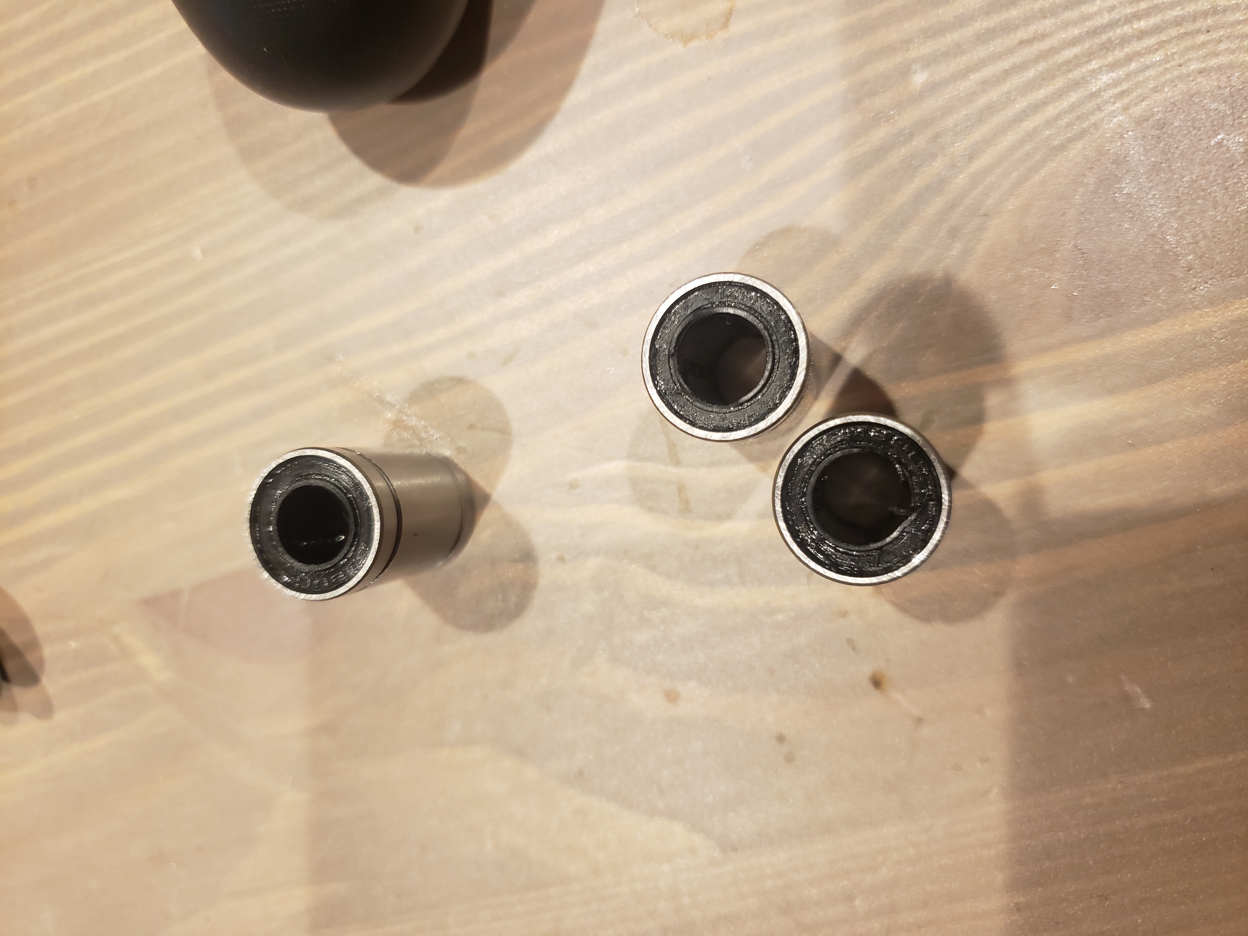

Regarding the axis. Ive had time to break down the printer some and began checking a few things out. Strangely once i took the motor off i did not notice any binding on the gantry. Perhaps my X stepper was overtightened, and over time caused extra wear on the bearings?
Below you can see the bearings removed from the axis. As you can see the bottom center one has a badly torn boot. This must be my issue, right? Worn X bearings?

Rails are good as far as i can tell. Ive rolled them on the table, they are straight.
Unfortunately some balls fell out of the bearings, now i need new bearings for sure.

RE: Can't print PETG without damaging bed, now X axis is shot?
The bearings are apparently shipped with rust protection fluid installed,  a number of the people who rely upon this as a lubricant, have problems some time aft building the printer, when the bearings start jamming.
I have always lubed my bearings and so far I have not had problems.
My last mk3 came with a small tube of Prusa branded, white lithium grease, so I used that on the build...
previously I have used Yellow LM2 Lithium grease on two printers, 'Slug Slime' Machine oil on one printer and white Lithium bicycle grease on the other printer, simply because they were handy at that stage in the build process.
there doesn't seem to be any difference in performance between them
