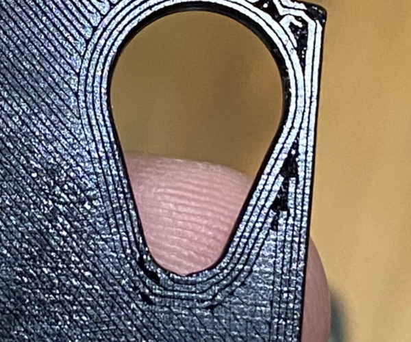

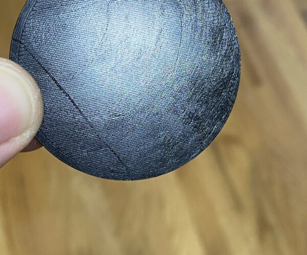

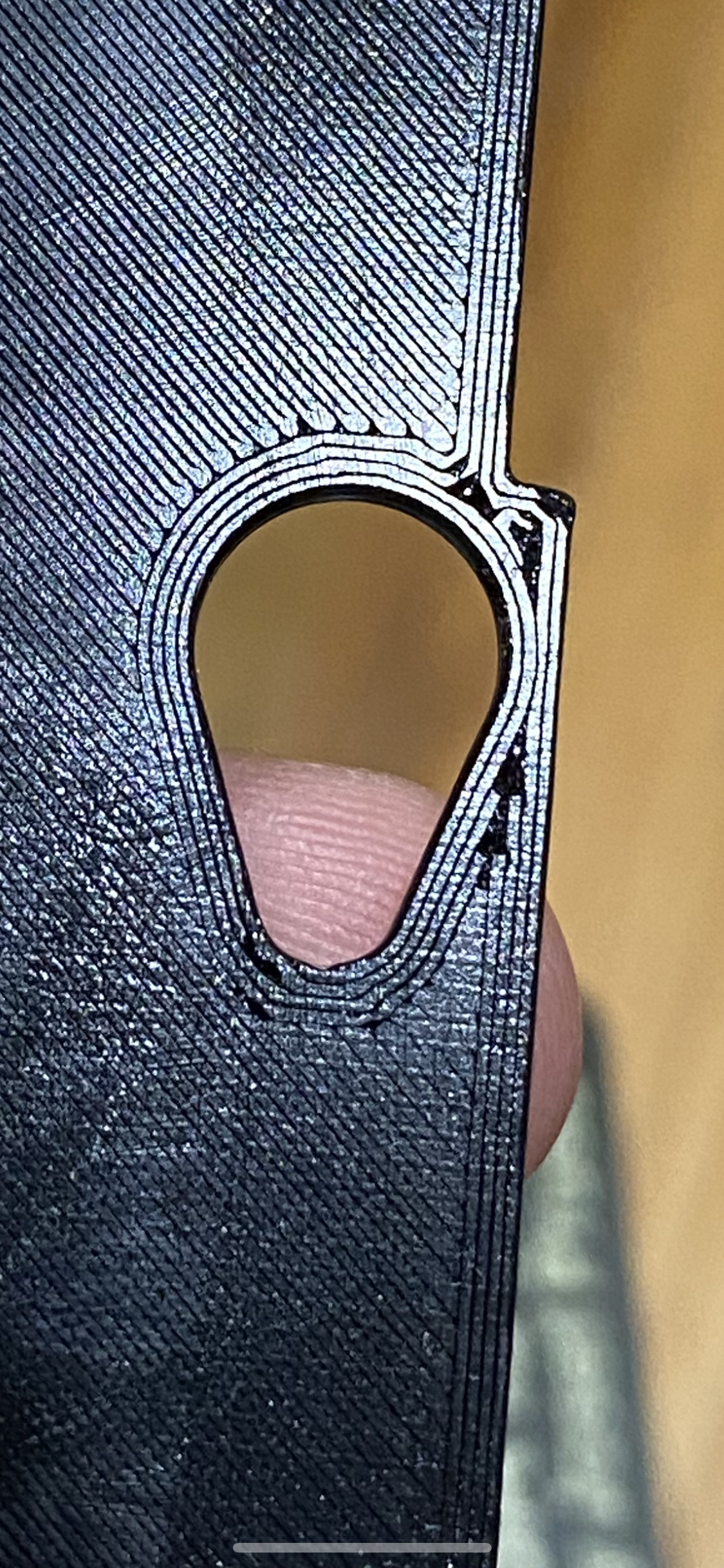

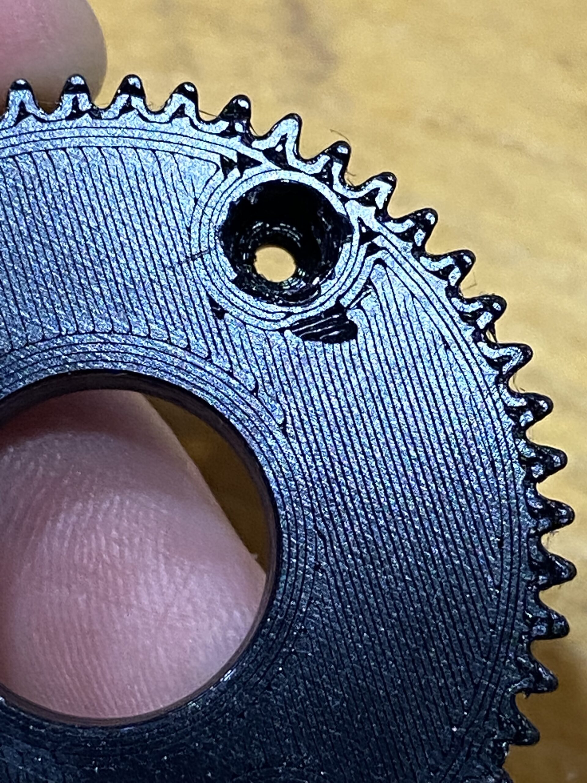

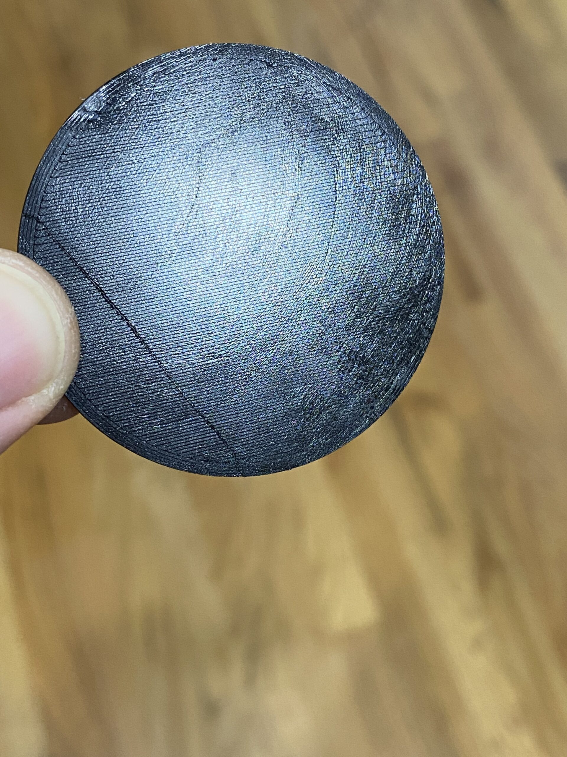

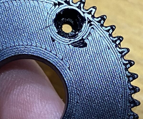

First time poster, new-ish to printing, apologies if this is in the wrong area.
I seem to be having random occasions of under extrusion on my prints recently and I cannot seem to nail down the culprit. I've had my MK3s+ for about a year and in the last 3 months the problem appeared seemingly overnight.
I replaced the nozzle, set a new first layer height, lubricated it, snugged up screws  and adjusted the idler tension per the support articles, it seemed to fix the issue in the first test print I did after adjustment but then it went right back to the under-extruded / pitted prints, mainly with the first layer.
I can print the same file multiple times, some will come out nearly perfect with minimal pits / gaps, others will come out with multiple pits / gaps on the first layer.
Similar results with two different factory fresh rolls of Prusament PLA.
Any suggestions or where else to look to nail down the issue?
post adjustment example 1 post adjustment example 2 post adjustment test

For some reason my images did not post in the original post, want to make sure I'm getting the terminology correct and I am actually experiencing under extrusion.
https://imgur.com/a/6HAvBEw
