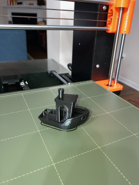

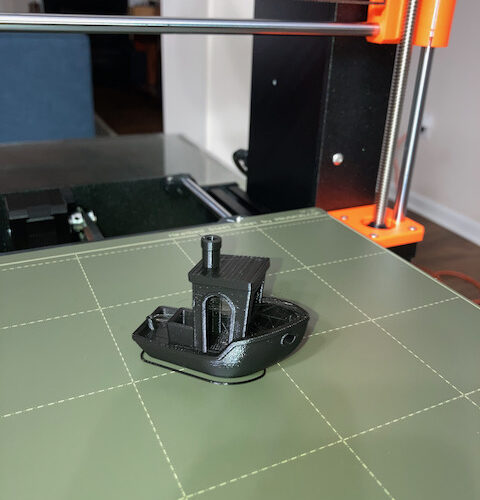

First calibration failed but after I ran the Z axis to the top and adjusted the Pinda probe it passed cal.  Just got done printing Boaty which came out nice.
Great kit, lots of fun and a high quality printer that works great by my estimation.   I'll probably mess with the Pinda and Live Z a little more but for the most part I'm in a good place.
Boaty
