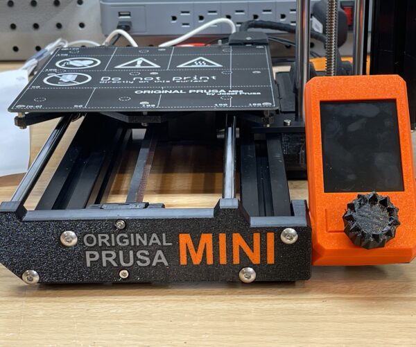

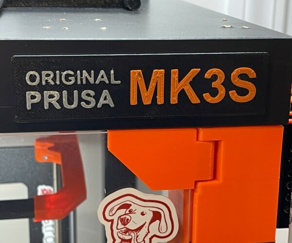

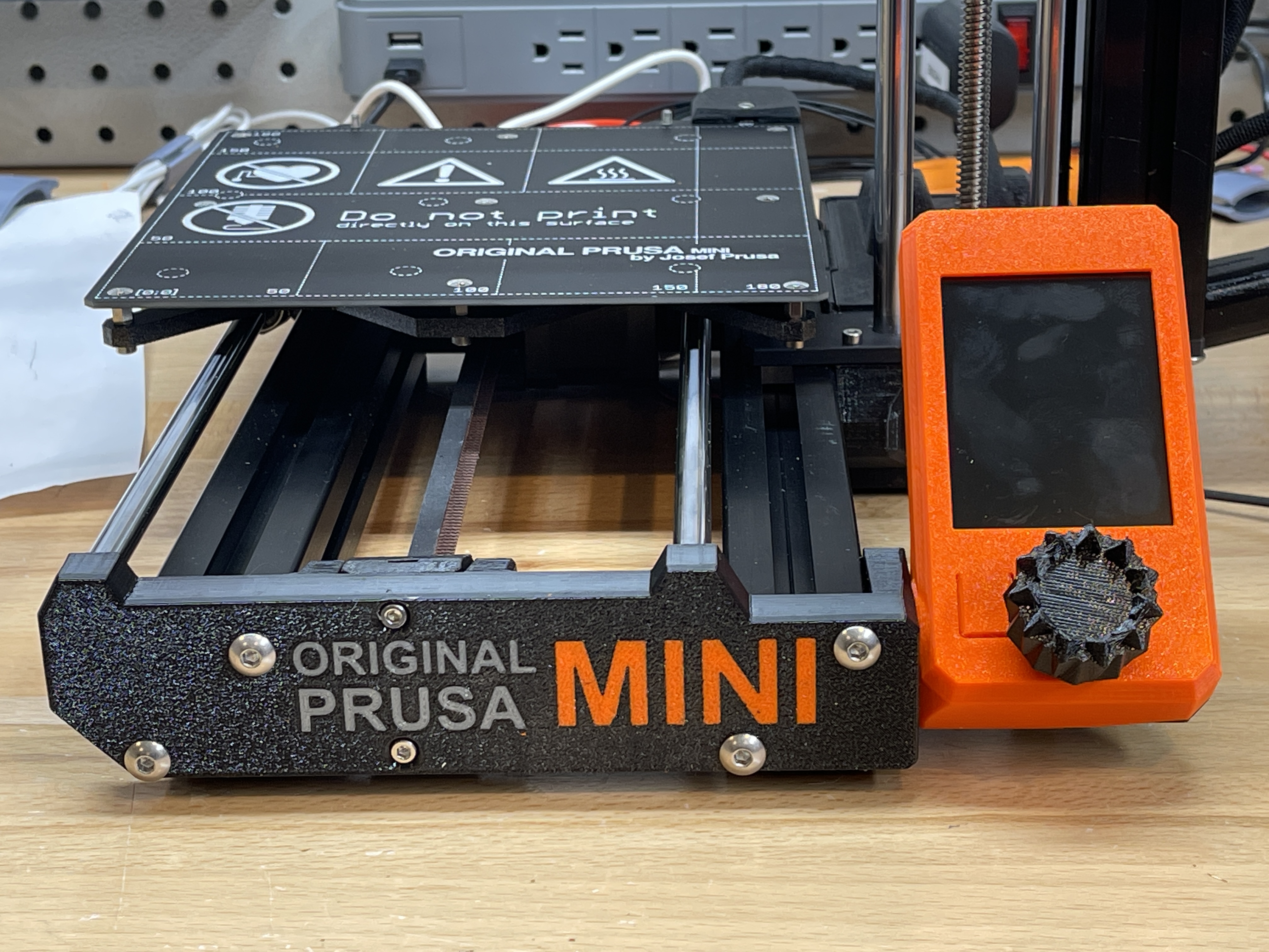

Here's an example of a manual filament swap at a certain height:
https://www.prusaprinters.org/prints/50534-prusa-signs-for-lack-enclosure
Or you can use the technique in here, for a two-color model that doesn't require the use of an MMU. If the accent color part is only 3 or 4 layers high, it's a manageable number of manual filament changes.
https://www.prusaprinters.org/prints/51471-dual-color-lcd-cover-for-mk3s-no-mmu-required

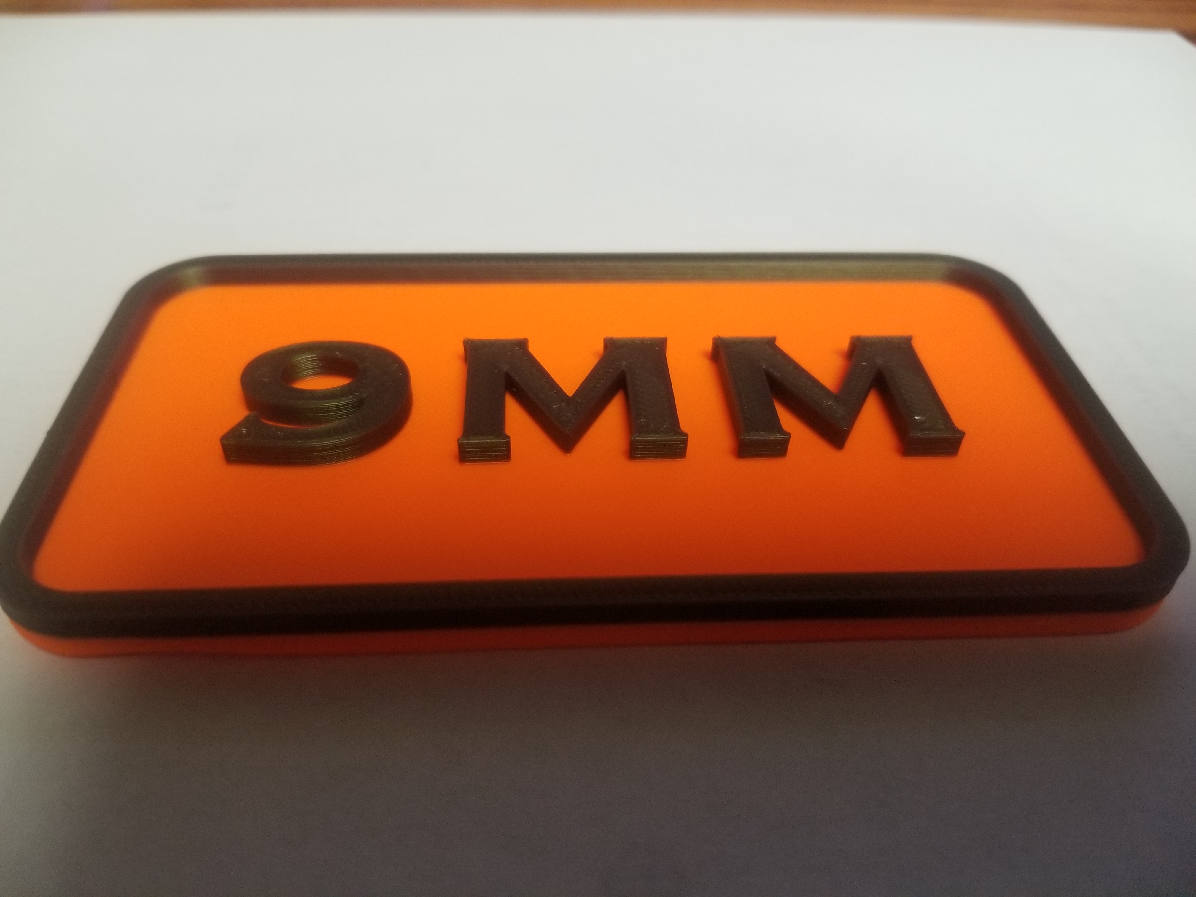

Hi everyone
I just drew up a quick name tag and I'm printing it now. I have to wait and see if i did this correctly. If it turns out Ill post a picture.
Thank you all for your quick and in depth response, You all are fantastic,
Thanks,Gary

It worked my first two color print. Thank you all for showing me how to accomplish this.
Thanks Gary
