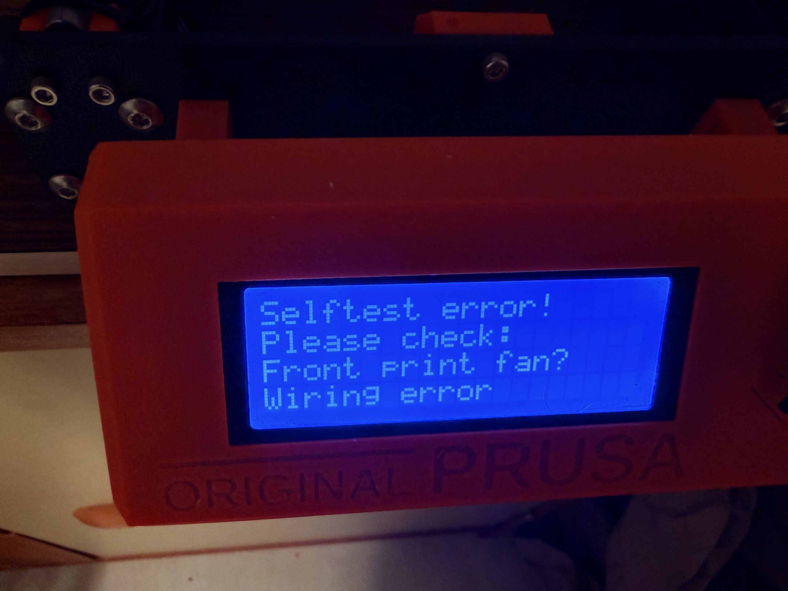

I we bought old mk3 for 100€ 😉
For simple prints would be ok I am guessing.

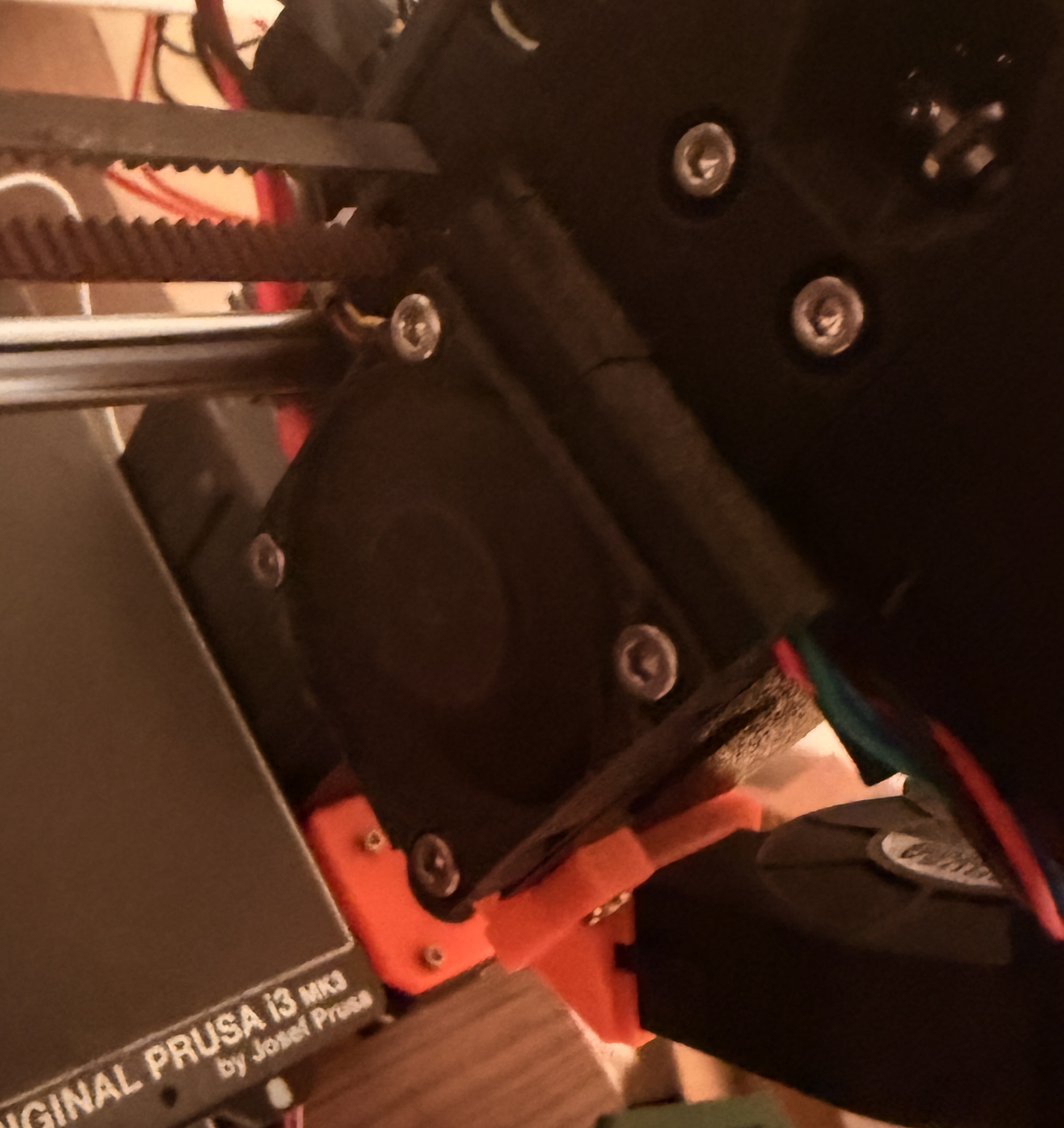

I need to do first wizard but printer send me error for both fans. But after pressing reset button, both fans work.
what should I do?
Posted : 24/11/2025 5:24 pm
Clean the fan blades.  Make sure there is no stringing/fluff in the hub, perhaps touch the hub with a cocktail stick tip dipped into light machine oil (pull back the sticky label on the back, re-stick afterwards.).
Check the fans are cleanly plugged into the Einsy board (pull and re-plug)  if still failing check for broken wires with a multimeter.
