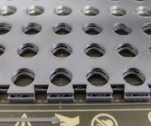

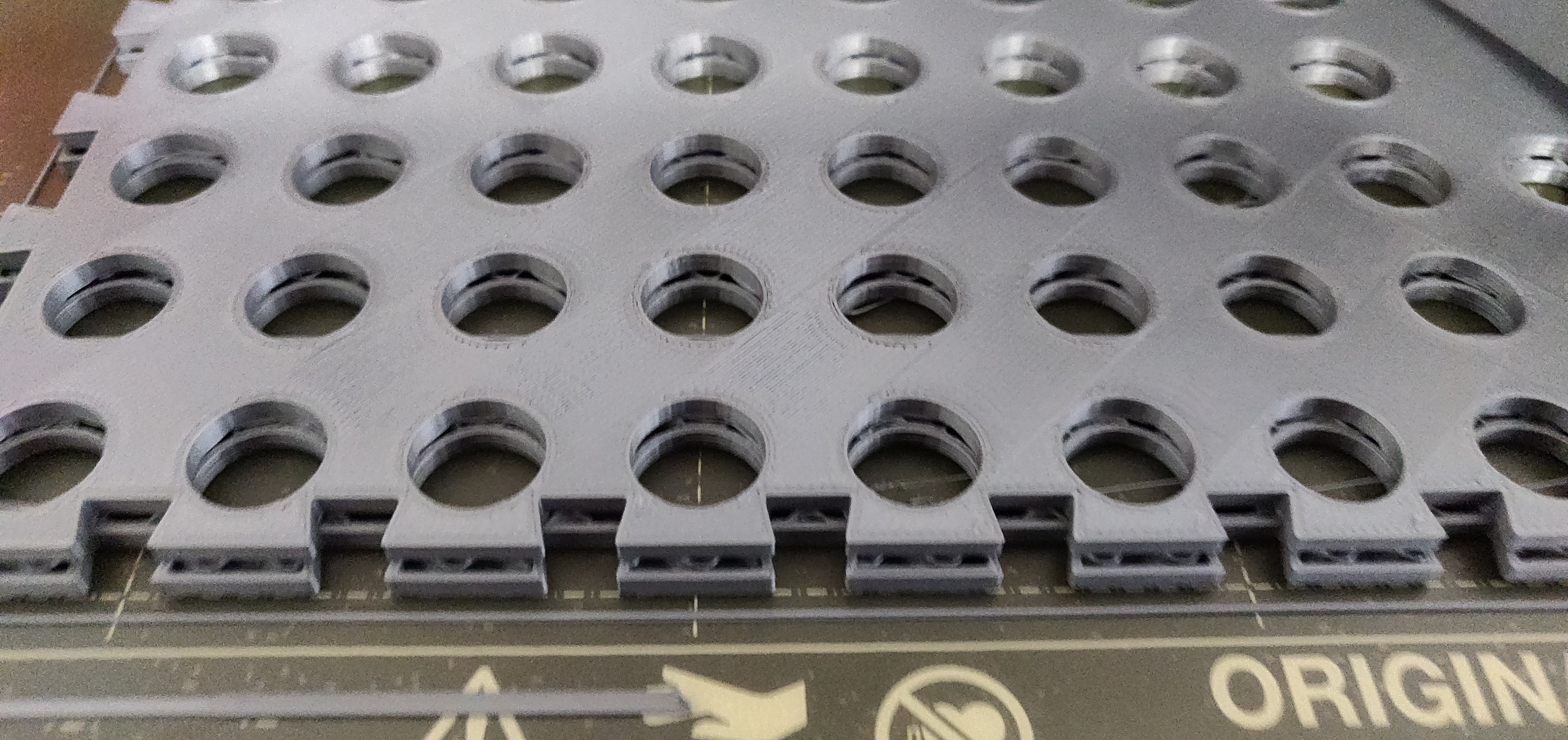

Over the last few prints, I am seeing prints that have the first few layers in one spot and the rest of the layers in another spot.
Can you please suggest what I can try to fix this?

They both only moved in the Y direction. Check the belt tension and check the grub screws in the Y-motor pulley.
The grub screws need to be tightened on the flat on the motor shaft first and then the other one. If you do this the other way around they will loosen.

In addition I would check the linear ball bearings for smooth running and lubricate them if necessary.
Here an article about layer shifting: https://help.prusa3d.com/en/article/layer-shifting_2020

Thank you for the quick response (and the pointer to the layer shifting issue). The Y axis tension was a bit low.
I have fixed it. Along the way I noticed that I had routed the heatbed thermistor cable to be between the bed and the rod holding the linear  ball bearings. So I opened the cable box and rerouted it come from below.
