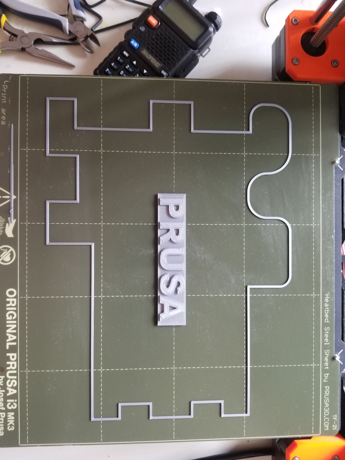

Update:
I got the printer working without any smoke or fire... Yet.
Some other calibration issues caused delay, but found tightening some loose Zip-ties fixed those.
After a few adjustment pains with the Z and getting to IR sensor height, I finally think I have it close. This was the first test print that actually stuck.
Thanks for the help with better images.Prusa test print Prusa test print

RE: Panic button connector orientation
@igmu
Yeah - life can be harsh. Maybe I had too many bullies attacking me when I was growing up -- or too many attacking me nowadays because I am color blind -- but sarcasm came to me naturally as a defense mechanism and I don't even know when I am being sarcastic.
Now that the manual has been read, and the wire plugged in correctly...
Your print looks good. Gratz - good first steps.
As a data point your print sheet should be clean; and not have any white film on it as your does. This contamination will haunt you if you don't learn to deal with it early on and correctly.
