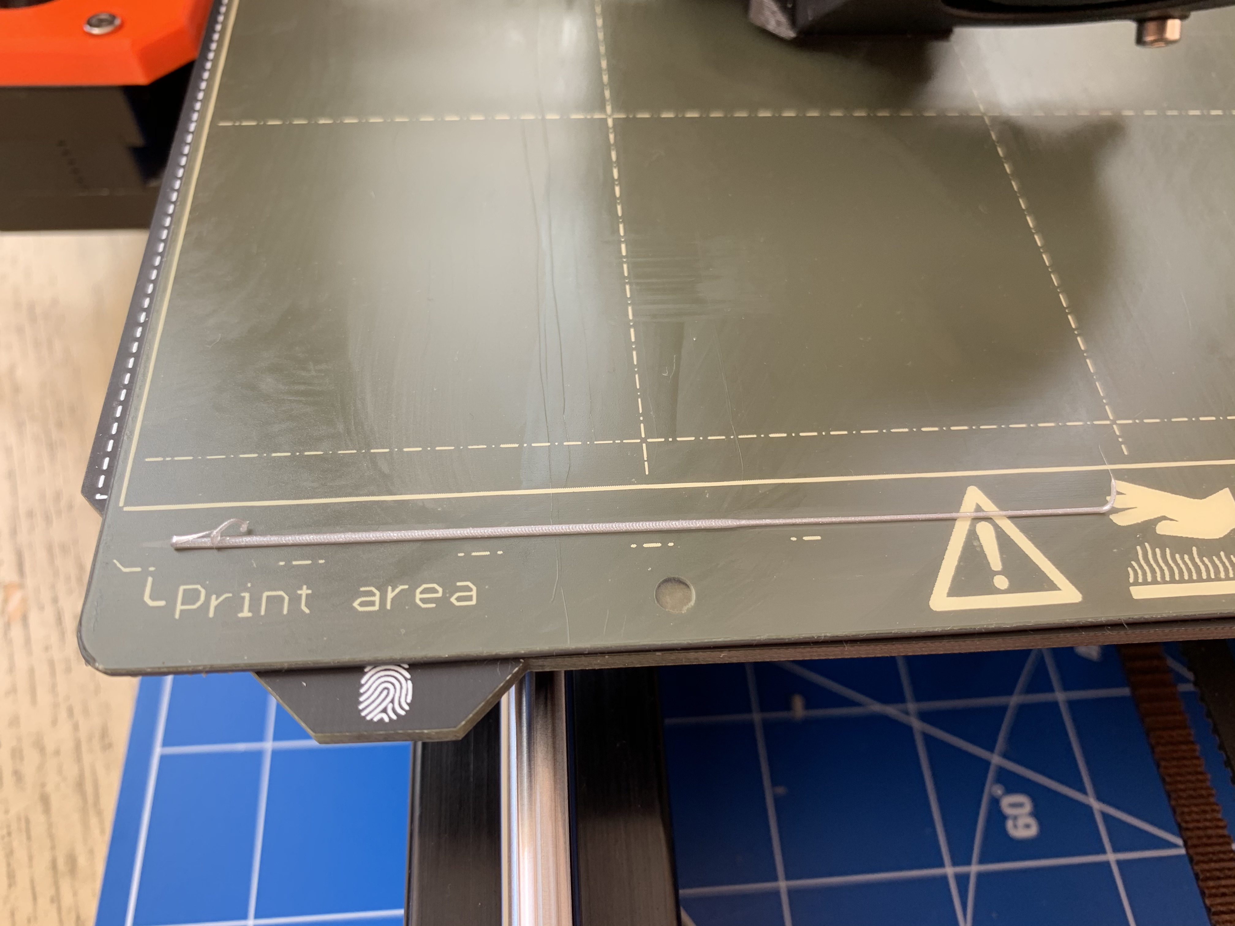

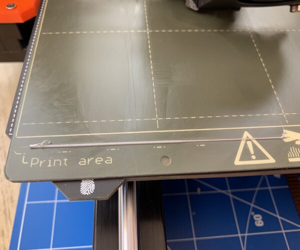

I am the same with a brand new machine, all the calibrations went through and all ok but I have exactly the same issue, and have done the same as the previous poster, please see attached my pics.
I have tried various heights from 0.6 to 1.1 but none of them stick at some point in the calibration process. I did have a bit more success this morning between 0.65 to 0.8 but none of the returns were square and once you got to the box to fill in nothing stuck and built up on the nozzle.
Posted : 05/06/2020 11:09 am

Hi
can you tell me what you cleaned the plate with? to me it looks like something has been left behind in the cleaning
as i have said in my last post, a good scrub in hot water.
i use IPA to clean, but sometimes i will use a good kitchen spray
from the photos, to me it still looks to far away from the bed
 the Z height is only a number for YOUR printer, i have gone from .7612 to 1.237, quite a change.
this was because i had it all in bits to replace a bearing on the X
I would try to lower the Z, i was in the same pace as you to start with i was afraid to adjust the Z even a small amount in case i messed up the printer some how, sill really!
once you become familiar with adjusting Z it makes life so much better, wish my Ender 3 had it it is such a pain to get that one right
Posted : 05/06/2020 12:03 pm
Andy Stuart
(@andy-stuart)
RE: Nothing wants to stick (brand new machine)
@graham25fox
Hi Graham, Since I posted those pics I saw your first post and have went and gave it a good clean as you mentioned but I am still having the same issues. I had given it a good wash previously, think what you are seeing is streaks from giving it a clean when the plate was still warm.
What is IPA? (apart from beer!), I noticed on another post somewhere or maybe online that methylated spirits cleans it as well so I was using that too.
I am still trying and lowering the Z very time, down to 0.850, now getting the first return sticking but when it gets to the second one its pulls it off again.
Posted : 05/06/2020 12:23 pm
