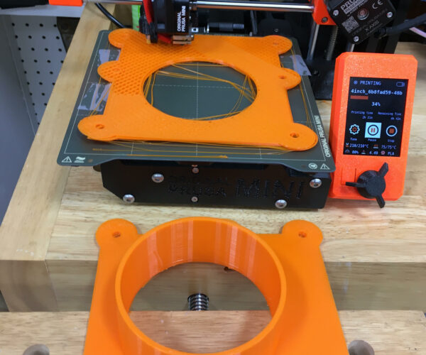

This series helper me a LOT! For months, i have been unable to get a large to stick. I was able to print only in the center area.
I slowed speed down to 80 and raised bed temp to 75, now printing large parts.
If I can attach an image it will show my results.
This is generic Overture PLA.

Mcdriver
(@mcdriver)
RE: not sticking to bed
printing large part Getting large parts to stick

bobstro
(@bobstro)
Posted by: @mcdriver
That looks like Scotch/transparent tape. The idea with blue painter's tape is that you lay down a layer for the filament to stick to. Here's a grab from a YouTube video showing it being applied to an older printer.
Looking at those extrusions being pulled across the circular cutout in your print, you've got other problems going on. Try a lower slowing down, increasing temp or reducing cooling, or using lower layer heights for that part of the print.

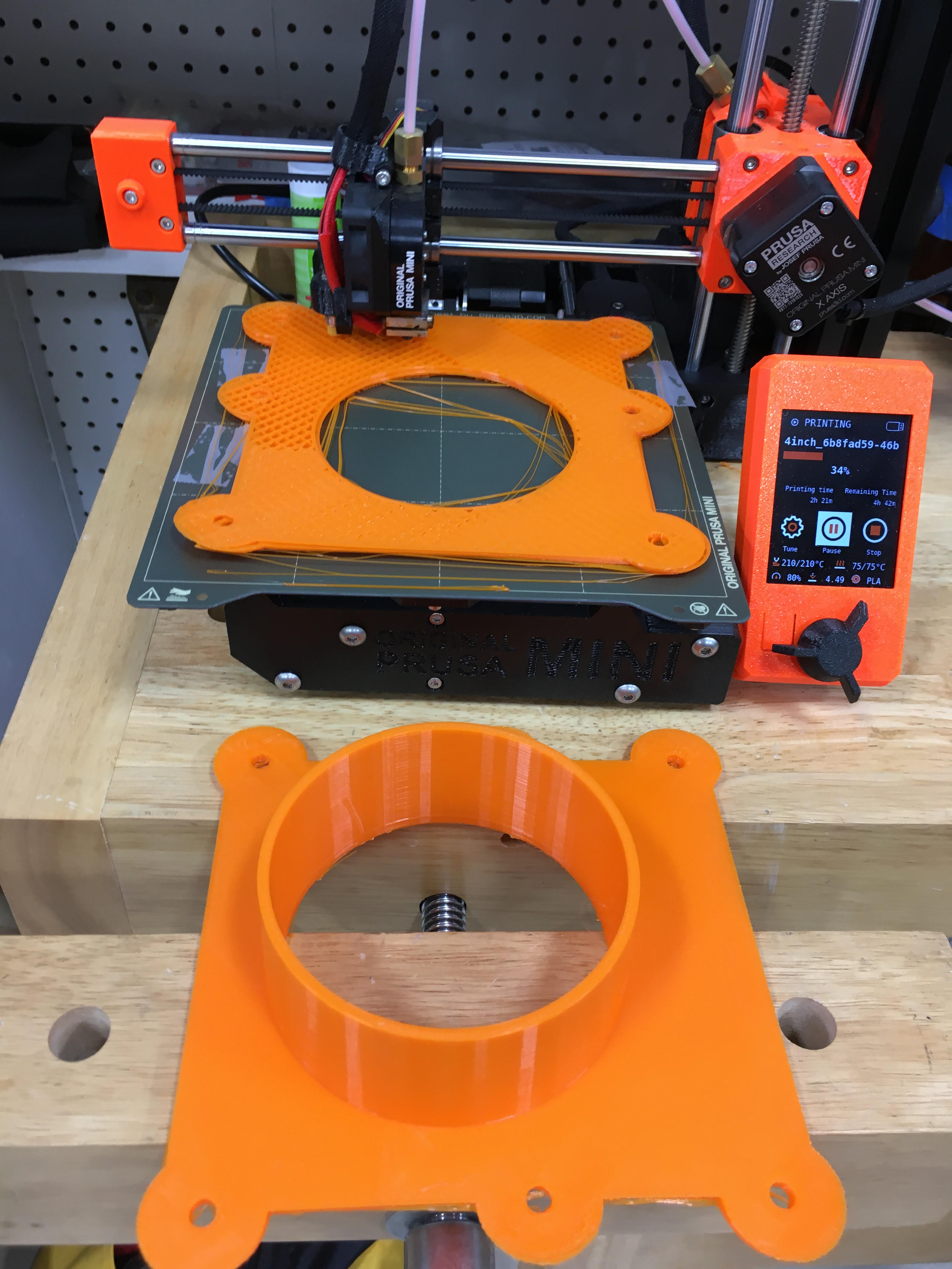

Mcdriver
(@mcdriver)
I have tried my Z height from 0 to -o.130, Maybe I should be raising instead of lowering.
this print failed few mins after this photo.
you don't know what you don't know, neither do I
Napsal : 03/12/2020 2:24 pm
Skreelink
(@skreelink)
If your Z offset is only -0.130 that seems way too high. The image (especially the perimeter circles) look too high as well. I suggest following the first layer calibration instructions again. As an example, my Z offset for the smooth PEI was -0.920 (it's -1.500 now since I swapped to the SuperPINDA). Somewhere around -0.700 to -0.900 should be around where it is. In a perfect world, it'd be the exact distance the probe is set at, but the MINDA adjustment says it should be between 0.8-1.0mm away from the bed with the nozzle sitting on the bed, thus the Z offset should reflect similar numbers.
EDIT: Also the Z offset cannot be a positive number, that would mean the probe is closer than the nozzle, which would not work at all.
