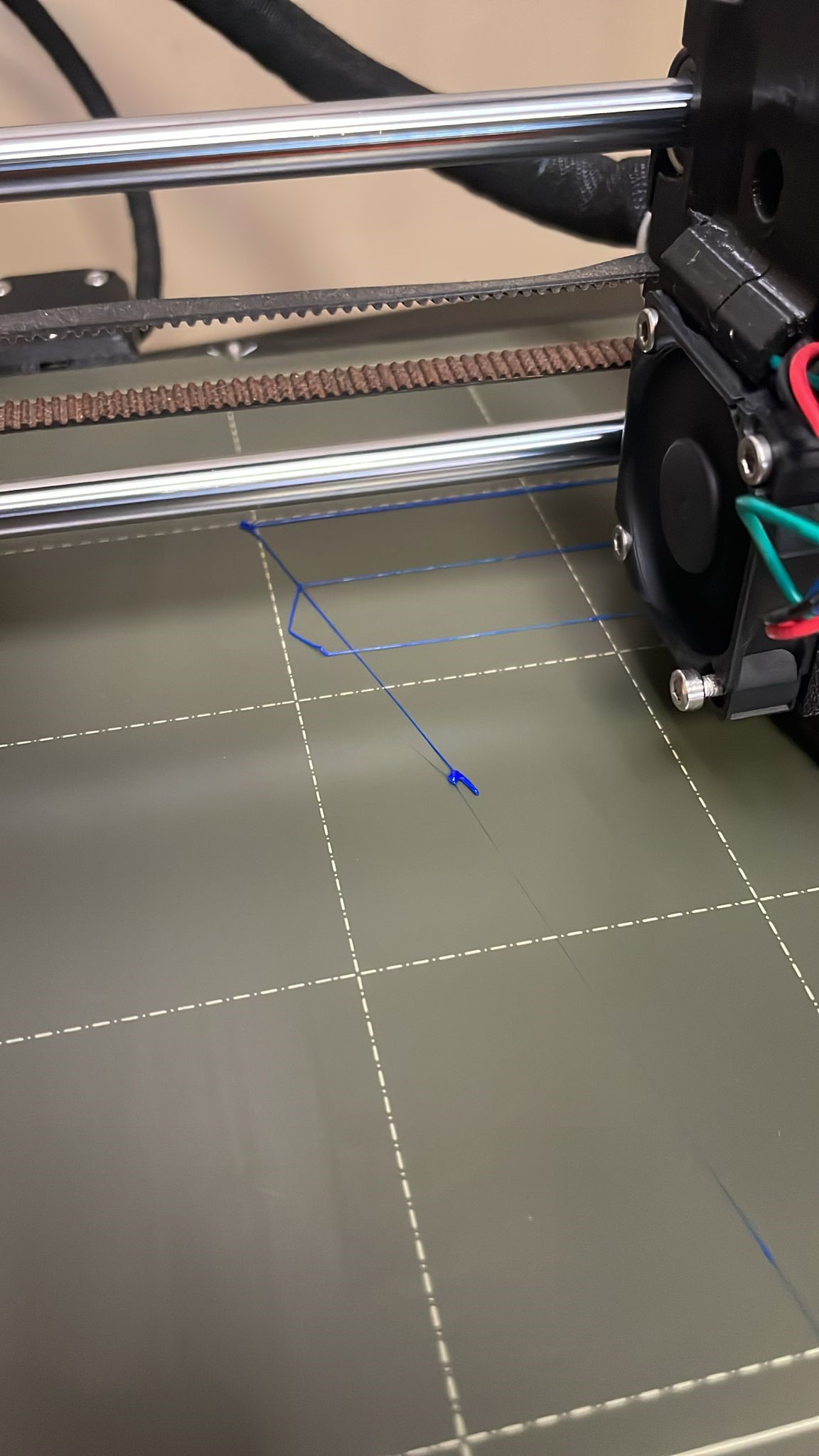

I had to change the extruder because it was completely messed up. I've just tried to print again and it looks horrible. What do I need to do to calibrate and make it work well? I did the wizard and one more calibrations from those available. But this is not looking good.

Nozzle looks way too high. Redo your first level calibration with anything other than the built in tiny square, e.g., https://www.printables.com/model/105404-calibration-strip-for-simple-live-zfirst-layer-cal
When you make changes to the extruder, more likely than not you've changed it's height so you need to get your live Z readjusted.

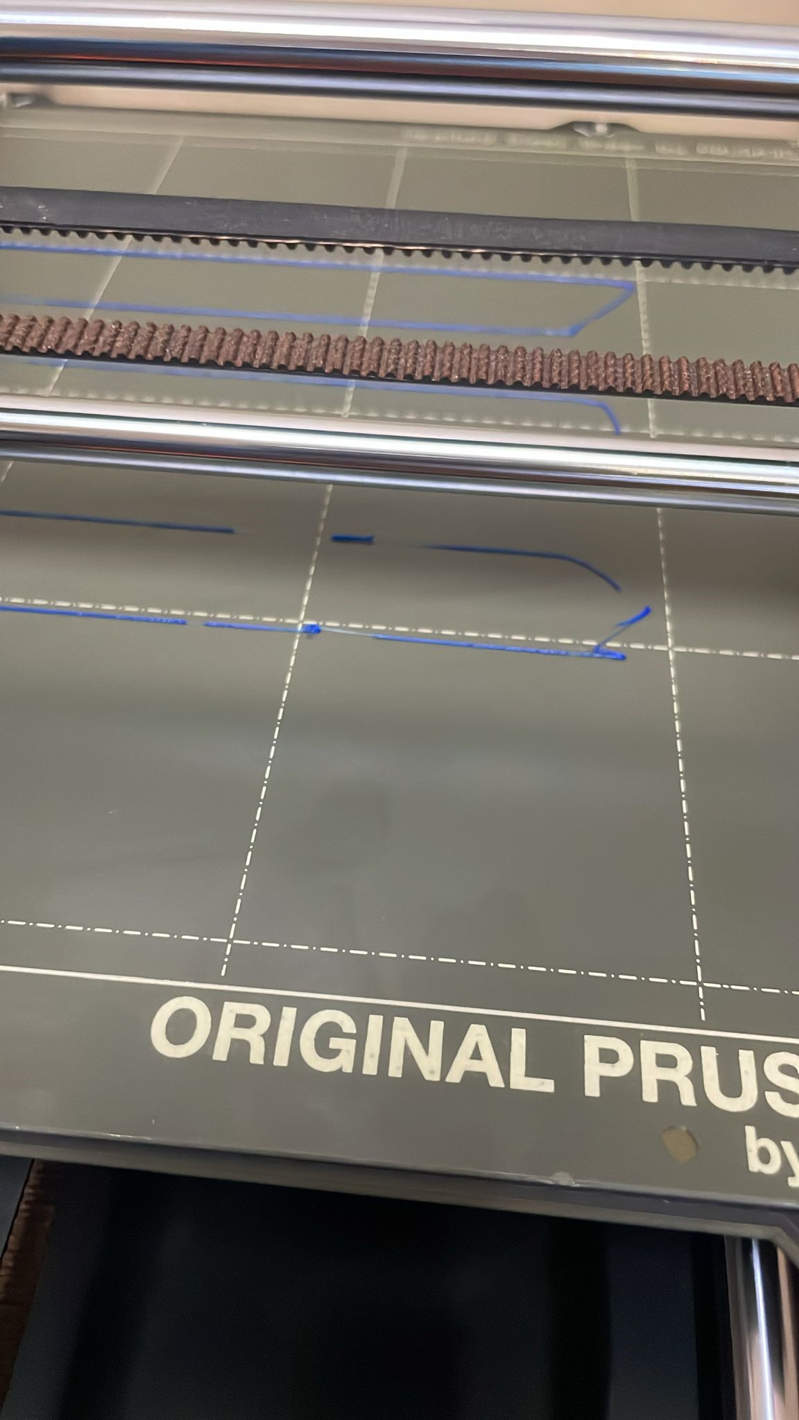

Thanks! This problem was solved 🙂 Now I have another one: the printing is not constant and I kinda see it's not smooth. How can I solve that? I attach a picture.

RE: Not printing well the tests
Still too high.
You were right, thanks! I didn't know it could go so low 🙂

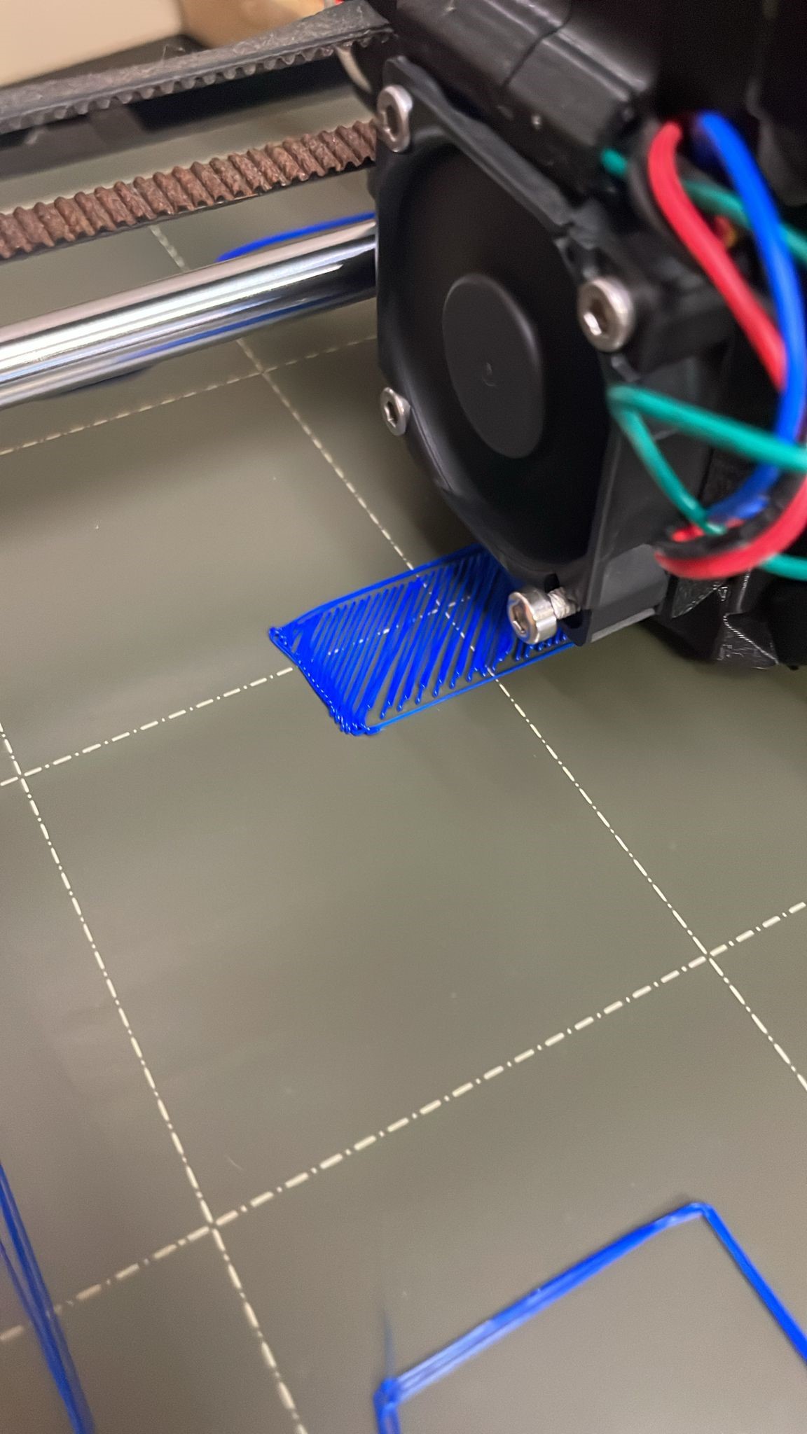

I'm having trouble calibrating my prusa mk3s+. After greasing the axles, tensioning the belt and calibrating the bed and the Z axis, it still causes these gaps in the central impression of the mesh.

Tweak your first layer 'Z' offset calibration until the centre square is correct, then follow the procedure on: https://help.prusa3d.com/article/bed-level-correction_2267
After trying this I solved the problem!!!
I just needed a little more patience 😀
