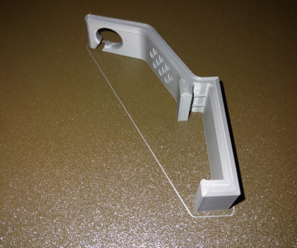

My problems are solved!
The problem with the display knob was a hardware problem, and changing the display was the solution.
My problems yesterday with first layer adhesion of PLA at this new textured plate had a quite simple solution. I brought down the speed to 60 mm/s. I read a lot of comments yesterday on how to proceed for first layer calibration, and speed was never mentioned.
Never a plate has been as proper, and I was thinking of doing ugly things to it, and was doubting about my build quality too. And after one entire day of testing and washing and creating large amounts of plastic waste I diminuished the speed, and printed my first print with PLA on this surface without any problem
The design is Prusa i3 MK3 Filament Guide REMIX by Solid_Alexei, it fits really well, but I didn't test its functionallity yet.
Regards Michael
