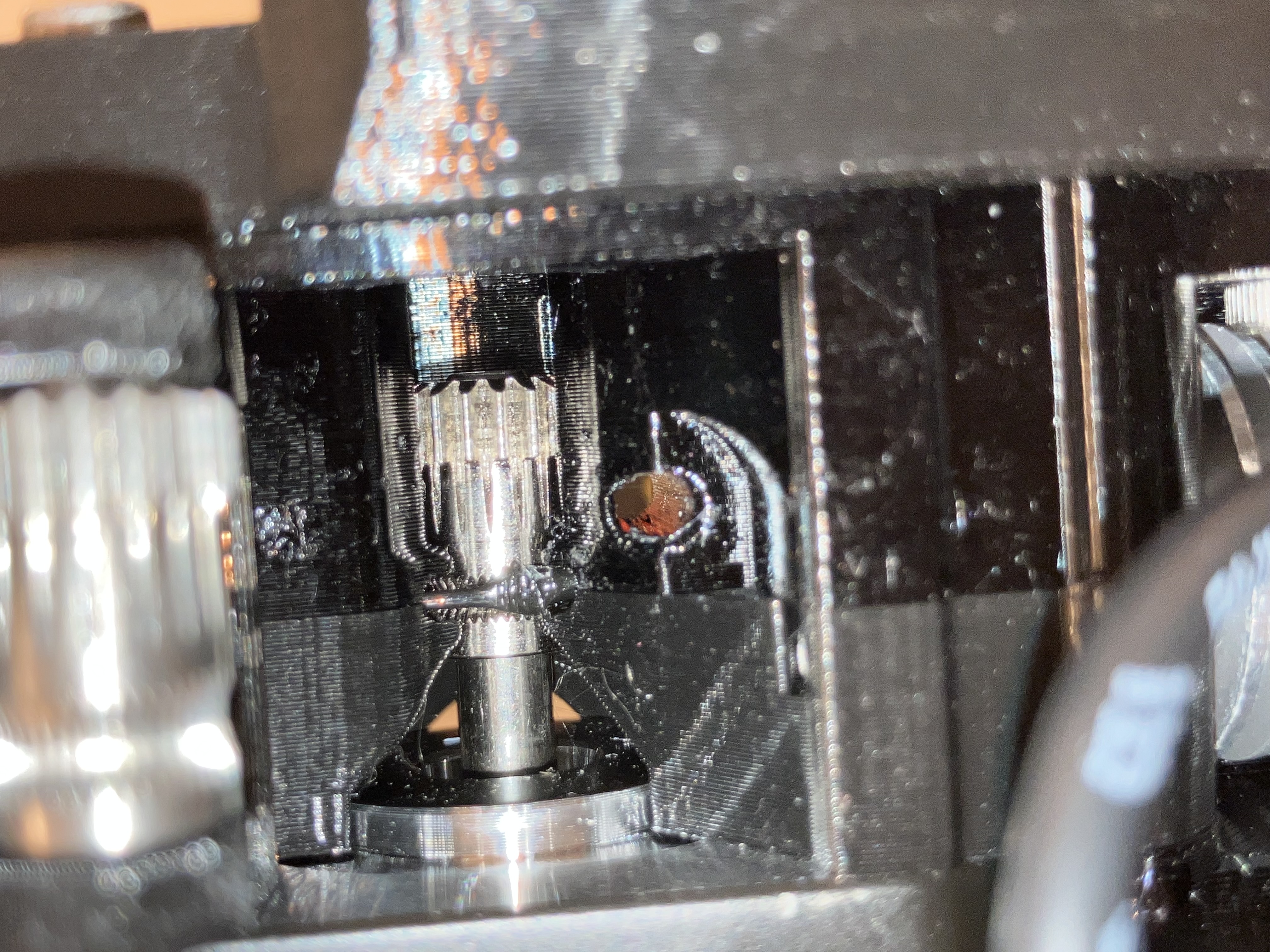

Hi all, I was gifted a MK3S+ and after assembly I have not been able to get a first layer print. I am able to pass self test, z calibration but as i get to my first layer test filament seems to be pulled in to the hotend but nothing comes out. The weird thing is when I load the filament it comes out but during the first layer calibration. I then have to unload and sometime disassemble to take out the filament. I have so far replaced the entire hotend, hotend fan, nozzle, pfte tube, the entire R6 hotend petg holder, check the extruder pulley and tightened and the end result in all cases is the PETG Prusement filament is not extruded and a jam occurs. Clicking occurs when the filament is loaded but i do tweek the idler at this point to try and find the right setting. I'm sure this is a common problem but I can't past this simple hurdle of the first layer 😪. I have a heat sink coming tomorrow to add to the extruder motor but really need some help and advice on what else i can try to the filament to simply extrude.

I’ve just disassembled again and found the pulley on extruder freely moving again. I thought I had tightened this up but perhaps not. If under enough pressure can this come loose?

Re-assembled and attempted a first layer design from Printables. Filament extruded to begin with then extruder motor started clicking so i began adjust the idler. Attempted to unload filament and the usual happened with a blockage. I really don't understand. When loading the filament it comes out great and expected but as soon i try first layer this happens.
The motor pulley didn't slip this time and I was able to extrude bits of the filament. I added a heatsink to the motor so don't think it transferring heat to the filament but really unsure. The hotend, heat beak, heat sink and nozzle are brand new and probably the 3rd or 4th set I've tried. I've taken them apart and the filament wasn't stuck in the hot end this time.
Posted : 15/09/2023 3:51 pm
See step 9 of: https://help.prusa3d.com/guide/5-e-axis-assembly_169235
The screw MUST face the flat on the motor shaft.

Thank you. When I disassembled the second time, I completed step 9 and did as it said and tightened. It has not moved since which is great news. I have just replaced the pfte tube. When I tried to manually slide some filament in there was a lot of resistance. I am just now trying the first layer again. I appreciate the reply.

Unfortunately another failure. Filament loaded ok, extruded but when the first layer process starts the clicking starts. I attempt to unload and I am able to a point when the jam hits the sensor. See pic. I’ll have to disassemble and see if I can see any other problems. Everything is new including the nozzle.

So, i took everything apart and replaced all parts. I realised no collet was installed which was i think causing some of the jamming and most likely caused the first jam. When everything was reassembled and calibrated I nearly made it to a full first layer! The filament was smoothly extruded but unfortunately after about 1 -2 minutes the amount of filament turns from a line into dots and the clicking on the motor starts. Same thing has happened now and when I attempted to remove the filament I experience jams again.
Seems the filament is experiencing resistance but when I disassemble there is no blockage just a jam from the pull. The filament seems to have warmed and thinned out so perhaps heat creep?
Anyone have an idea what could be causing the resistance? I used a new hotend, heat break and pfte tube. The collet helped massively but only so far.
The only thing left to replace is the print fan? If anyone has any other suggestions, I'd welcome them. I hope i don't have this issue when my MK4 arrives!

When clicking starts lightly grip the filament above the extruder - do you feel pulses?  If the axis is runing at a steady speed try adding a little extra push to the filament and the clicking should change.
This is almost certain to be an extruder idler pressure issue, it might be either too tight or too loose.  I would loosen it until definitely too loose then tighten it by steps until it grips nicely.
Your first layer 'Z' calibration is too high in the picture above.
